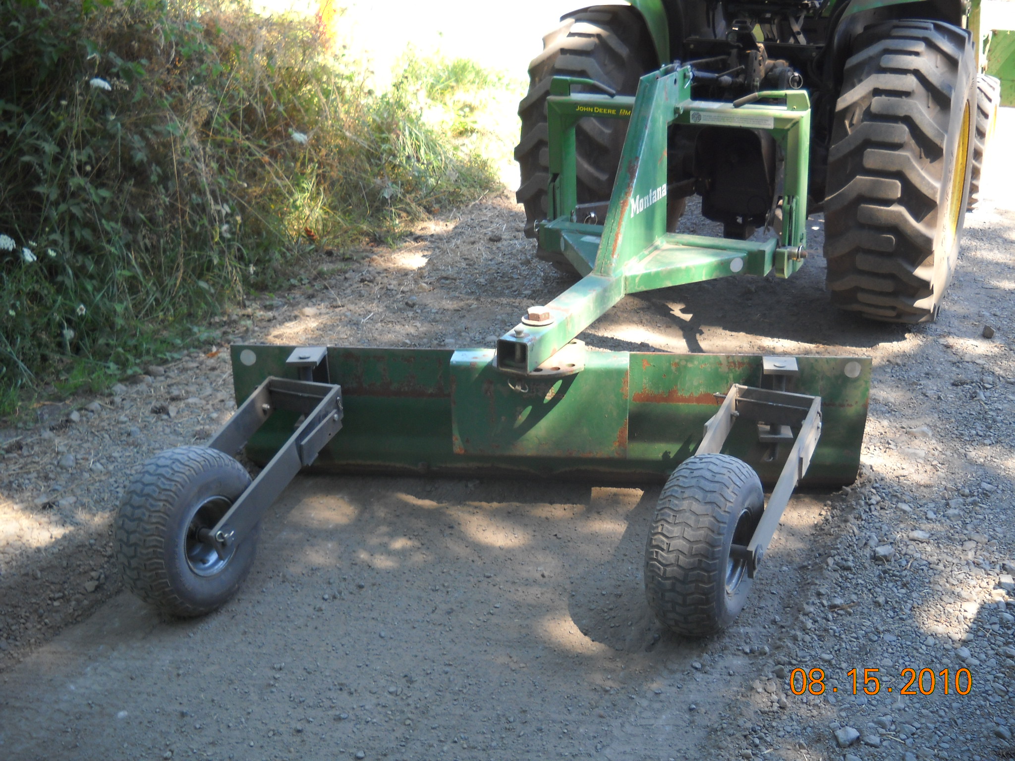

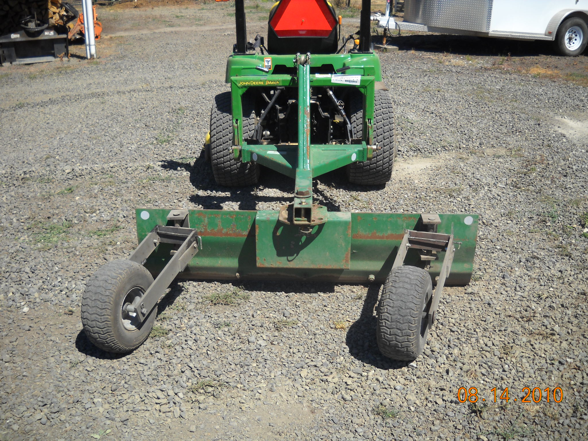

   / Newbie with 2320 Blade Question. #5
i have a 5 foot blade and i use it from my 19 hp yanmar 169d to a 44 hp JohnDeere 3720. I also have used it on a JohnDeere 2210 and it pulls it great. it is the ideal size for me. i also just recently added gauge wheels, huge difference on operation. :thumbsup:
