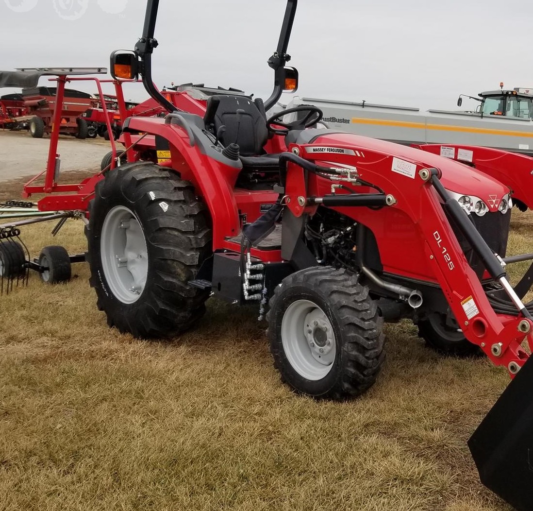

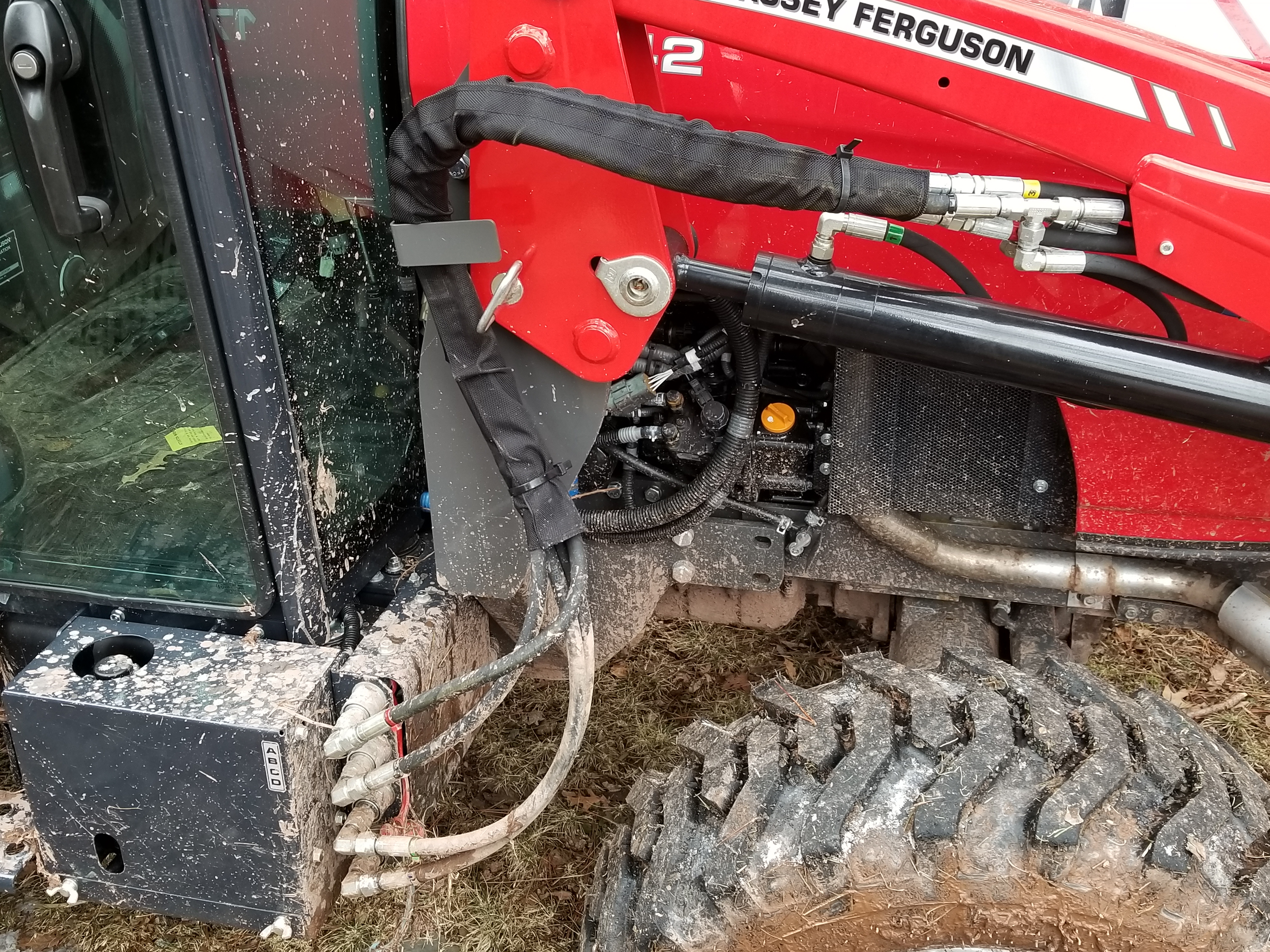

The hoses rub against the tire, especially when I cut the wheel hard. Are the length of these hoses set from the factory, or is this something the dealer fabricates? Any ideas how to get rid of the slack without actually shortening the hoses? Thanks

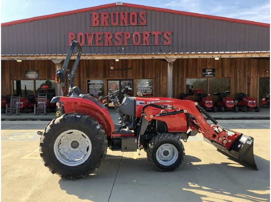

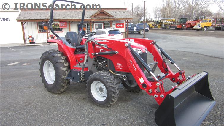

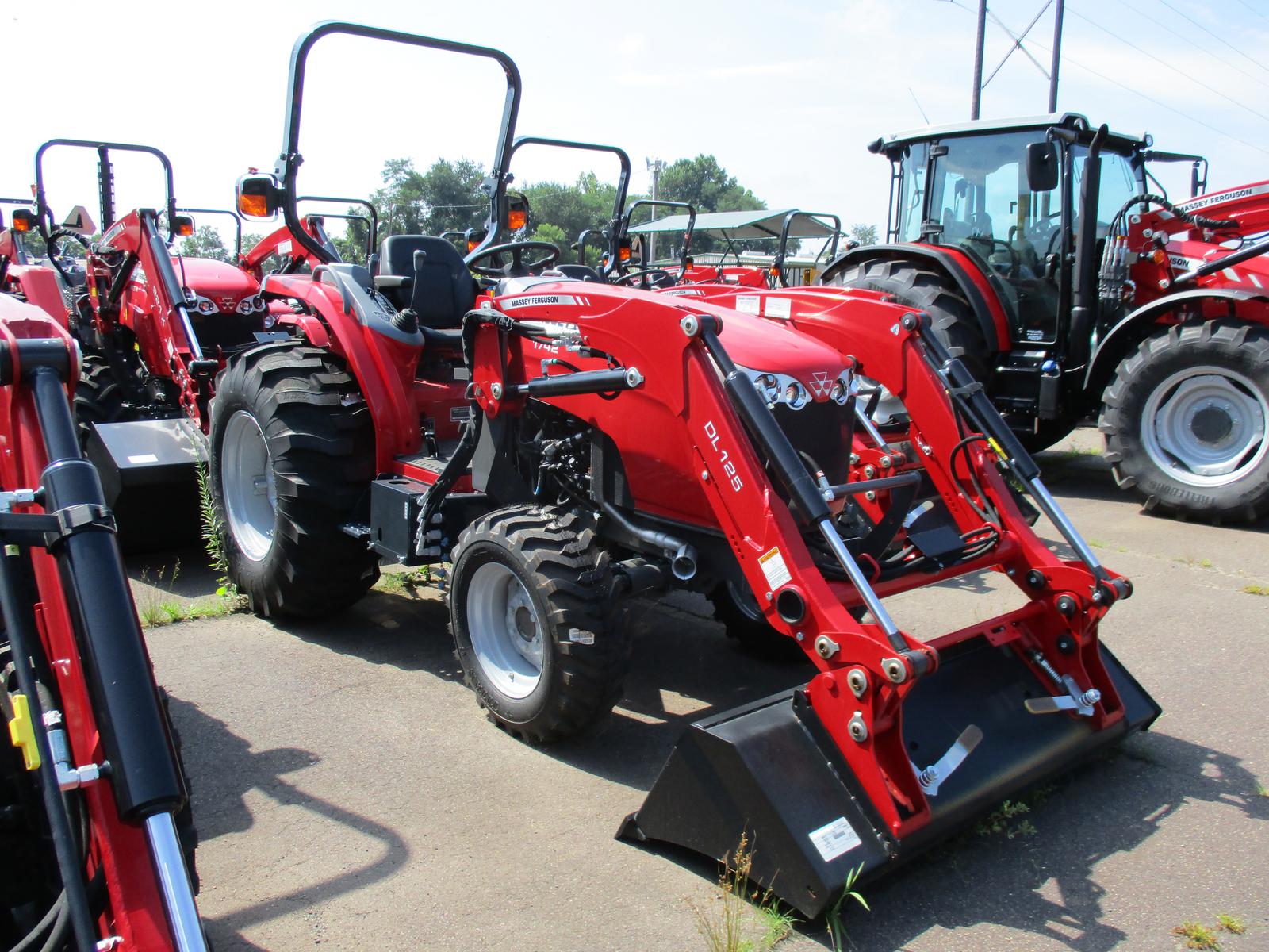

I think your hoses are routed wrong. See the photos below.
Bruce
   / Newbie What's Wrong With this Picture? #3
Just take the slack out of them pull them up so their looped above that grey bracket that's holding them.
   / Newbie What's Wrong With this Picture? #4
Might then need a couple strong zip ties to hold them up.
   / Newbie What's Wrong With this Picture? #5
pull them up and tie them to the arm of the loader,
   / Newbie What's Wrong With this Picture? #6
turn the fittings upward, then zip tie it to the gray "L" with a wide zip tie to hold in place and not dig into the hose.
Thanks Everyone Appreciate it
   / Newbie What's Wrong With this Picture? #8
IMHO - Code54 has the correct answer. Should end up looking like the far right picture in bcp's posting.
