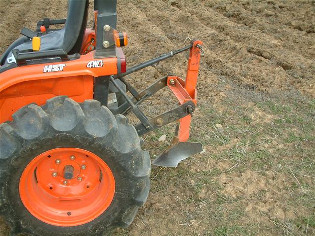

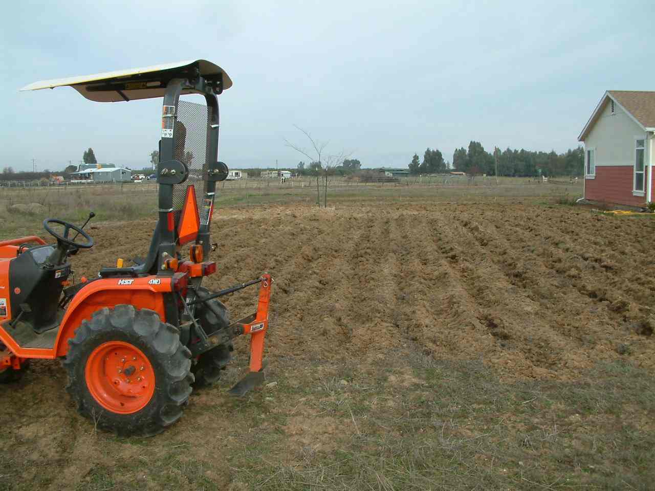

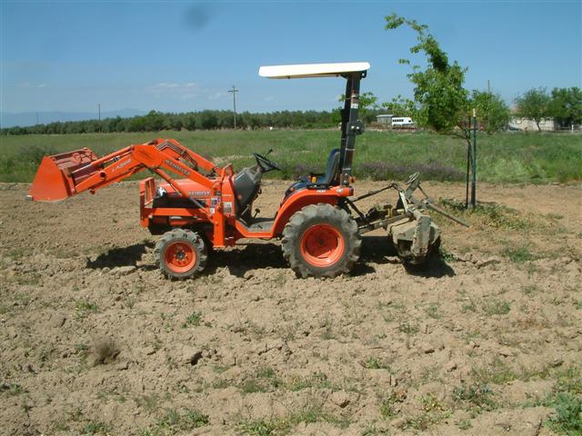

Yes, SCUTs are real tractors (pto, 3 point hitch, diesel engines). Either of those Kubota tractors will work well for you on 2 acres. My first tractor was a new 2005 Kubota B7510HST (21 hp engine, 17 hp pto, 4WD, power steering, hydrostatic tranny) with the LA302 FEL (4-ft wide bucket, about 800 lb lift) which worked fine for mowing and general work around my 10 acre place. Cost new: $12.6K plus tax.
It was too small for serious plowing, discing, etc on my 6-acre hayfield so I traded it in for a much larger 2008 Mahindra 5525 (55 hp engine, 45 hp pto, 2WD, power steering, gear tranny 8F/2R) with the ML250 FEL (6-ft wide bucket, 2950 lb lift to 10.5 ft height).
Those little Kubota tractors can handle a single 12 or 14 inch moldboard plow. I put in landscaping around my new house in 2006 using that little B7510HST, a middle buster plow and a 4-ft wide rototiller to prepare the ground for seeding. YOu could do the same with one of those Kubotas you mentioned.
Good luck.
