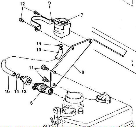

The second question I have relates to the plumbing of the thermostart device.
On my tractor there is a hose leading from the thehermostart to a small container/reservoir and then there is a hose connected to the other end of this container but that hose is loose (not connected to anything else). From the forum I have gleamed that Diesel is ignited by the thermostart. To what is the reservoir supposed to be connected?
Any advice will be greatly appreciated.

The thermostart reservoir has to be filled manually on the YM240.

Here are some illustrations showing how it was originally set up on YM240. The reservoir has no inlet hose - you fill it by opening the cap and pouring in diesel.
Thermostart Diagram (in Options page, YM240 manual)
http://www.tractorbynet.com/forums/attachment.php?attachmentid=37146&d=1114015731
Shows location of the thermostart under the air cleaner, and its fuel reservoir (upper left)
http://www.tractorbynet.com/forums/attachment.php?attachmentid=47028&d=1131745016
It sounds like yours has been updated to the reservoir used on later Yanmars. On those, the excess-fuel line from the top of the injectors goes to a second connector on the bottom of the thermostart reservoir, and also goes to the tiny return-fuel connector at the top of the main diesel tank.

Thanks to the info provided here I was able to re-plumb the TS and it is now working fine. With the climate we have in South-Africa it wil probably never be necessary to use but that is not the point when fixing up/re-buiding/restoring anything.
