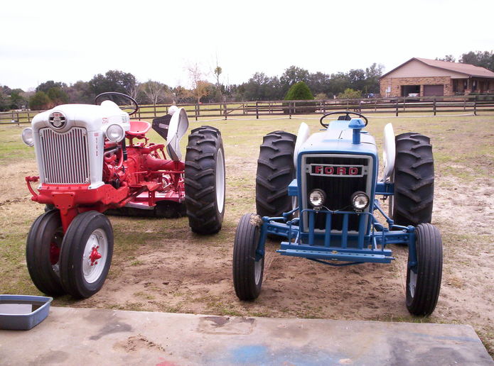

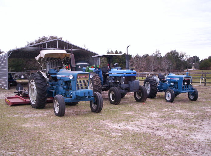

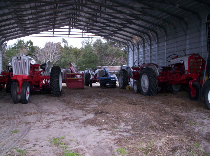

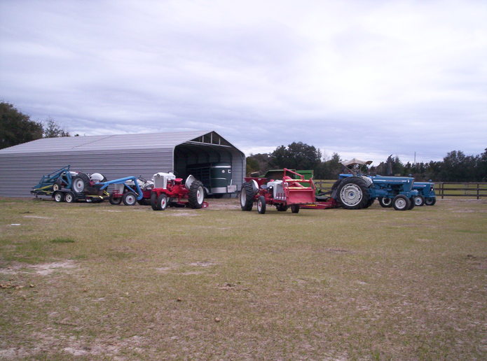

it's a disease.. and pretty much gets worse.. you start with a single tractor and maybee an implement or two.. then it takes hold.. and eventually you are left with something like this ( and this anit near all of them either. i got 2 more sheds full...) :

Nice tractor collection!:thumbsup:
