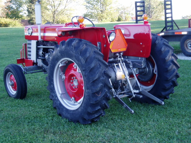

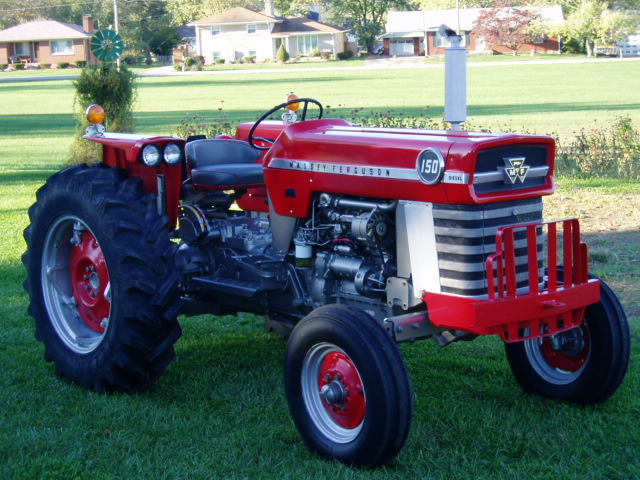

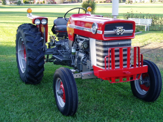

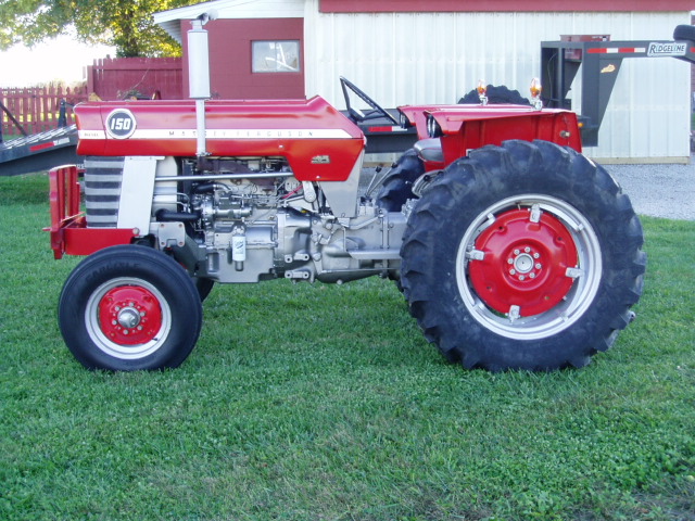

I have all sorts of Perkins manuals up to and including 1984 serial #'s. Not sure if I can help, but willing to try. The Perkins AD3-152 is almost a family member with me! Had this'n since new in '71!
