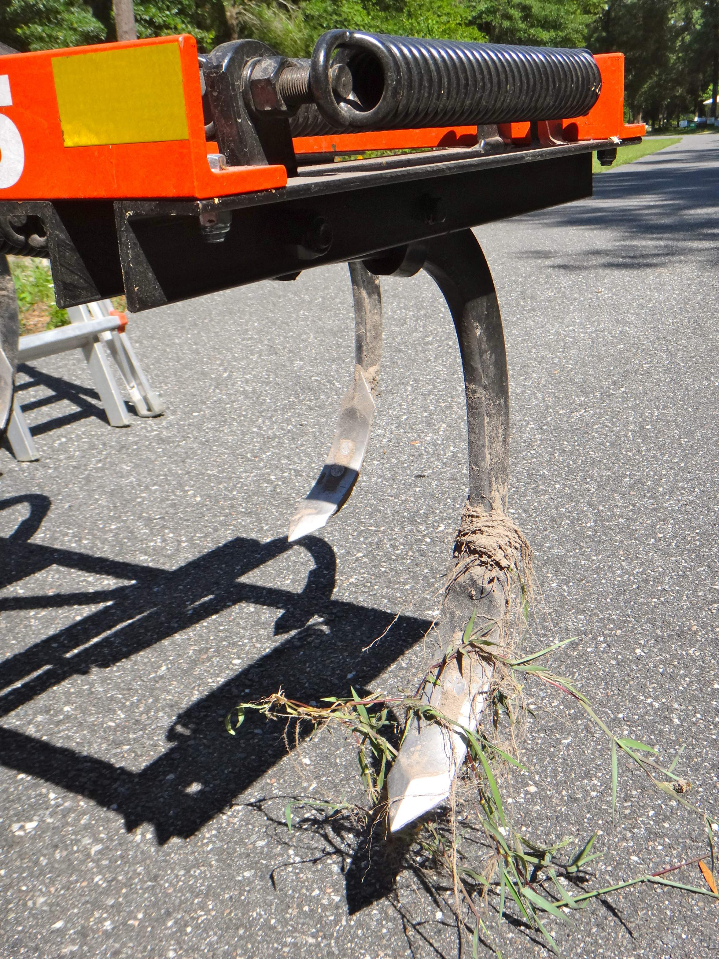

I have a coil-spring protected Dirt Dog (brand) All Purpose Plow. It is pretty much your concept. The APP, while robust enough to pull through Bahia Pasture Grass growing in sandy-loam soil in Florida, may be too delicate for clay in Texas.
I only pull it through Bahia pasture when the soil moisture is ample but I go at least 10" deep.
Review + pictures here: https://www.tractorbynet.com/forums/attachments/339095-dirt-dog-all-purpose-plow.html?highlight=
