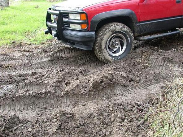

Gamemaster,
Sorry about the truck idea, didn't realize your trail was so wooded. Here's a picture of what I was talking about using the Blazer. Mine is an old one too, though. No trees...
Anyway, use the boxblade and tilt the heck out of it and scrape in that gutter. The roots should get cut too if they are not too big. Besides, you don't have to go too deep to divert seepage runoff. It'll follow the path of least resistance.
