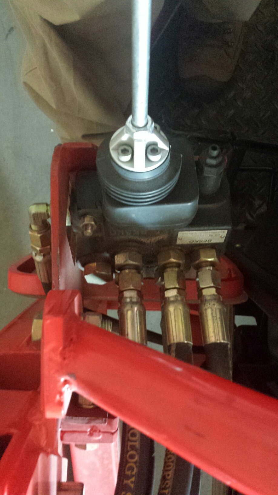

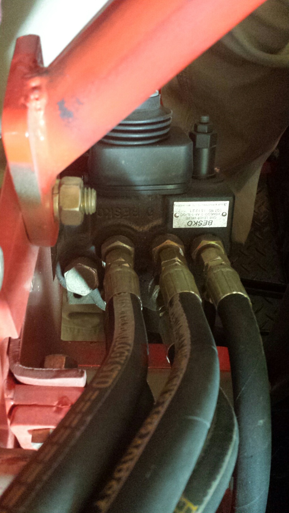

I'm a tractor and hydraulics novice and need help. I have a Yanmar FX42 that I need to add a rear remote to in order to connect this log splitter:
logsplittersdirect.com/Images/Boss-Industrial-3PT16T21-Log-Splitter/i50736.html
I contacted Prince Manufacturing, who recommended the following valve, but suggested I verify it's applicability with someone more familiar with my tractor.
northerntool.com/shop/tools/product_200311693_200311693?isSearch=20112
Is this an appropriate valve? Anyone have better recommendations?
Thanks in advance for any and all advice.

Cheapest fix is to use one of your front remotes. Just plug it in and toggle the joystick. No need to even take the loader off.
   / Newbie needs advice for a rear-remote for a Yanmar FX42.
Sorry for my ignorance, but how would that work? Plug it in where? If I toggle the joystick it moves the FEL. What am I missing?? Here's my FEL controller:
