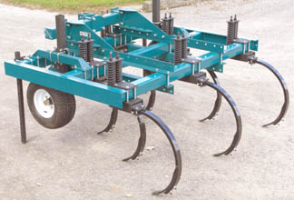

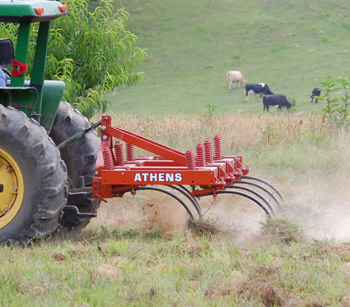

Use a Chisel Plow first, a type of conservation plow which will penetrate 10", then Disc Harrow if necessary to reduce furrows. Chisel Plow will preserve some of the grass you have.
Seed with what seems best. To me, grass diversity would be insurance. I can believe modern hybrid pasture grass would be more productive with regular fertilization but it would take some convincing for me to believe anything would outsurvive prairie grass truly native to your area.
HAVE YOUR SOIL TESTED AND AMEND BEFORE SEEDING.
Chisel Plows are common in Texas. Photos #1 + #2
Chisiel Plows generally require north of 60-hp tractors + 4-WD to pull them.
