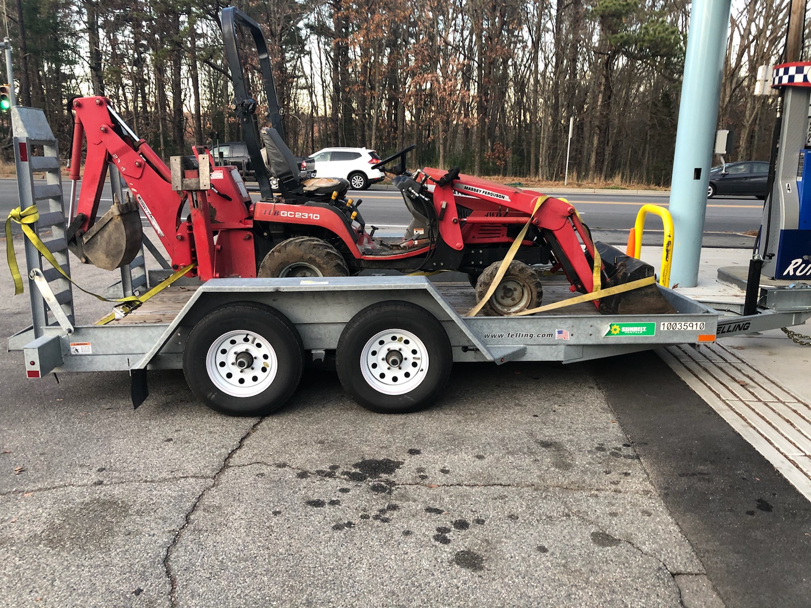

I'm new to the forum and tractors/anything hydraulic in general. I have some land I have started to develop with about 600' of driveway to build I ended up searching for a tractor with backhoe attachment and came across this GC2310 last weekend for a good price. It not the prettiest tractor since it was stored outside (seats ripped, faded paint, and busted headlight) but everything works well and it seems to have all maintenance kept up on it over the years. I bought it down in CT and hauled it up to my land in Maine and started using it last weekend. After driving around with the parking brake on and wondering why it was way slower than when i test drove it i got into ripping some stumps and refilling the holes. Its amazing what this machine can do I lucked out that i didn't have to chop any huge trees when clearing my driveway and there are only a handful of 8-10" stumps to rip. My original intention was to just sell it once i have my driveway built and area for the house cleared but now I'm thinking I want to hold onto it and use it to clear snow from my driveway once my home is built.

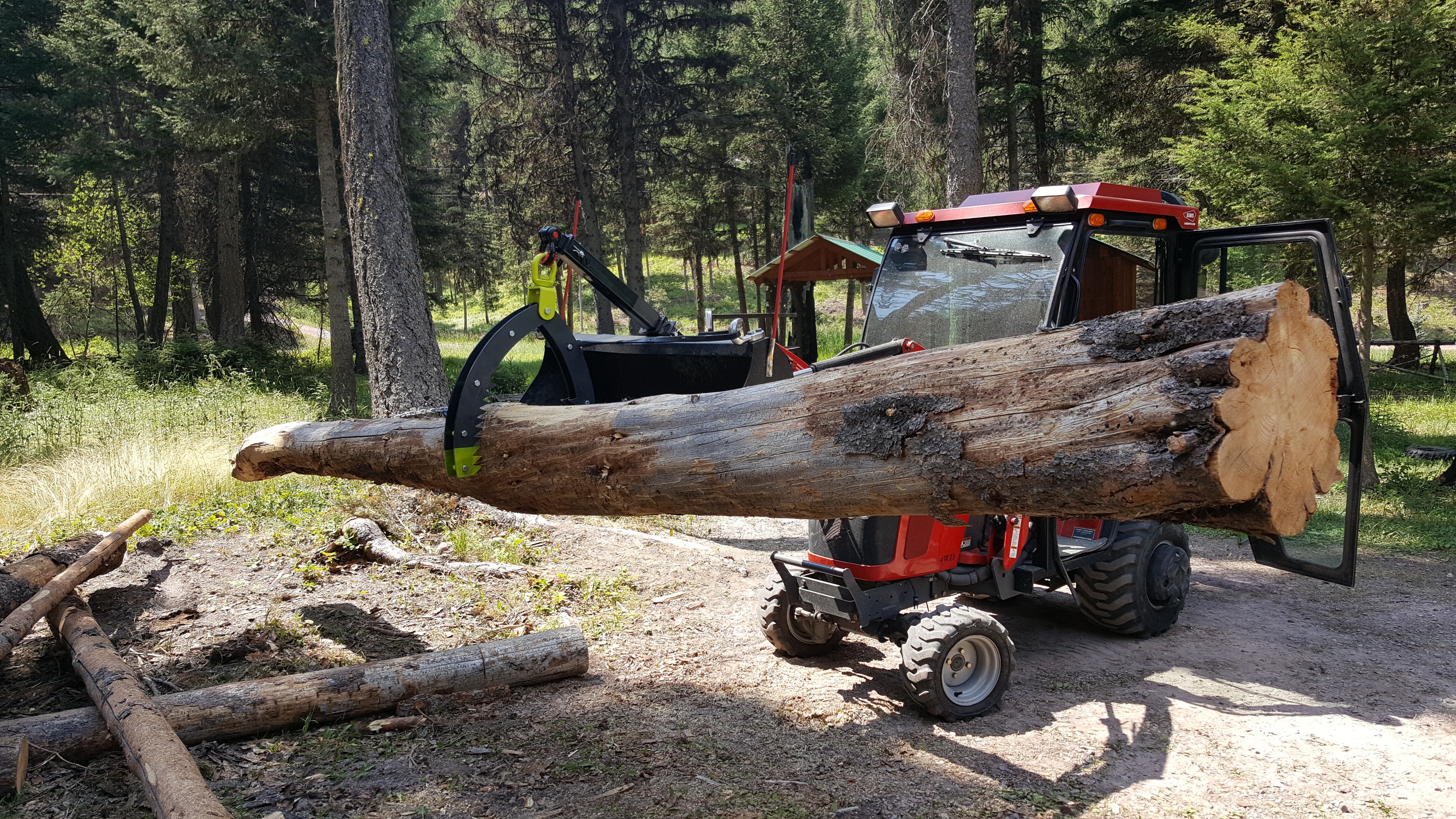

I just bolted on the top of the bucket a HF 2" receiver hitch, 35 lb. Step Bumper Receiver , and picking up 18' logs this summer with my poor man's grapple, aka JAWS, I did not notice any problems regarding any bucket deflection (with an 18" extension piece that adds a lot more force on the bolted receiver).
