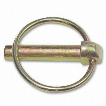

Received my new DS3510 over the weekend and promptly put it to use. I also purchased a County Line boom pole for help with skidding logs. My question is, what hardware is required to mount this effectively? Am I assuming a 7/16" lynch pin for the bottom clevis' is correct? Given the spacing with the plates for the top mount, I need a longer clevis, but am unsure of the width. Would something like this work?

I am confused by your terminology.
Here are pictures of a clevis, a lynch pin and a top link pin.
The pin in your link from Northern Tool is the wrong diameter, it should be 3/4".
The lynch pin goes in the hole in the top link pin. You need to match the lynch pin diameter to the hole diameter.

Forgot to update this yesterday, but I did find the correct diameters. As you might imagine, I was not using the greatest search terms with Google, so it compounded my confusion. 3/4" upper link, 7/8" lower link. You are also correct about my terminology. This whole tractor thing is like riding a bike for the first time. It's taking me a bit to figure out the proper language and etiquette :0 Thanks for the response.
