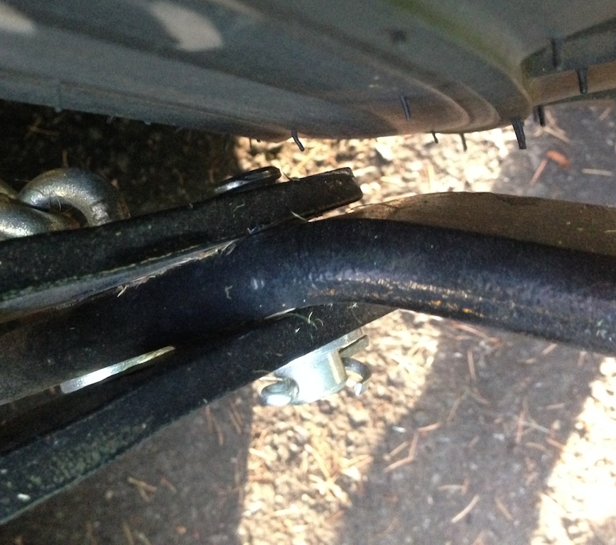

I just picked up my 2032R with RC2060 already attached by dealer.
I'm concerned by how close the draft links are to the inside of the tire. One side is nearly touching and the other is maybe a 1/2 in off (see photo of the side with more clearance) When mowing the closer side look like it was touching when angled on an incline.
Should they be this close?
I can see adjustability with the turnbuckles but am unsure how much lateral movement should be left to allow for uneven terrain.
Is the 5ft cutter just a tight fit with this frame?
Thanks Tim
   / Newbie help with RC 2060 set up #2
Tim, make sure you wheels are in the wide position, it will help a little.
I believe if the valve stems are facing outward, the wheels are in the
narrow position. these mowers do seem tight on this tractor, i don't remember
this being an issue with 2520/2720 tractors, yet i believed these new 2R tractors
to be similar.
Thanks I'm going to try a wheel swap tonight and think about an iMatch
I don't have my tools with me so I got the iMatch which fixed the clearance issues. I'll probably switch the tires at when I can. Thanks for the help
