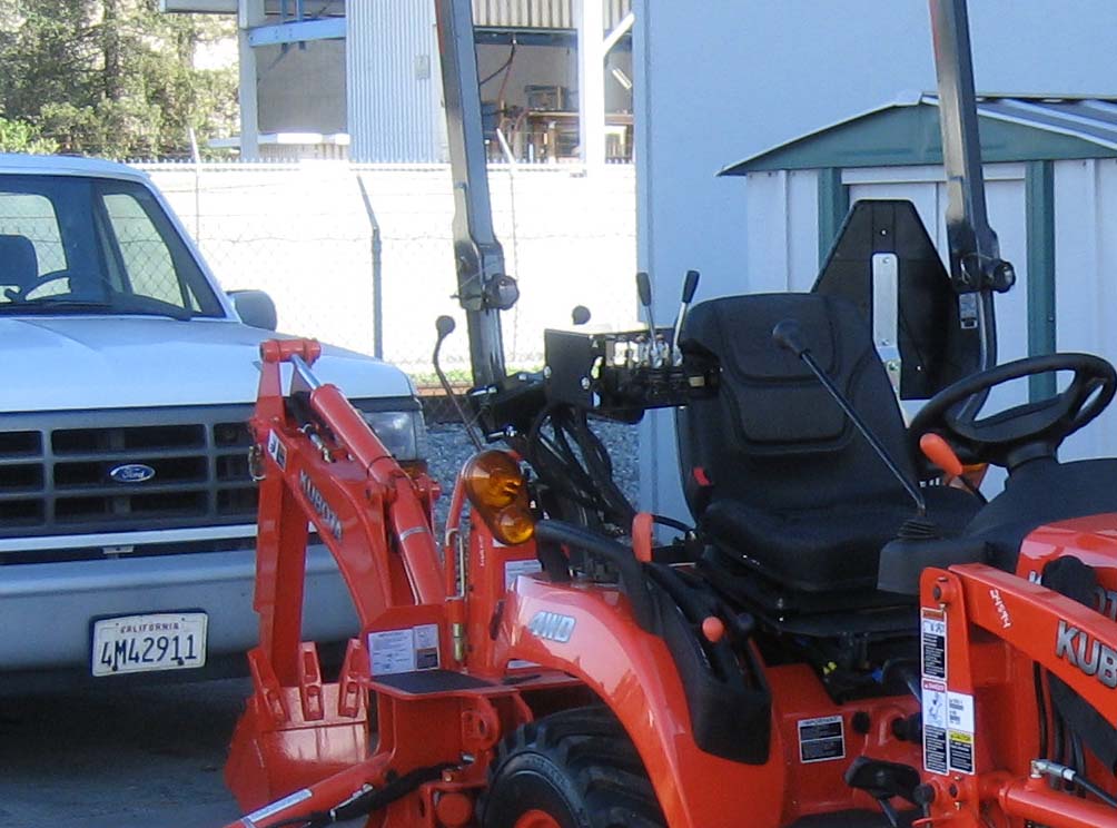

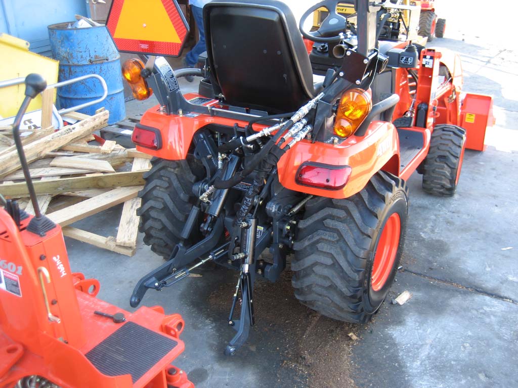

I've got the same Woods GBC48 blade and also like it. I've got a hydraulic tilt and top link setup that really gets you spoiled as you can adjust angle of attack or tilt from the seat. I also did a bunch of landscape rake work this weekend with our 60" rake and the top link adjustment was very useful.

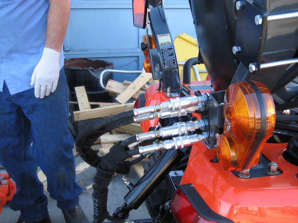

How complex/expensive was it to add hydraulic tilt. Can you use an existing control?
Have any photos?

Here's the Gearmore remote top-and-tilt kit for my BX24. Cost was around $1400 installed at the time I bought the tractor if I recall correctly.
Valve setup could be removed, but I leave it there even when the backhoe is on. Plumbs into the backhoe power and return lines when the hoe is off.
