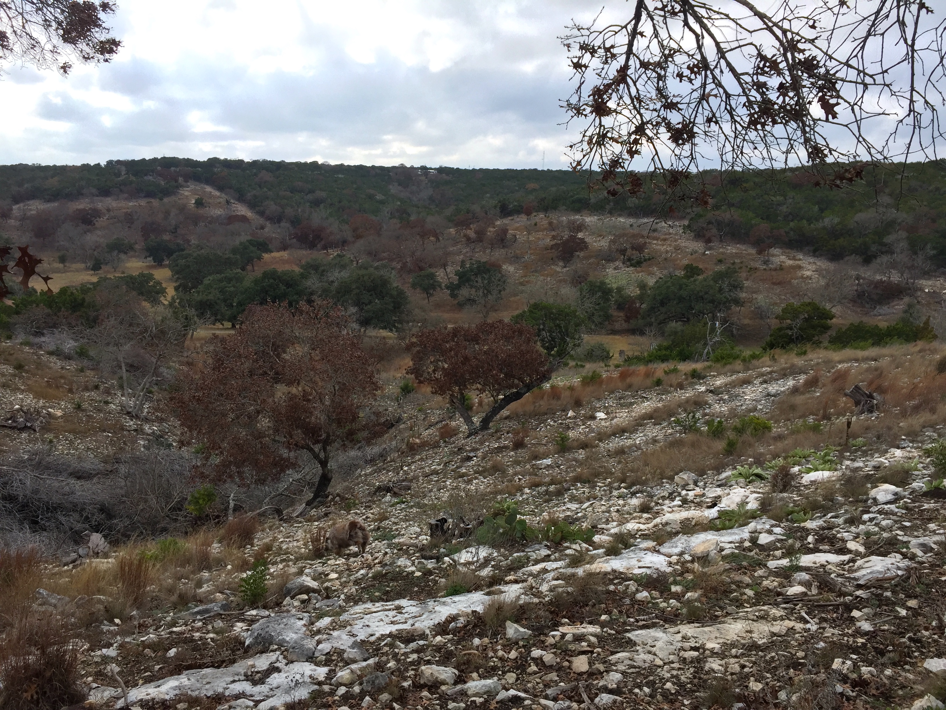

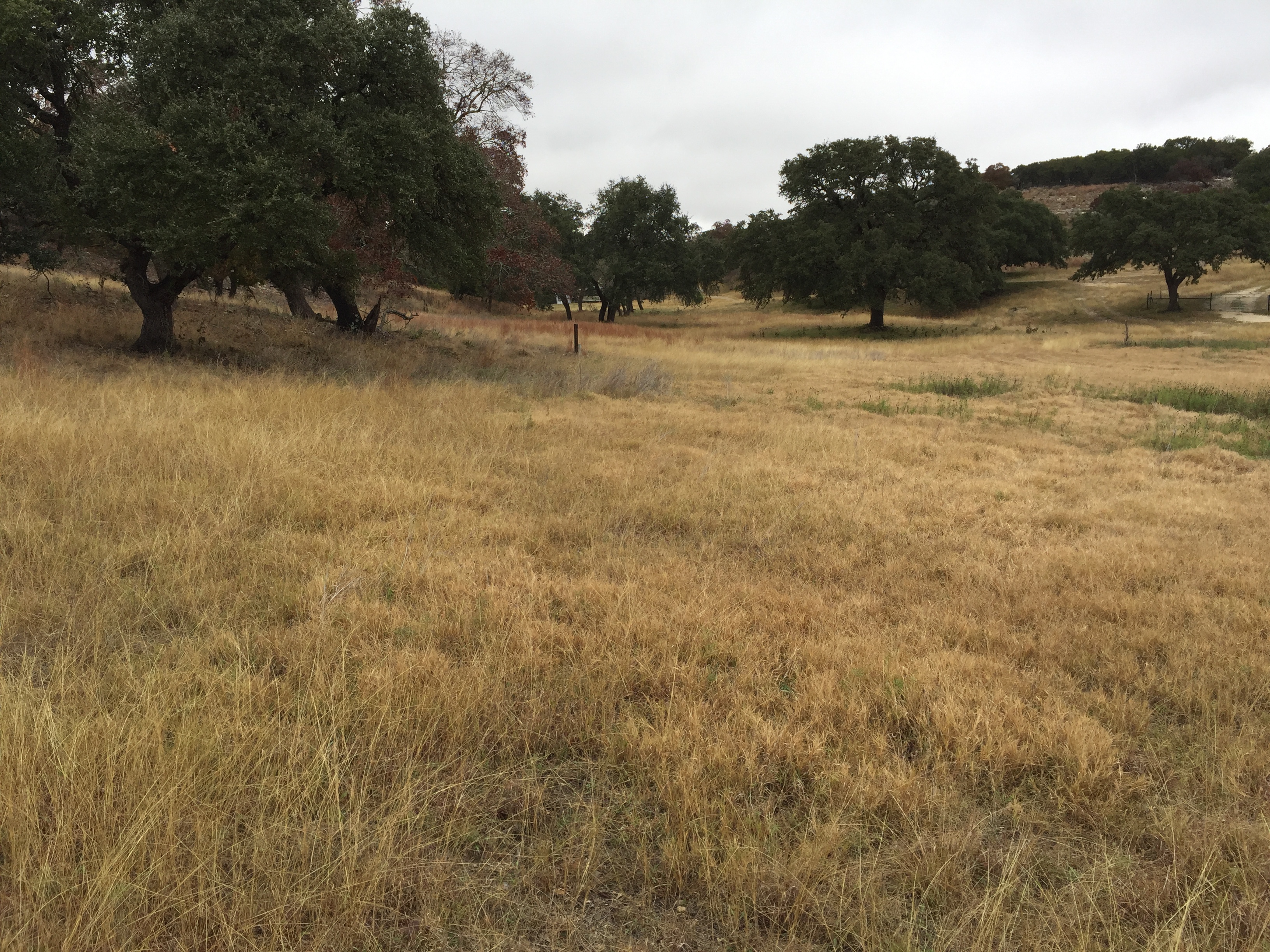

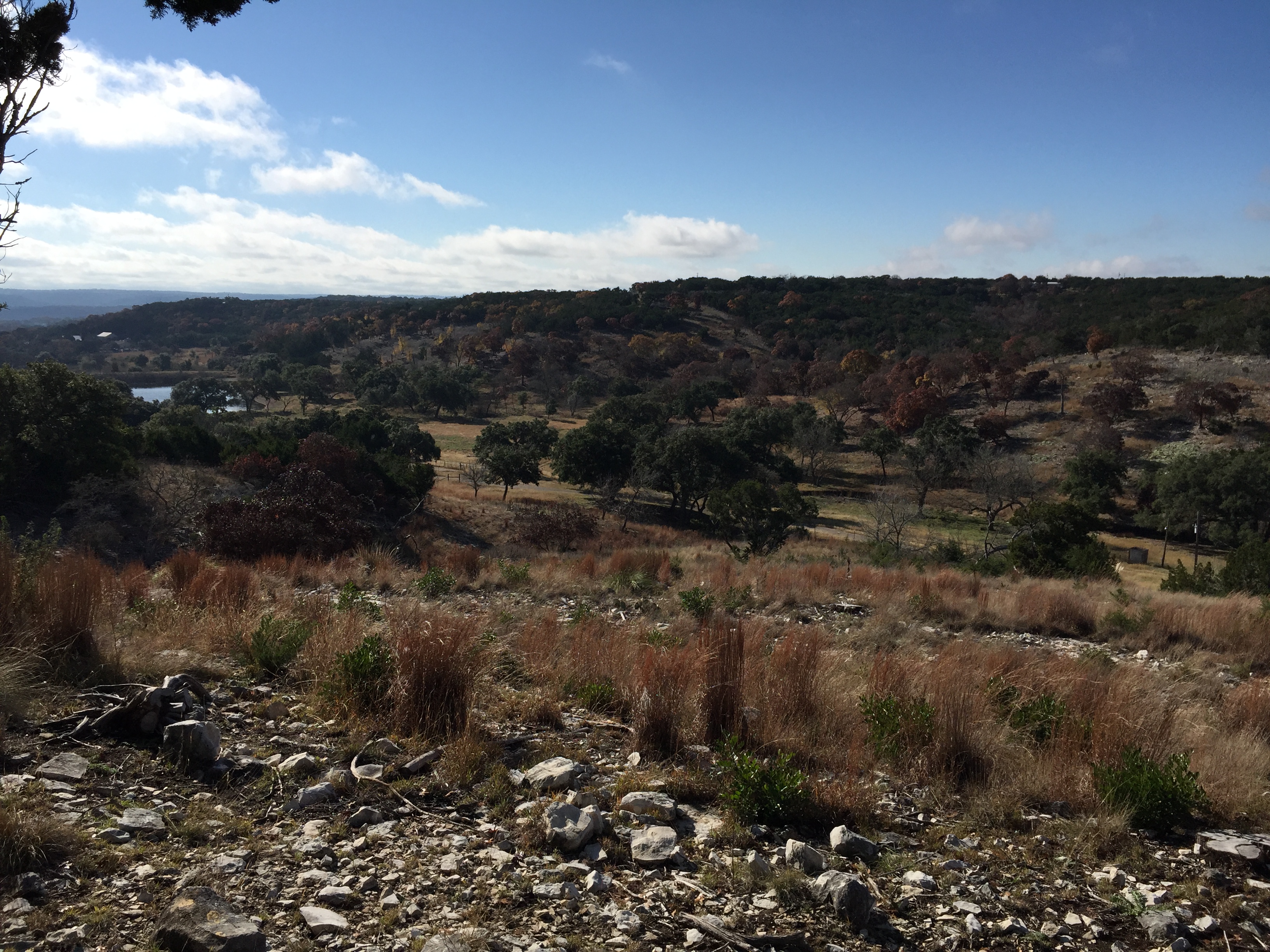

We just moved back to Texas and bought 20 acres with house in the hill country. The property is very hilly, very rocky, but has grass in the valley. We imagine doing a lot of things on the property in the future, but our immediate plans are shredding, rock moving, cutting and moving a lot of deadfall and barn building (30x50 w/ 12 foot lean to).

I have about 5-7 acres of grass that will need to be cut, so I'll need a shredder. The land was cleared of all the cedar but there is a lot of piles of deafall that will be moved and cut-up. As you can see in the pics, I'll be forever picking up and moving rock so a FEL is mandatory as well as forks for unloading trucks. I'll also be building a barn, so I'm counting on the FEL for a lot of lifting. In the future I can see us (wife) having some animals (cows, chickens, goats). I also have about 1000' of fence that needs to be run, but because of the rocky soil, I'll probably let someone with the right equipment to dig holes. The driveway is paved so no maintenance issues there, but I can see some work that a box blade would come in handy. I'm sure there's more, but that's what I have right now.

Welcome to TBN, Blicker. We have family with property similar to yours near Fredericksburg, and I've thought it is indeed rugged, rocky terrain that would be hard on equipment. It would depend on how much ground work you'll need to do. Moving or clearing rocks is hard on equipment, for example, even if you've got the right machinery for the job. And levelling or grading can bring your equipment into contact with underground boulders and ledge in a most unfriendly way. If that's what you expect, I'd suggest you try to find something built for severe duty... more than the typical "compact utility tractor". For example, you might consider starting out with a decent used dozer, skidsteer or excavator to get through all that heavy work initially and then switching over to a good chore tractor for maintaining the place. If you must be a "one and done" purchaser, I'd be looking at an MFWD (i.e. 4WD), utility type tractor instead of a compact, to gain ground clearance, heavier chassis and larger tires. Your budget may put a limit on what you'll be able to find in a utility tractor. Best of luck with your plans. That's some beautiful property you have!
