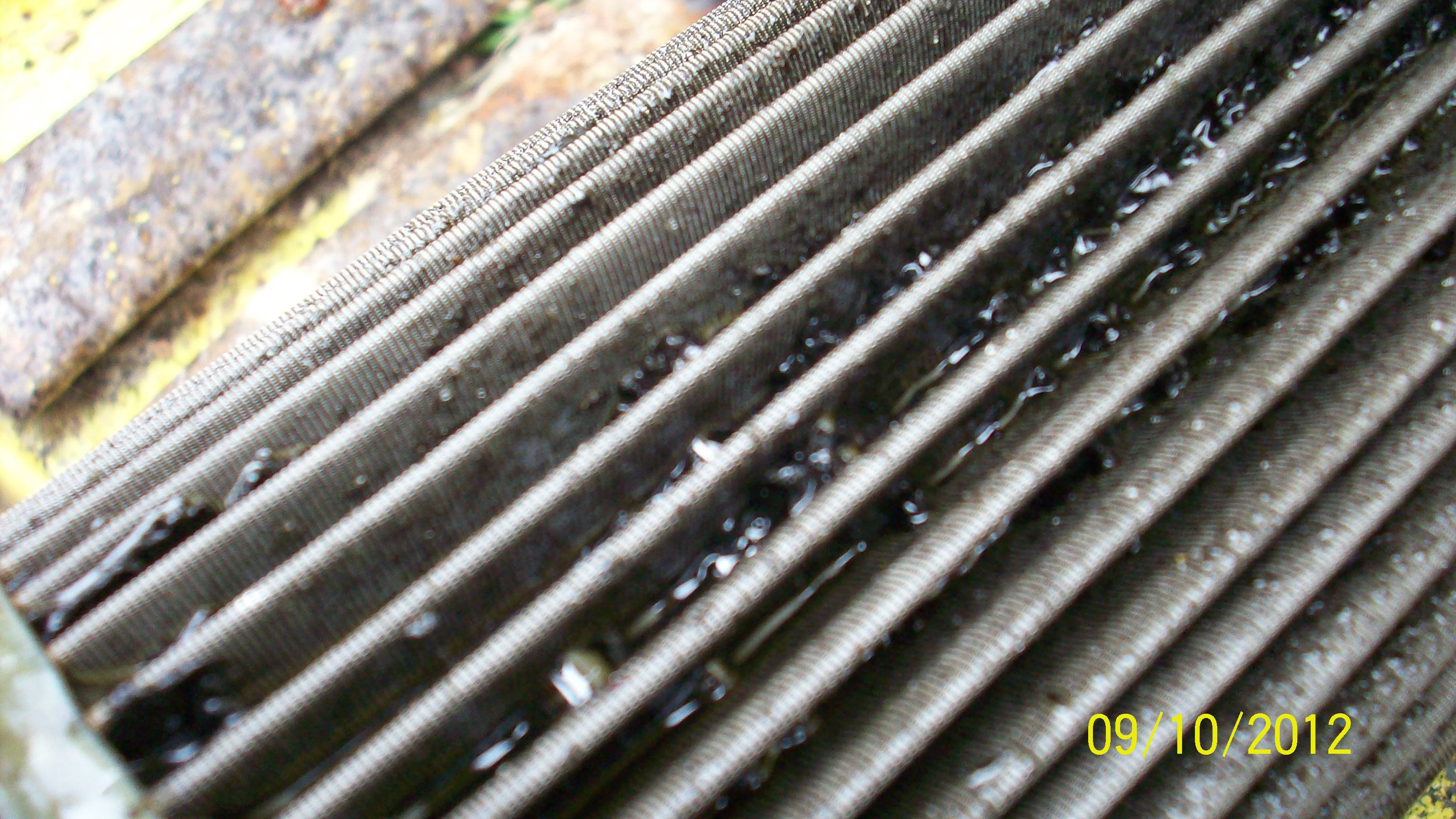

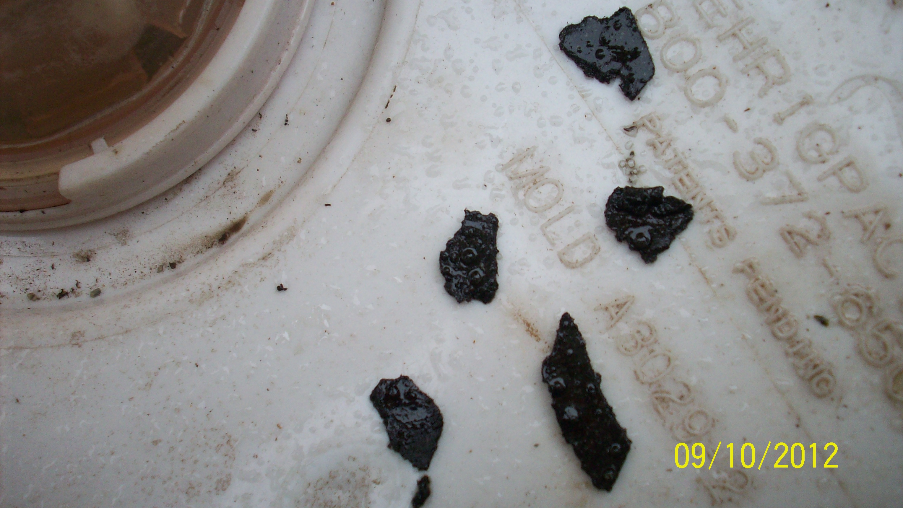

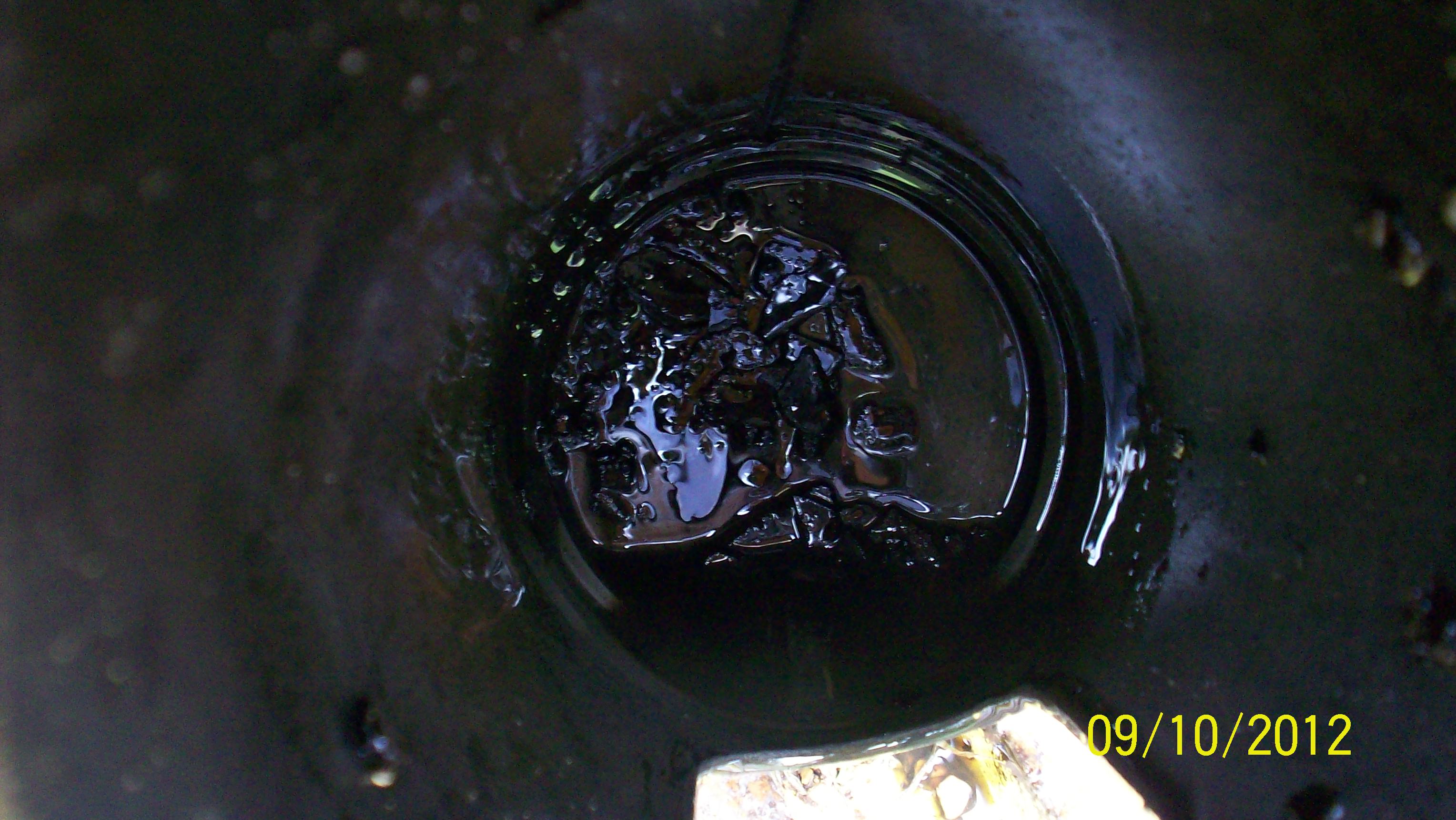

Thanks for the help. Removed the rear pan and got the screen out of trans, it is full of little pieces of material almost like a gasket, Could this be a trans band and what do I do next. rebuilt the trans or buy a used one? any ideas as to where and how I look for one/ Thank you again.

To clarify I have a d31-e20 not d20. Anyway did you ever get your shop manual? The screen was covered with the material? This it not unusual to find material in you filter / screen. What was the quantity and sizes of material. What condition was the oil in? The material could be brake lining or clutch facing? It may not be enough to matter at this point depending on how old the oil is. Could you describe your controls. Pilot / joystick or all levers and foot pedals? Brakes need to be adjusted correctly either way.
   / NEWBEE komatsu d31s-16 changing the hydro shift filter and fluid
000_0010.jpg000_0010.jpgthe material is maybe 1/2 inch and 3/8 inch wide hard like an old gasket, the oil is clean and the filter does not look too bad. I took some pictures and will try to include them. I have brake pedals for steering and the man I bought this from just spent 2-3 thousand on a brake band repair at a dealer. It was his fathers and he passed away. It hardly takes any foot presure to steer this. I have a 3 speed fwd and reverse joystick.

Sounds more like pump or control valve issue rather than clutch packs. Probably 5 clutch packs, 1 for each speed and 1 for fwd and one for reverse. Pressure to them would be by a control valve managed by linkage from your levers. might have a modulating valve that controls pressure surges when starting/shifting. I do not know if you have a inching pedal for that model. It could also be controlling pressure to the clutch packs. The whoshing noise sounds like a suction issue. Can you identify the transmission pump. probably mounted behind or on the side of the trans housing behind the damper engine drive. It would be great to find the operating pressures and check the pump output. Have you refilled it after cleaning the screen and checked operation. I would lean toward pump pressure rather than clutch pack since it would be unusual for all of them to go at once. Assuming this drove proper when you got it. You might try posting again in the construction forum as there are probably more views there than here.

Thank you for the info. Where is the construction forum? Do you think the pieces in the screen are from the pump and should I even worry about them? I have a fellow bringing a bore scope so we can see inside the trans and maybe see what is going on. If I clean the screen and refill it I could check the pressure and this might show me the problem if we cannot see anything with the camera setup. I will keep you updated.
