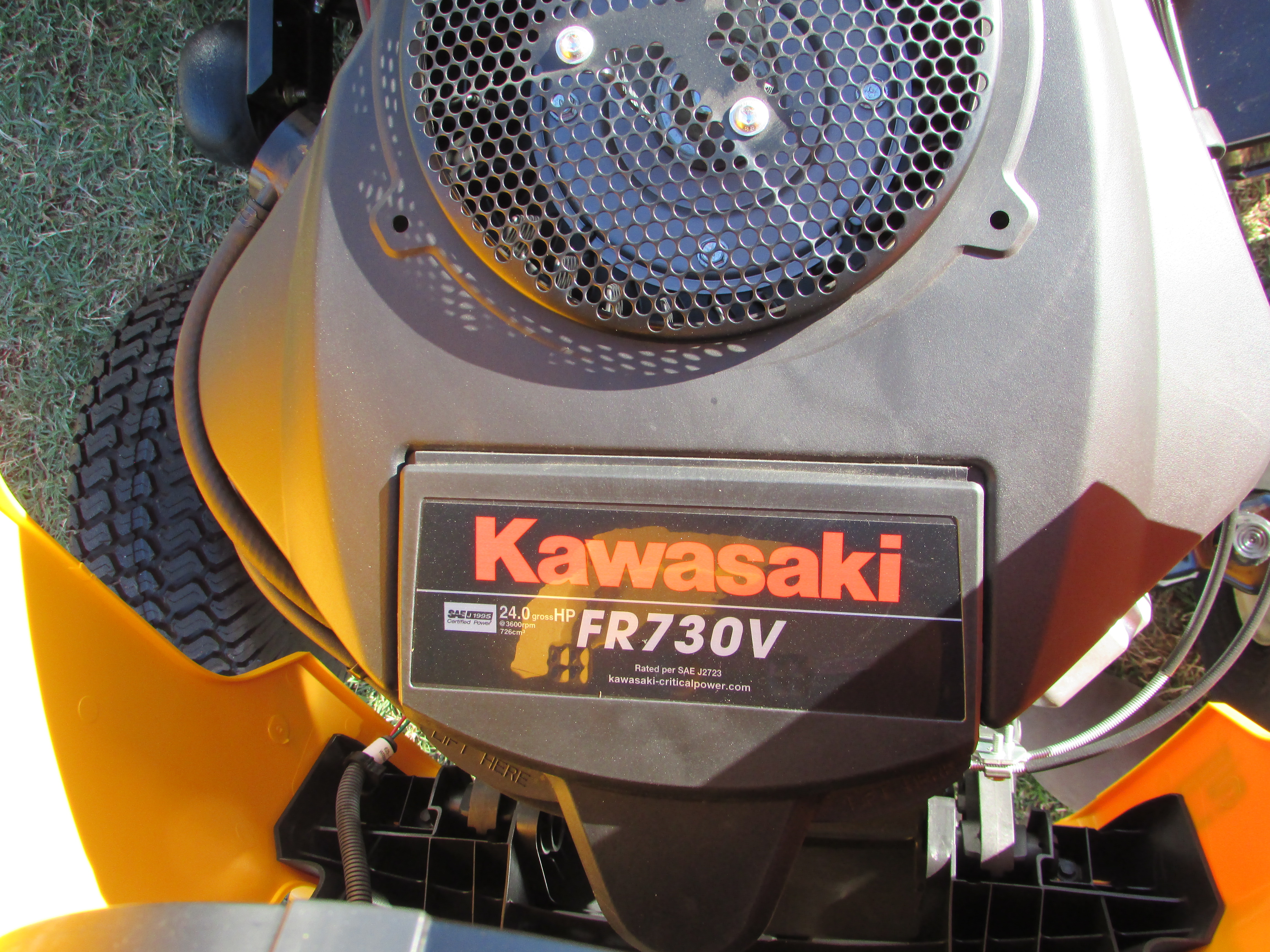

23hp is too much engine for this size riding mower but at least the Kawasaki should be bulletproof. Normally they put in an 18hp version, I assume the next size block down, but for doing very light lawn mowing, this engine will never get used hard. I've driven several z turns including my own with 27hp Kawasaki engines and never had problems, other than the higher up the hp the more gas it used. In this case, keep the blades sharp and just throttle back a bit. I usually run at 2/3 to 3/4 speed. Never flat out. Major fuel savings. Never had an issue with airflow or cooling because I keep aircooled engines clean.

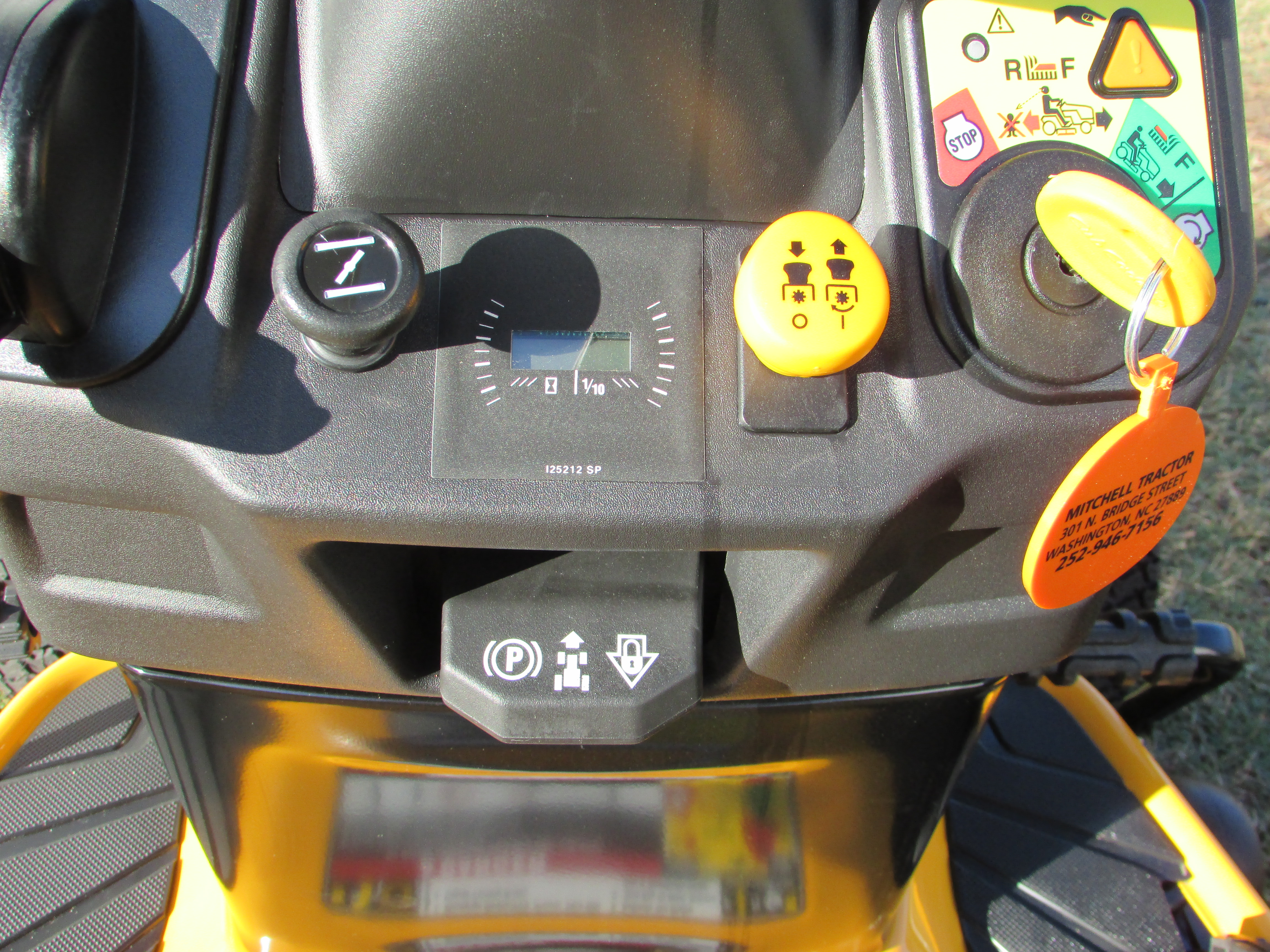

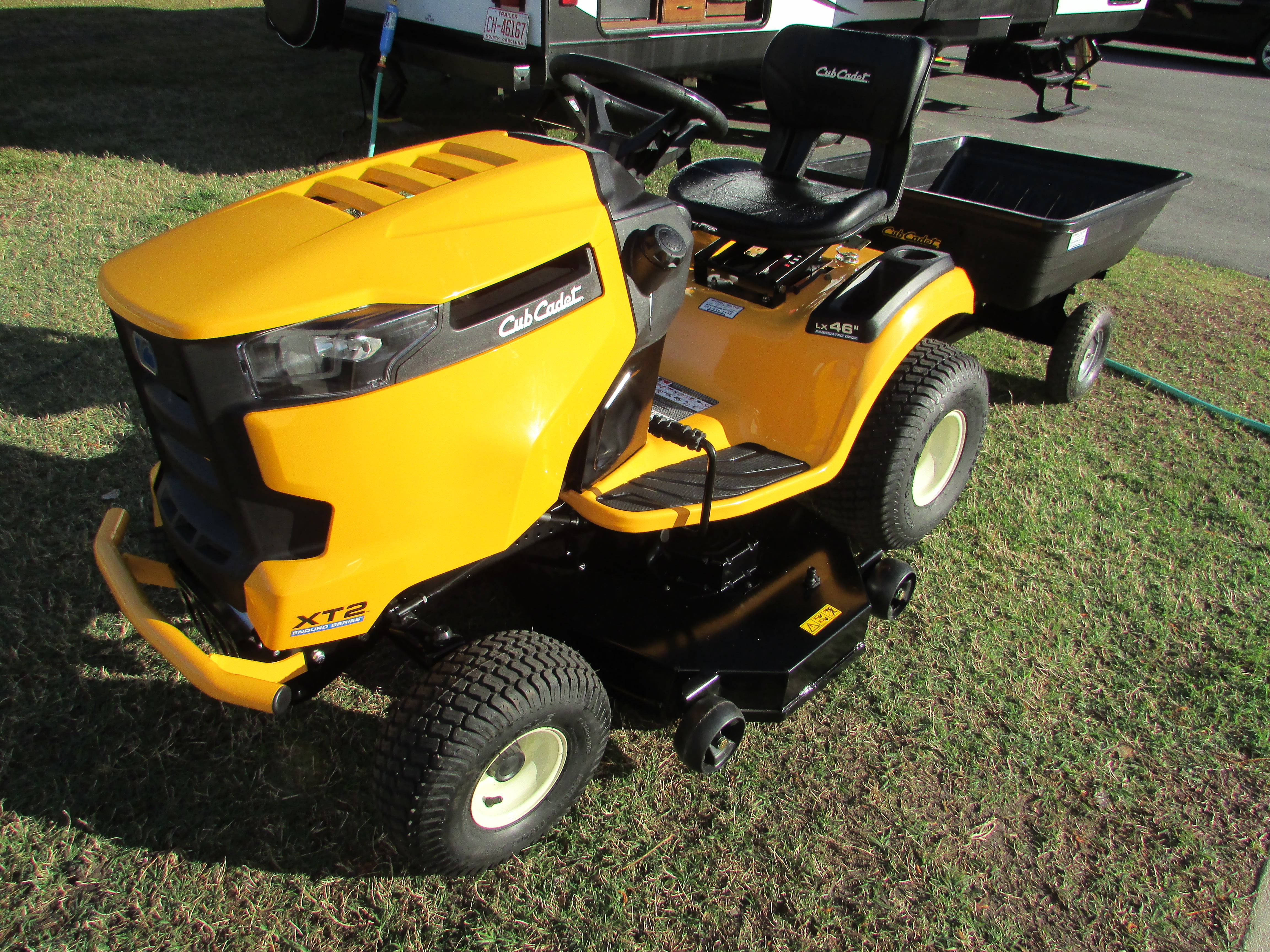

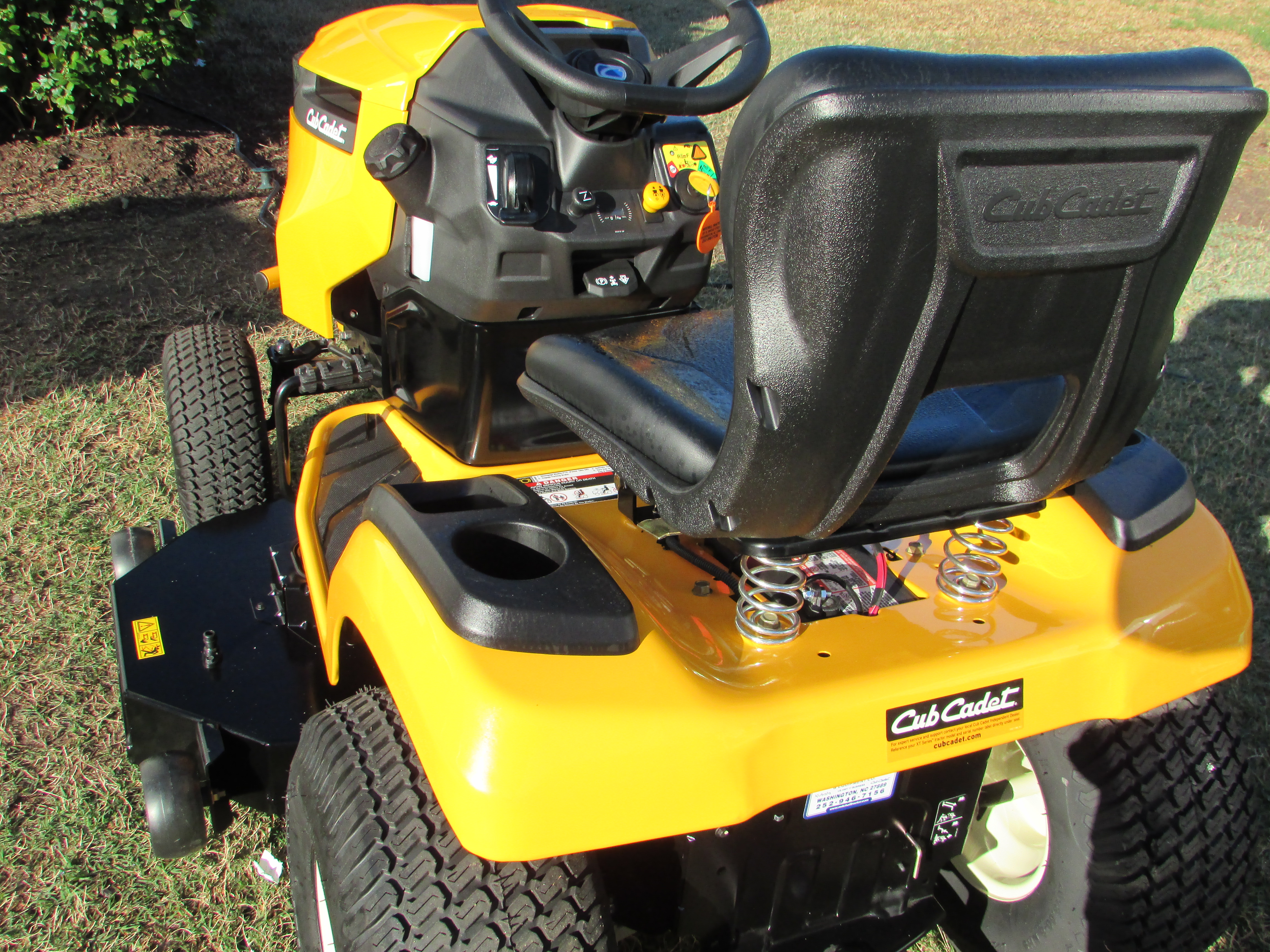

here are some pics. Seatbottom too hard, fixable with cushion, seat back has good back support.
Haven't tried cruise control.
find out their fabricated deck has sealed lube spindles. Actually better for this application because older lady would never
lube this thing corrected; didn't even know what a grease gun was. So in four or five years, around 300 hours likely the two spindles will be worn out.
Nice replacement business for CC...
24hp engine is silly for this size; reminds me of a Chevy Nova with a 396 engine...
