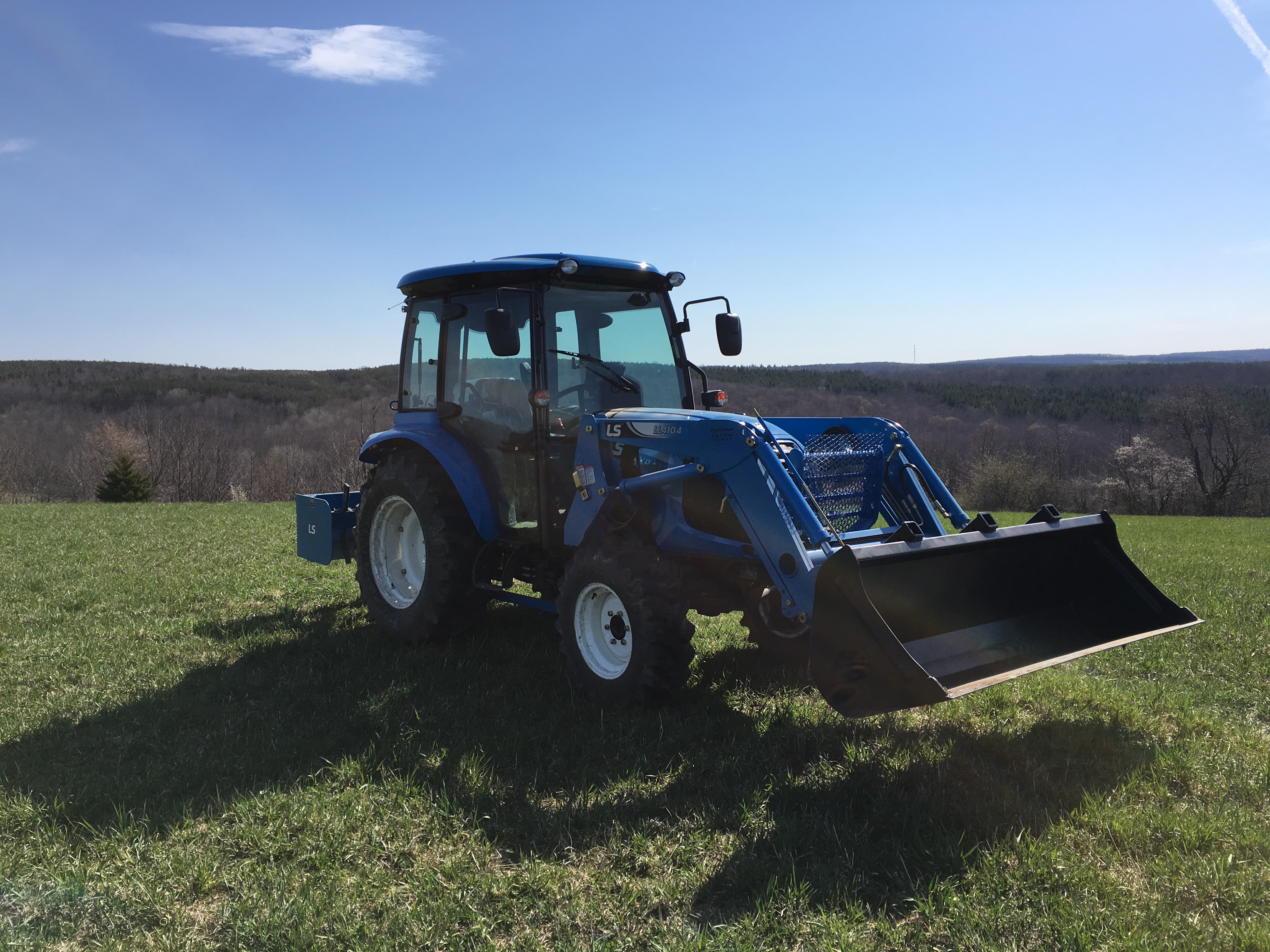

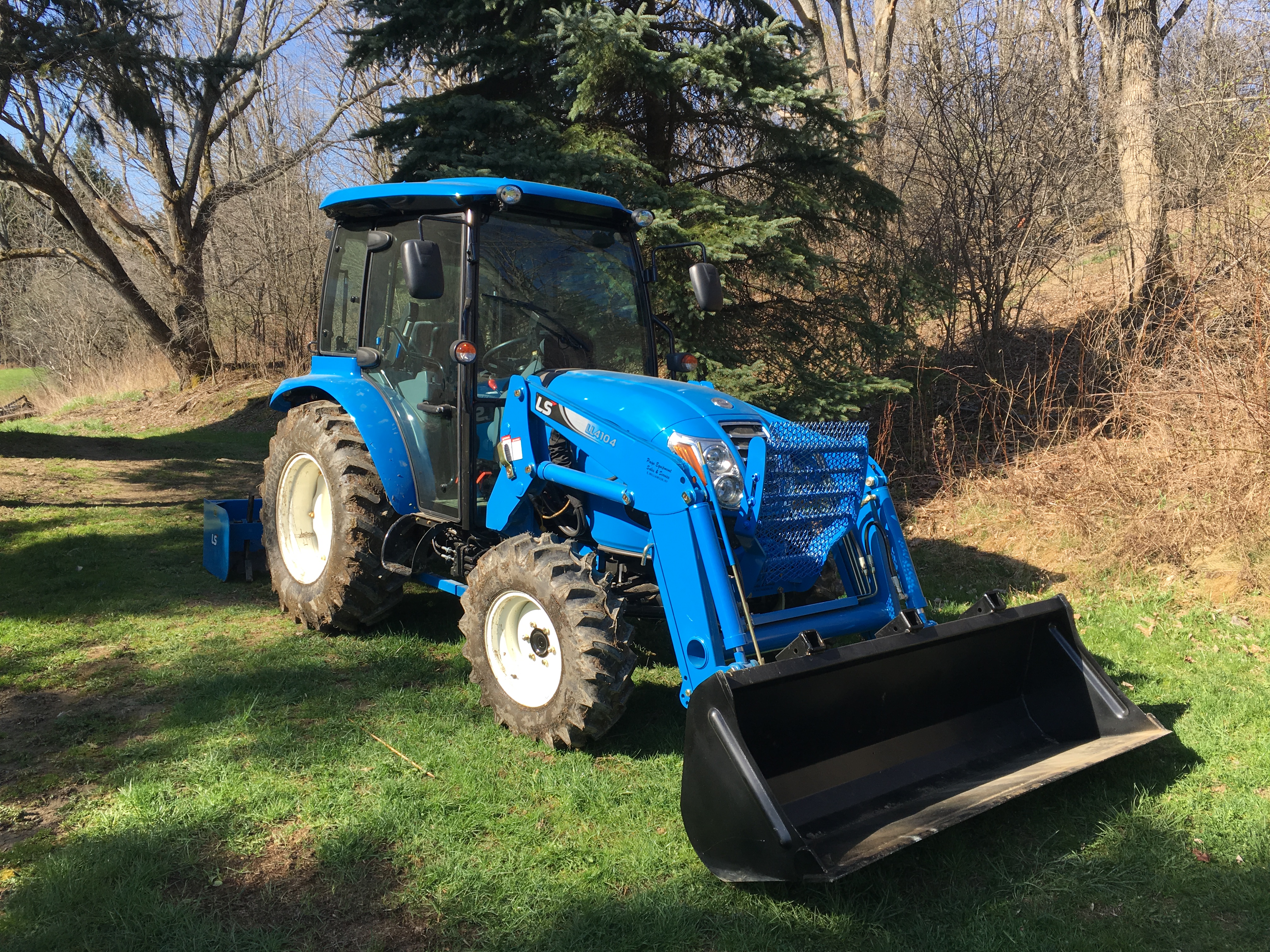

Hello All,

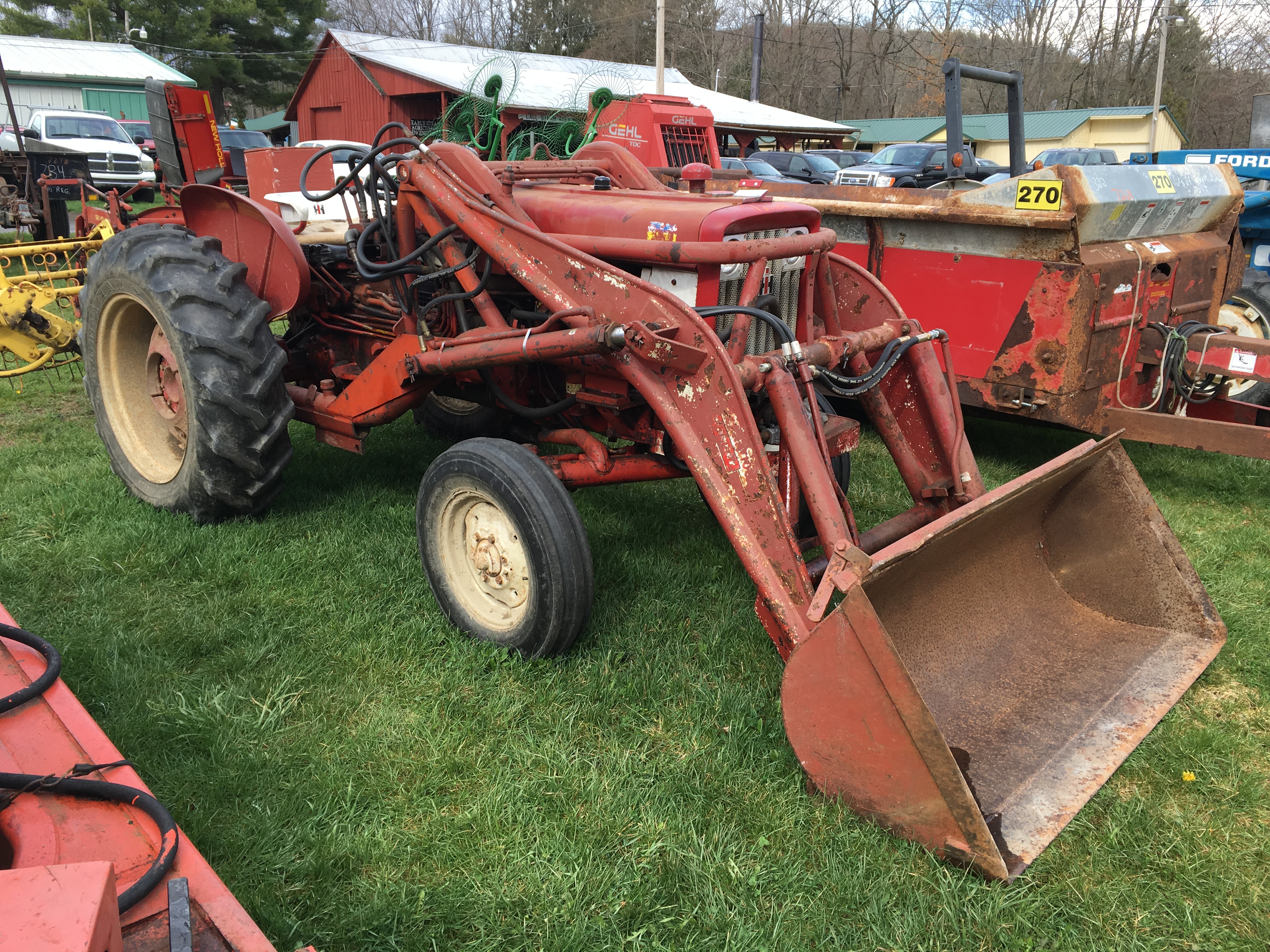

I just recently took delivery of my LS XR4145HC this past weekend. I sold my IH404 w/ loader at auction (went for $3500) which I used rarely as it didn't have a ROPS and my father mostly used it to bushhog. I wanted something newer with a more powerful loader and a cab and decided to bite the bullet and buy new.
I wanted to thank everyone here as I have been lurking for about 6 weeks learning all I can about newer compact tractors. I did the whole Kubota vs. John Deere vs. LS analysis and had many of the same concerns about LS popularity vs. the big names. I couldn't argue the value of LS and the members in this forum all seem happy with their purchase and the percentage of problem posts here wasn't any higher than the John Deer or Kubota posts, so I went with the best value and one for which I felt I had a good dealer. I was able to find good dealers for Kubota and John Deere too, but with the value I found in the LS tractor, I was willing to go with LS if I could find a good dealer.
I want to thank my dealer too, Paige Equipment in Western, NY. They are about 25 minutes away from my home, but 100 miles away from my property where the tractor is. They handled delivery there and worked with me on assuring me that I can affordably work with them to have them support my tractor even through they are 100 miles away. My experience with them so far has been excellent and I would recommend them to anyone looking for a LS tractor or the other lines they carry. They had almost every LS tractor model on the lot too, including the 2000, 3000, 3100, 4000, 4100, 5000 and 7000 series which is unusual compared to the other LS dealers in Western New York.
I look forward to now contributing with my own contributions as I learn more about this tractor, and the implements. Hopefully my contributions will help the next person looking to buy a LS tractor as much as you all helped me.
Anyway, I ended up getting the following from the dealer:
  • Tractor!
  • LS box blade (appears to be same as King Kutter/Pittsburg Field 233-BB-G-72)
  • A OBG2 Grapple
  • Hose kits to allow me to use the grapple with my rear remote, dealer installed. I have not done a diverter or true third function on the loader joy stick.
  • They welded on three 2" receivers on the bucket (and painted them), as well as one 2" receiver on the back of the box blade (And painted it). I also have 2 2" bars with chain hooks welded on that I can put into the receivers when I want hooks
I then did the rest on my own:
  • Radio (Went with a Bluetooth half-depth radio from pioneer). Thanks to info on this site I had the wiring info and Wired it fine, it works great.

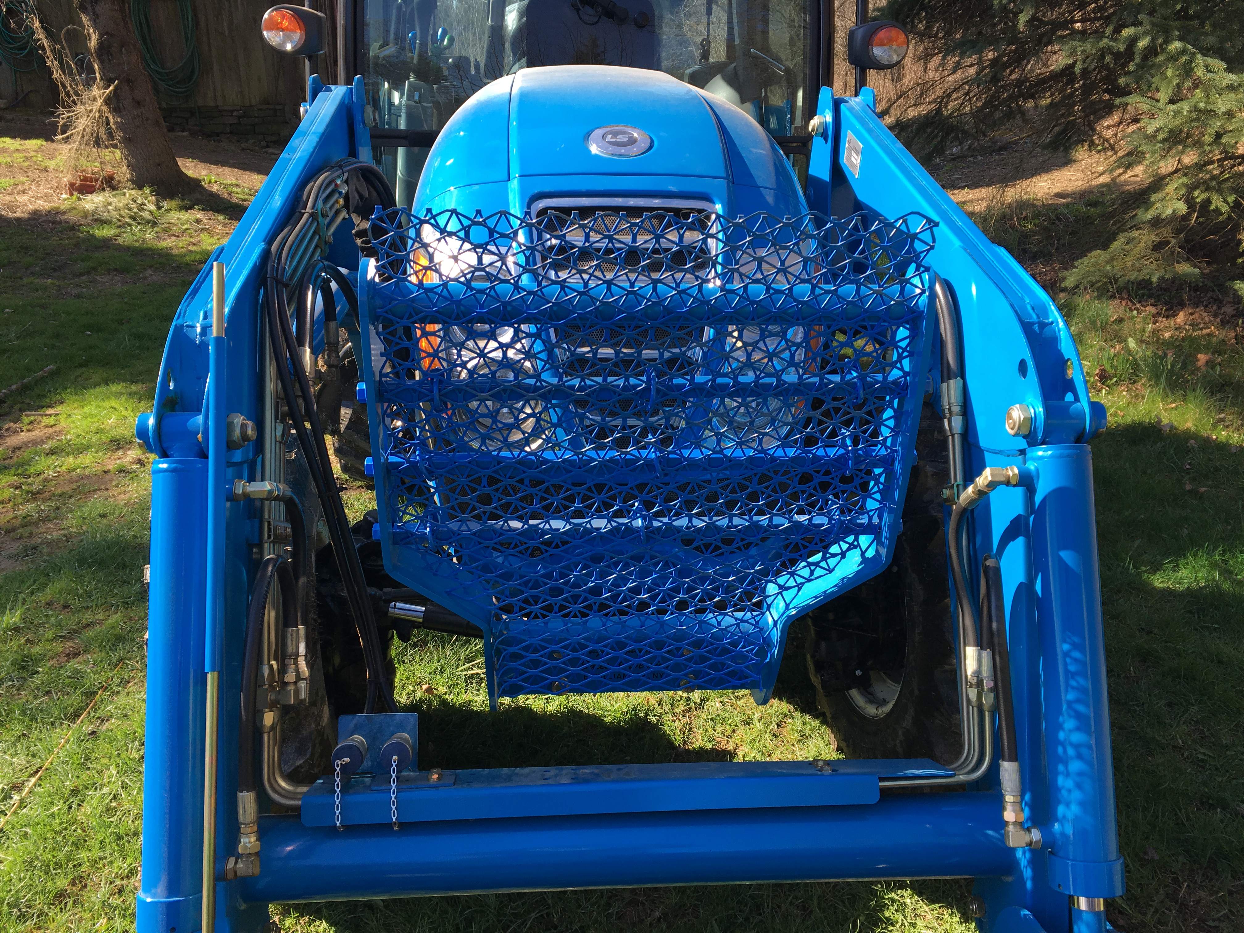

  • Built a front grill to protect front of engine compartment (Radiator, fan, transmission cooler, etc.) from materials I will be picking up with grapple. I have it 70% done, I have a few modifications to make and I am not sure I am going to keep it as tall (if I do, I need some support up there to keep it from bending). My design is a weldless design and it comes off with three nuts being removed, yet is very strong to prevent 4" limbs from bending it/etc. (I can provide more info if anyone who doesn't have welding equipment wants to make the same).
  • Backup and wireless Bucket Camera with center monitor to display both. The wireless bucket camera is string magnetic mount and can also be removed from the tractor and put near the work area so I can use it like a "helper" eye and see from another angle. it has its own 12V power source (using 5 18650 batteries) and wireless video signal. I like having this alternate angle view, very handy when working alone.
  • Inclinometer for both axis as my land is very hilly and I just want to know the grade.
  • A small boom that installs in the 2" receivers for setting 6x6 poles for decks/pole structures/etc.

Congratulations on the new tractor! Can you post more details about the bucket camera? Also, how do you plan to use the 2" receivers? I understand how grab hooks on the bucket would be useful, but not the receivers.

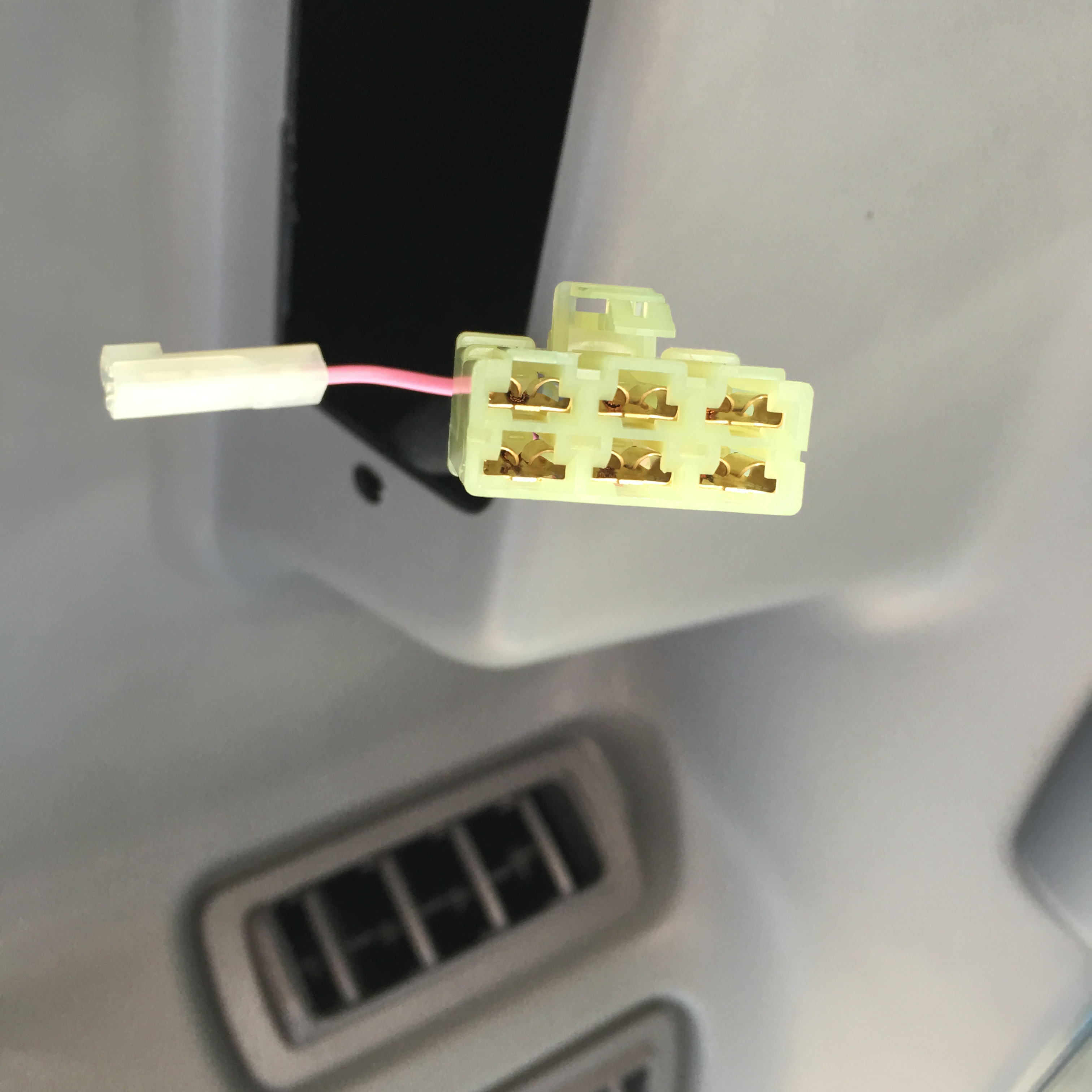

Here is some info on the Radio I went with. I didn't take a lot of pics of all my work but I'll share what I have.
First, I have to give credit to George2615's post as it provided 1) wiring guide for what all the wires did in the LS harness and this gave me more confidence it would be straightforward (My background is computer/electrical engineering, so I wasn't too worried about it, but having the color codes and what they are sure saves a lot of time!); and 2) it provided some additional information on what to expect and that he was successful.
George2615 didn't have any straight on pictures of the connector. I wanted to find the mating connector (e.g. a metra radio harness) so I could make it a really clean install. Unfortunately, I have yet to find the part number that mates with it. If we can all figure this out and find where to order one it would benefit all LS owners who want to add a radio and have be as plug and play as possible. I did take a picture of it straight on at the dealer before I had it delivered so I could plan my wiring, and I have included that here.
The radio I purchased was a Pioneer MVH-X380BT -- specifically this one:: Amazon.com: Pioneer MVH-X38BT Digital Media Receiver with Short Chassis Design and Bluetooth: Car Electronics
Note this radio is one of the better rated bluetooth radios for a decent price. Note it does NOT have a CD player. It is only half the depth of most radios due to the lack of a CD Player. I just use bluetooth from my phone (spotify, pandora, and locally loaded music), as well as the USB slot to the right (that little vertical white line wit a triangle on it flips open to expose a USB port). I can confirm this radio works great with a iPhone 6S Plus, and with USB sticks with music on them. I also like that when the phone rings it comes through the speakers (much easier to hear over tractor then the small phone speakers), and I can do the hands free as the radio comes with a mic, but its not pactical at operating RPM of 1800+ due to engine noise in cabin, but it would work at idle speeds. For $73 bucks its much more functional than the LS radio.
As I couldn't find the mating connector, I had to come up with my own solution. The Pioneer comes with a harness that plugs into the back of the radio and the other end are just loose wires you can adapt to your car/tractor/etc. One option was to cut the LS connector off and find a mating connector for the Pioneer connector, but I didn't want to modify the tractor in any way so that a future owner if I sold it could still get a stock radio (not sure why they would want one, but it would be an option).
The LS harness is big for a 6 conductor connector. I measured the size of the female sockets in the LS harness and found that a simple AWG 12-10 flat crimp on connector mates with each individual contact perfect. So I bought basically these: Connector, Male, 12-1 AWG, Yellow, Tab .32"x.25", Qty 1 (am-2213) (you can find these are lowes, home depot, etc -- the 12-10 size fits the most snug). Get some female ones too, one will be handy for the constant 12V power source (pink wire) from LS.
I then simply stripped each of the bare ends of the wires on the harness that comes with the pioneer radio for the signals that would mate with the LS harness (7 conductors). Note, the pioneer radio supports more features such as front and rear speaker pairs, and remote (e.g. buttons on steering wheels, etc). So you need to strip just the the 7 signals you need from the pioneer harness (switched power, always on power, ground, front left speaker +, front left speaker -, front right speaker +, front right speaker -).
Then I crimped each of these into the 12-10 flat connectors. I usually push the wire far enough in I can see about 1/16" of it on the other side of the tube. I then solder that down to the flat area to assure a solid connection and that it won't pull out. I don't like to solder them before crimping as the solder will wick up the entire conductor and it will become rigid and likely break behind the crimp point.
6 of those 7 connectors will go directly into the LS harness connector. You just match the signals up comparing the Pioneer harness conductor functions (the manual explains what they all do) with the function/colors of George2615 post I mentioned earlier. If I wrote down how I did it I would provide it here, but I didn't. I could recreate it by looking at the pioneer manual again. Its pretty straight forward.
The only thing I had to do I wasn't crazy about is handle the 12V constant on connector from the LS harness. They don't wire this into the main 6 conductor harness. They have this as a separate little connector. I had no idea what type of connector mated with that either and its too tiny to put any of the flat crimp on connectors on this. I wanted to finish my project so I cut the LS tractor connector off enough back I could re-attach it with solder and heat shrink tube if I removed my radio. I then just put a female version of the 12-10 crimp connector on it and that made a great mate point for the 7 conductors I put the male crimps on. I then just used electrical tape to make sure that any stress on the wires wouldn't pull out any of the individual connectors (although they were a pretty snug fit, I wasn't too worried about it). It's just safer to assure that it couldn't come apart since I didn't have a true mating connector that would lock.
The radio comes with a sleeve (DIN mounting cage) that fits perfectly in the LS hole and you just bend up the little metal tabs all the way around it once its inserted and they make a tight fit. Because the radio is not full depth it will not make contact with the back support bracket that is there for the LS dealer supplier radio option that is there to support the weight of the back of the radio. This radio is so light and its only a few inches deep so it doesn't really need back support. The sleeve fits so solid that I was comfortable not having the back support. After snapping the radio in and putting the border plate in, it looks great and it is solid.
I can confirm that George2615 wiring info is still valid for a XR41## series model as well. I can also confirm that the factory speakers leave quite a bit to be desired. They completely work fine for a tractor, but they do make me think about replacing the speakers at some point.
Other than buying the 12-10 connectors, and having a crimp tool and some solder (optional), everything you need comes in the pioneer radio box for mounting.
Sorry I don't have any pictures of the harness all wired, or the radio installed. My tractor isn't at my house, but at the farm. I'll take a shot when I am there this weekend.
