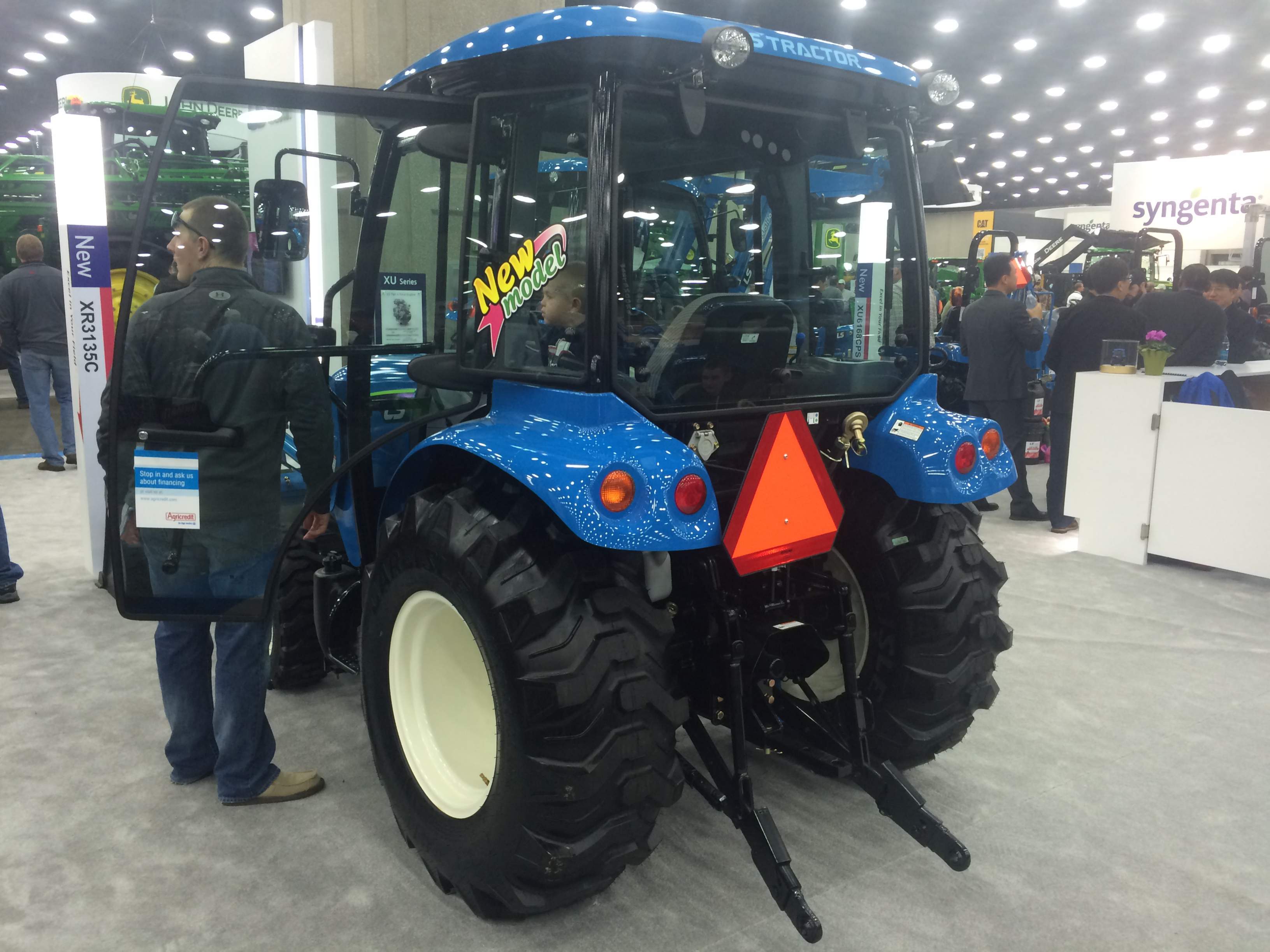

This is why I would like to see the specs on the new tractor and loader. It looks exactly the same as the 3037 but it has a different loader.
Went to the Farm Show in Syracuse today. Still no specs on new models available. New Tractors will probably be the same as current models but have different model numbers because of the new higher HP LS motors in them. I was told there will be 5 new models that will have the LS engine.

I provided the LS Rep. with a lift height comparison of competitor model tractors. He will take this info back to N.C. after the show is over. Perhaps newer future models will be more equal in lift height with competitor models. Also the new engine is to be built by LS and will start being installed as engines in stock run out possibly in June / July of this year. New LS engines will also be slightly higher in HP which is probably why the LS engined tractors will have different model numbers.
