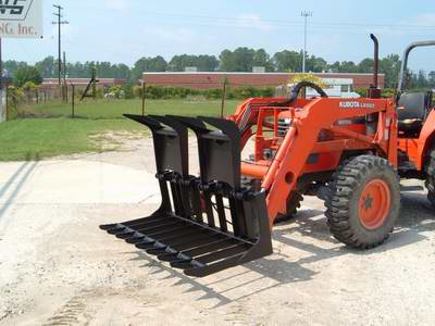

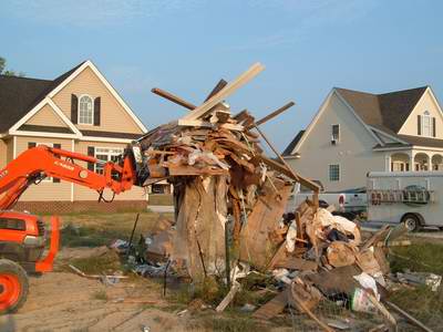

Here at the pics he sent with the email.

I got the email too - what do you guys think of the design. I would probably get the 48 inch with only one grapple - I like the flat bottom of the new design for carrying stuff. However, I wonder if you are giving up some clamping power with only one cylinder instead of two on the clamshell.

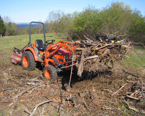

Looks like a very nice grapple. The WRLong clamshells are great but pricey in comparison to the LD48 from Millonzi. This new line looks like essentially the same basic design as the LD48 and is a pretty good match. Price is competitive which is nice too. I suppose they will stick with making these available only through dealers but even that is a nice option to have for some people.
I'm glad to see a respected company like WRLong start to move towards lighter weight grapples. I've always thought the heavier duty 600-800lb grapples were inappropriate for most CUTs and are basically designed for professional skid steer duty. I hope Nelson also steers prospective buyers away from the notion that your grapple should be the same width as your primary bucket. Lightweight and small grapples are excellent matches for CUTs.

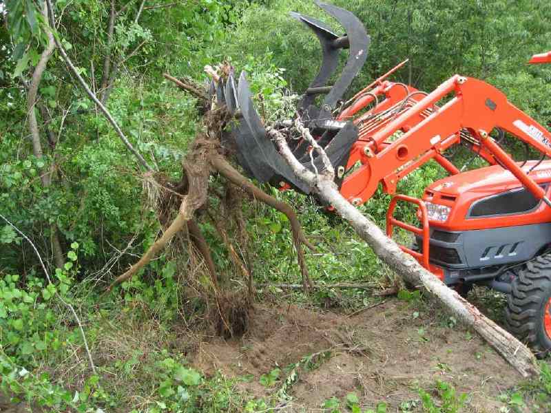

Clamping power is not an issue. A single jaw grapple can hold anything it contacts very well. Having two means that you can hold on to more loose short material but a single grapple jaw can do just as well with a tree, bush, rock etc. I'd want a double grapple or clamshell if I were picking up construction debris on a regular basis but for general use there is no particular advantage. Asymmetric objects are really no problem for a single grapple. You just pick the object up from a different side if for some reason (rare) you cannot get a good grip. There are downsides to a double grapple to consider too. A single grapple has advantages when you are trying to grab a medium size bush as you can grapple it right in the middle. With double top grapples you can get on either side but not the middle of the bush. I'd personally prefer a clamshell to double grapples but a single grapple works just fine for me.
Here are a few photos. The first shows a single tine from a single grapple holding a rock that must have weighed close to a ton. I think that is pretty good evidence of clamping power. I did not know I was gripping the rock with just one tine when I pulled it out of the ground.
Another photo shows an asymmetrical object firmly clamped.

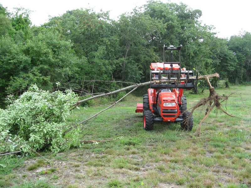

I actually did not try to travel with the rock held in that position. I dumped it and reloaded as soon as I saw the precarious hold...the point was that clamping power is not an issue. If you look at the photo I did not even have the bottom of the rock in the grapple but was able to hold on to it well enough to break it free and lift if out of the ground.
I agree that a bucket grapple or solid bottom grapple will do a better job cleaning up small sticks than a root grapple. However brush is very easily handled by a loose tine grapple. Brush naturally sticks to itself by intertwining and with a root grapple you are typically picking up whole trees and bushes not kindling sized pieces as the root grapple lets you remove the tree/bush in one piece. Note that with a root grapple you have a much better chance of just ripping a small tree out of the ground rather than needing to cut it down then remove the stump separately. Even with stumps under 5 inches or so it is not hard to stick a root grapple tine under them and pull them up in one piece.
I know that the double grapples are touted to be better at picking up asymmetric loads, I just have never had any trouble securing anything with my single arm grapple. I cannot recall, in the past two years, ever not being able to get any object, except a few small sticks, securely grappled so I could transport it. That goes for funny shaped rocks, stumps and piles of brush. Having two upper arms clearly increases the weight of the grapple and cost. It also lowers the net lift capacity due to the extra weight. I'd need to be lifting an awful lot of unusual shaped objects (other than stumps, brush etc which I do easily) in order to justify the cost and disadvantages of the double grapple style.
As usual equipment designs involve tradeoffs. A solid bucket grapple may well be the best choice for clean up of construction debris as there would be lots of stuff under a couple of feet in length.to pick up. Otherwise, and especially for brush removal and trees, I'll stick with the root grapple or clamshell style. It's nice to see that WR Long is offering both now.
