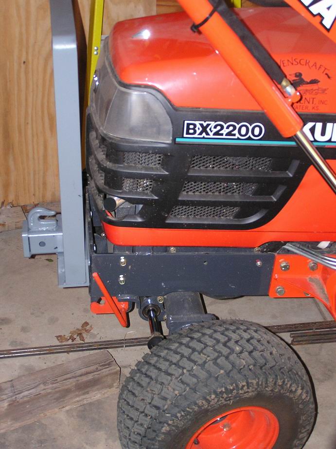

Since I added a receiver hitch to the front grill guard of my BX, I've thought that I could build a blade and use it to push snow in lieu of the FEL. We don't get enough snow to mess with, so I doubt I do this project.
Attached is a pic of my grill guard, if it helps any of you with ideas to mount a front blade.
With my design, I could weld a bracket to the top of the guard and somehow (?) use that as a method to lift the blade. Maybe an electric winch????
