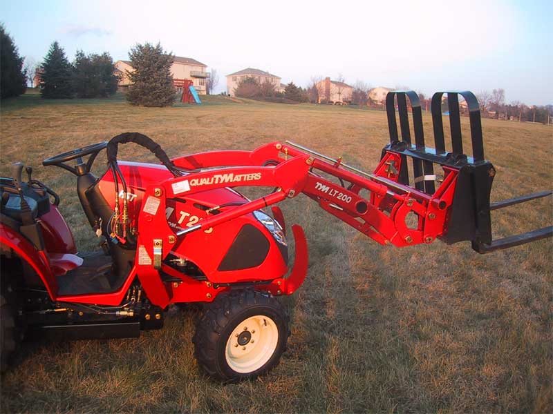

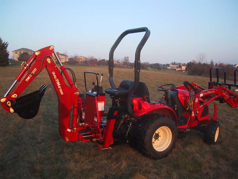

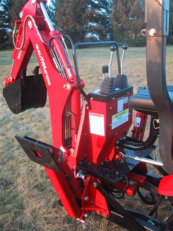

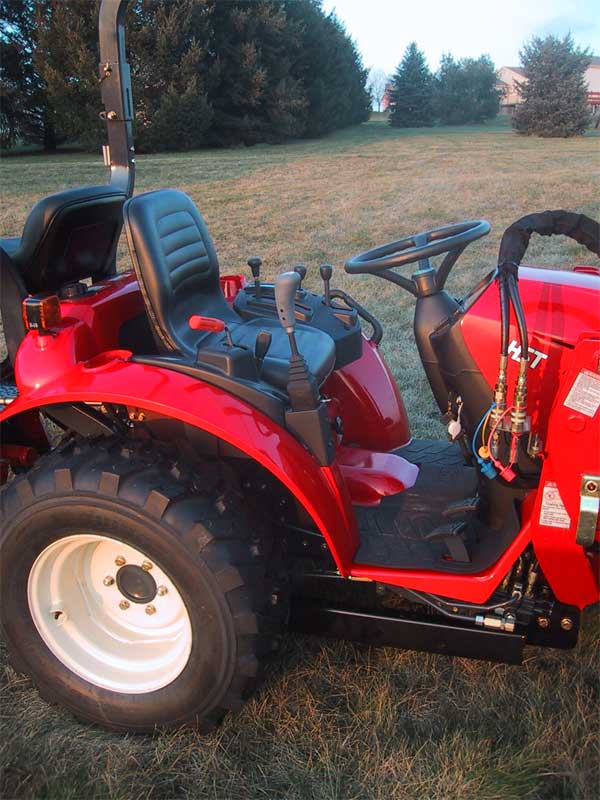

Hi all,
Just thought I post some pics of my new toy... err I mean tool :) So far I'm really pleased with my choice, I downsized from a NH TC45DA, which is a really nice tractor but was just too large for my current property. To be honest, I was close to buying a TYM 330, but after I messed around with the K2 series I just decided it was large enough to do 90% of what I wanted, and that 70% of the time I'd actually rather use the smaller tractor because it's easier on the turf and more nimble. Haven't seem many pics of the new BH, so thought I'd post some here.
BTW, the BH is REALLY nice, it's very smooth to operate and very stout for a small hoe. The full subframe does reduce ground clearance, but it's no doubt the best way to reduce the applied stresses through the center of the tractor when digging in tough conditions.
One of the really nice features on this model is the QT on the loader, I use forks almost more than a bucket, so I bought a set right away with the tractor. Neither JD or Kubota offered a standard QT on their smaller tractors... too bad cause lack of this feature caused me to keep looking..:)
I only have a couple of hours of seat time, but after I get a few hours in I'll post some additional comments.

It may reduce your ground clearance a little, but it looks like it really gives the hyd. connections underneath some good protection. I am always real careful when I'm rolling over big branches and stuff with mine because I'm afraid it may contact that assembly and tear it up. It looks like the subframe mount puts a lot of beef between anything that you may run over and that pipe work.

Hey, congrats on the T273. I have one as well and really am impressed with what it will do, especially the backhoe. Howlin Wolf is correct about the subframe adding what I thought was needed protection for the hydro lines running under the tractor. Only words of caution for you regarding the bh is that when / if you take it off, be carefull while moving the assembly around once it is free of the contact points on the tractor because they run pretty close to those hydro lines and it would be easy to ding one if you get too carried away with the levers while removing/reattaching the bh.

Hey Toolnut, nice looking tractor. Congrats on the BH addition. In your 2nd pic, the pad on the outrigger looks pretty slick (not as in "cool", but as in "not having any grip"). Do you find that when using the hoe, the tractor trys to slip toward area of dig? I saw a simple solution on one of the other threads, where someone welded a couple pieces of angle iron to the pad to give it some teeth. Once again, best of luck with your equipment.
