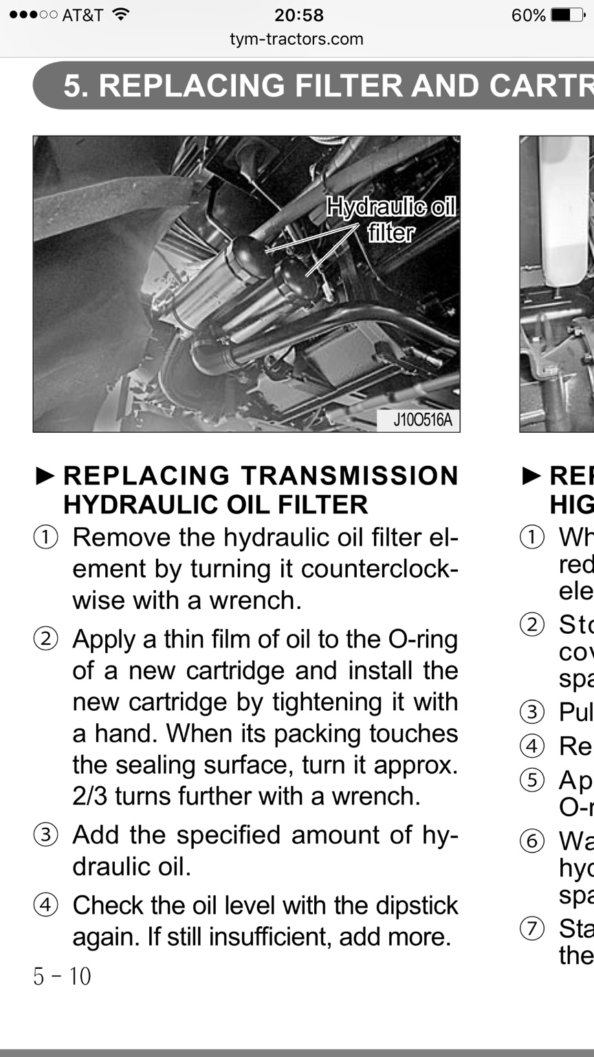

Nice tractor you went right for their largest one. I would think the filter would be a spin on one so it should not be too hard to find. I am tempted to buy a tractor from themJust wondered who shipped his tractors. I too live in MA. I think this should be the filter. IMG_0699.JPG
Should be the transmission filter. I'm looking more to the 45-65 hp tractors. Where about in MA are you.

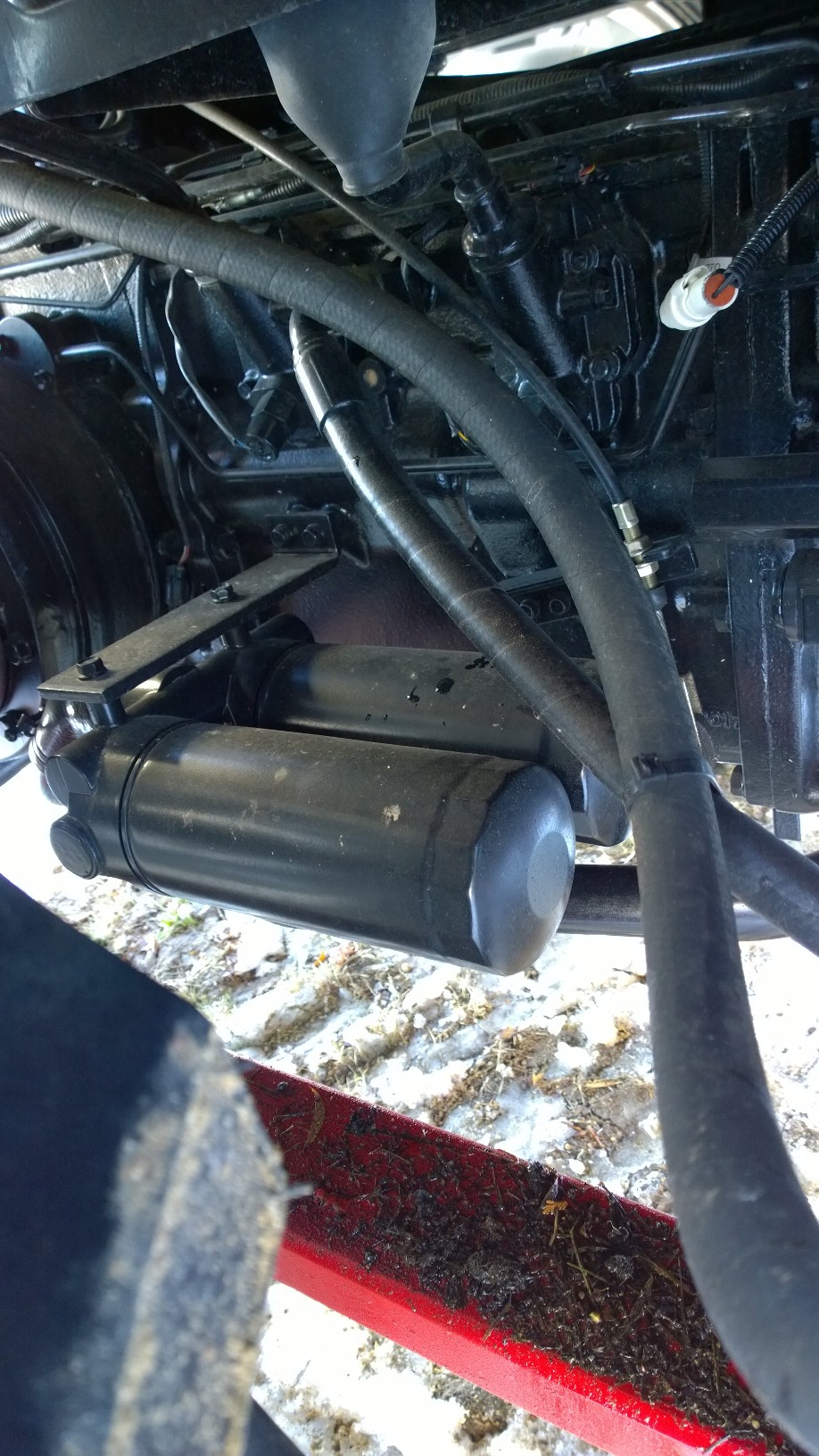

Re the hydraulic filter, the page you copied I have in both my manuals -- a paper manual that came with the machine and an electronic one that I got off the TYM website that are dated 2011 and 2008, respectively. My T1003C is the last year of the Tier 3 engines built in 2015 and there are some changes not reflected in either manual. The hydraulics are one. The manuals call for a dip stick to check the hydro fluid levels. There is no dip stick on my machine. Only after me and a buddy searched did we find s a glass sight gauge located on the left rear side of the machine tucked behind the rear wheel. The manual tells you where to find the smallish, vertical hydro oil filter. Where the manual tells you to look to find it you'll find the covered battery on my machine. The hydraulic filters are actually further back and they're much larger TWIN canisters that lie horizontally. Hydraulic Filters.jpgYes, I should probably feel stupid for not instinctively knowing to ignore the manuals but I'm not a mechanic, nor did I particularly feel like crawling around in the snow and mud to explore. Even the dealer's mechanic and regional manager couldn't tell me anything other than what the manual was saying. It took the east coast distributor's lead mechanic to confirm what I suspected were the hydraulic filters by sending me the page from the parts catalog that showed an illustration of the filters (and even that illustration showed smaller, vertical twin canisters).Vertical Hydraulic Filters.jpg

As far as not being able to immediately find the hydraulic filters, yes I feel stupid (worse than green) but the mitigating factors (as described in my reply to BTown) are two operating manuals, a dealer mechanic and territory manager who all steered me wrong. By no stretch do the hydraulic filters on my machine match what is shown and described in the manuals. I figured it out eventually but this took more work than it should have. Interesting how the engineers who designed and built the machine had more on the ball than the technical writers and translators responsible for the manuals.

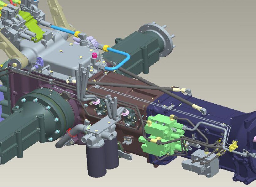

It looks like you have the new design that they are using on the T-1054. I would think this would have been well known and more people would know. But not sure how many 100 hp TYM's are sold. IMG_0705.JPG

From the looks of the T1054 manual, about the only thing changed from the last T1003's were the transmission filters arrangement and the engine, no doubt due to the Tier 4 change. The T1054 manual is actually better than that which came with my tractor and what TYM has online for download for the T1003. The technical writing also appears better.
