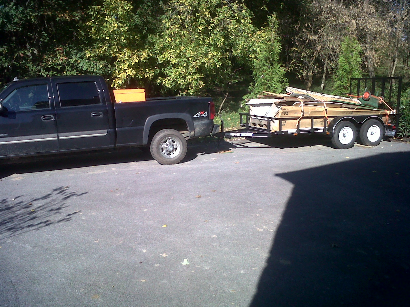

It is a 6x12 tandem axle. I wanted something as small as possible with 2 axles. It will be used primarily for hauling trash and construction material, but I wanted to possibly move my BX24 (probably minus the backhoe). Moving the tractor would be a rare occasion. Is it safe to place the bucket on the tongue essentially hooking the front rail, this would allow the entire tractor with backhoe to fit on the 12' space?
In the pictures I attached it looks like the load is not balanced, but I think there might just not be enough drop on the hitch. The load on the trailer is probably around a ton, and I did do my best to balance the weight. Would it be beneficial to get a different hitch?

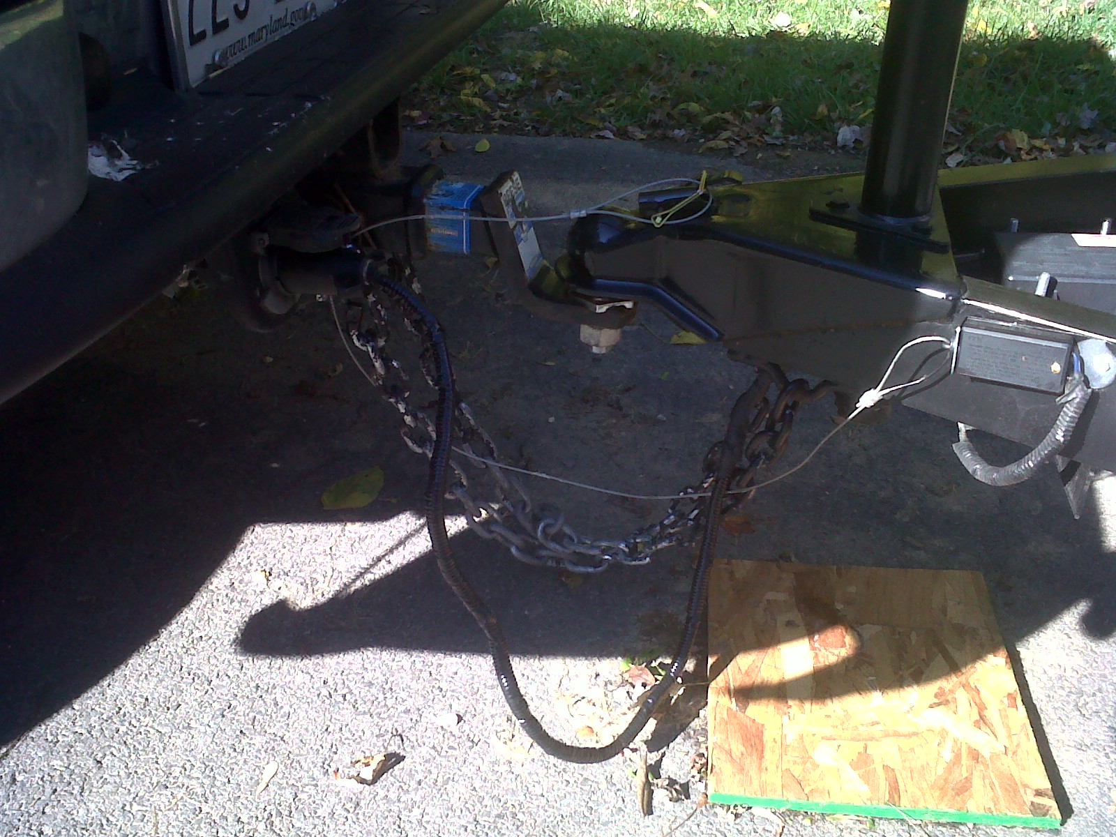

It looks like the safety chains are too long, it seems like they would not catch the tongue before it dug into the road which is what I thought the chains were meant to do. Should they be shortened?

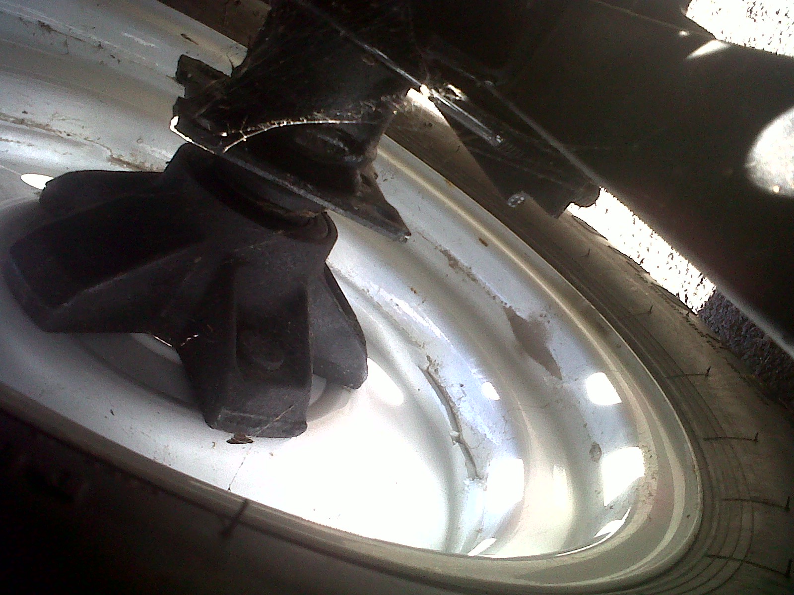

I want to add brakes to the front axle. Are the brakes in this 10" ELECTRIC TRAILER BRAKES 10 INCH BY 21/4 | eBay ebay auction appropriate?

Looks like that is either a 3/4 or 1-ton truck. My suggestion is load the BX on their as you describe (loader bucket on tongue) and go with it. The trailer probably weighs less than 2,000lbs, and the BX probably weighs what, 3000lbs or so? As long as the tractor fits on the trailer I see no problem with your setup. :thumbsup:

Ideally, you want the trailer to be as level as possible for better handling and stopping. From the pics, yours looks better then most trailers on the road with a steep pitch.

yes it should be, but dont cut them or anything. Just twist the chains the right number of turns until it has right amount of slack when making a sharp turn you won't be pulling on chains but not going to drag on road. I have 16 ft trailer I have to do that with my van, but needs an extension on my blazer.

One more thing- your saftey breakaway doesnt look kosher to me. If others agree/disagree let me know. If I were you, I'd add a climbing snap to it and hook onto the bumper of truck. This way, if the hitch falls off, your bumper is still attached and can pull pin for brakes. My blazer as stamped out holes under the bumper for chain hookup when using the bumber as hitch so I use that for breakaway cable.

As for the chains, twist them a few turns to shorten as others noted, and then cross them under the tongue. That way they can cradle the tongue in the event of an emergency. This also allow you to turn without binding up a chain. If they happen to be a bit short for sharp turns and are not crossed, the outside chain can bind up.

For the brakes it looks like the ones in the link will fit, just need to confirm matching center hole diameter and the 4 bolt pattern to match from your axle. Most are pretty much standard, but still better to check.

Shorten the safety chains and cross them to make the basket if you are not already doing that. If chains drag the road when loaded heavy you can twist them to shorten them up, but you are compromising the chains strength when doing so.

There is more to brakes then what you showed. You need the drums, brake-away, battery, wiring, controller, ect.
