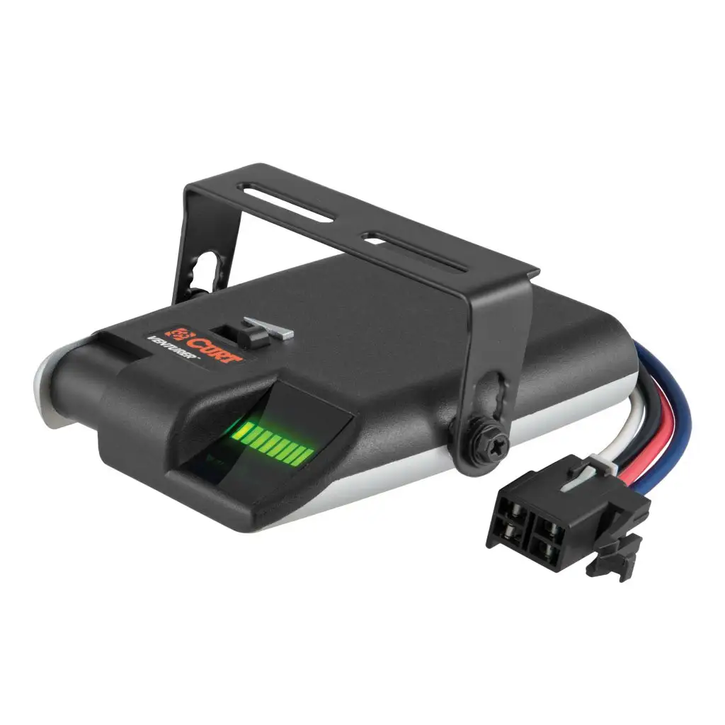

I have a tandem 10,000# Suretrac trailer and just did brakes on the front axle.
I bought the whole self-adjusting assembly from etrailer and bolted it on. Everything fit well and looked good. When I drove it on the road the front axle tires would lock up with the slightest press of the pedal.
So I adjusted the controller way down and then adjusted the pads to the minimum on the drums, but it doesn't seem like they are 'braking enough'
I expected more friction on the brakes, but not so much to lock up the wheels with half power on the brake controller.
Any suggestions?

What kind of brake controller do you have?
The one I have has (3) different settings 6.1, 6.2 and 6.3, and then has a rotary wheel for additional fine tuning.
An unloaded trailer will not be the same setting as a fully loaded trailer.

It's just a basic CURT brake controller. Maybe I'm not adjusting it right, there's 2 slide switches to adjust.
The brake assembly are pretty much adjusted back to the position when I bought them.
   / New trailer brakes, lock up easy #6
Is it this one?
If so, here is the manual.
https://www.curtmfg.com/masterlibrary/51110/installsheet/CME_51110_INS.PDF

Are you sure that the assemblies were installed on the correct side. They are designed right and left. If installed on the wrong side the large shoe will be toward the front resulting in brake lockup.
