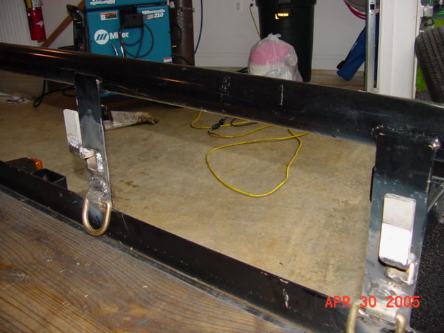

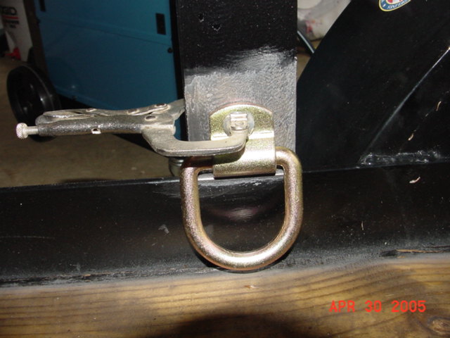

It needed D-Rings installed, so I bought 14 of these from TSC, cut one mounting tab off, and welded them on...

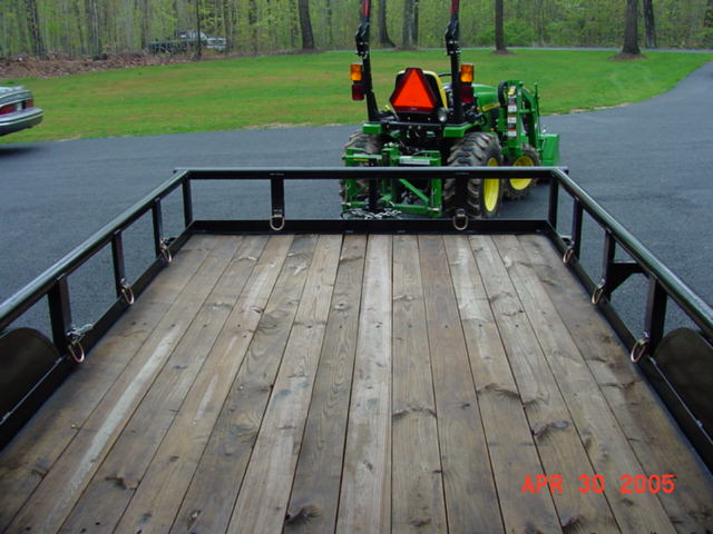

All 14 are now welded on

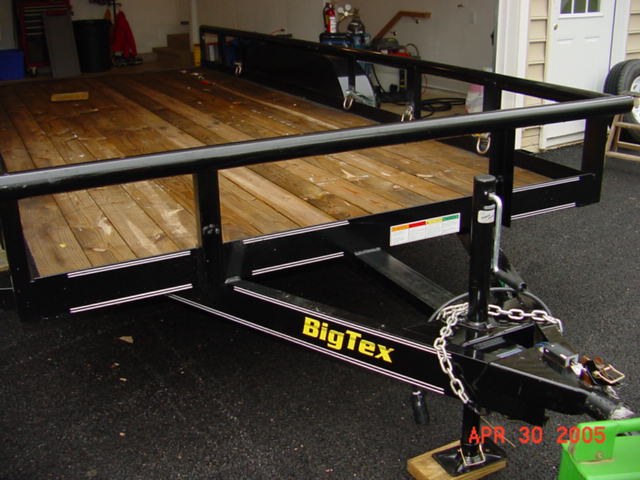

Front view...

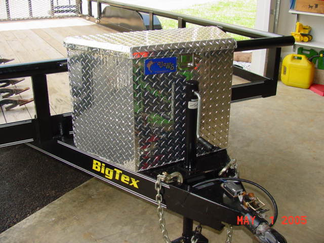

I mounted a tool box on the tounge for tie downs and other important "stuff"

Nice trailer! Great work with the D rings. In pic 2, is that the side of a brand new MillerMatic 210 I see? /forums/images/graemlins/cool.gif
