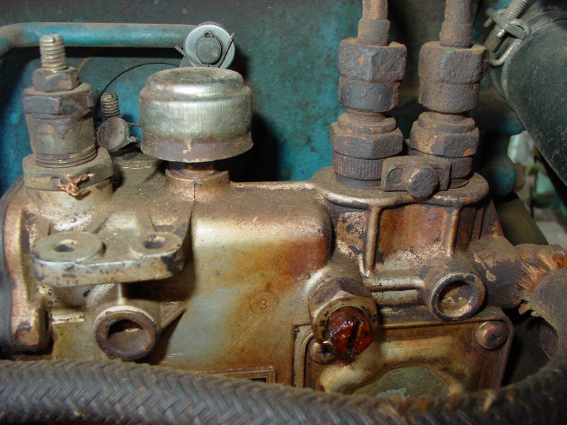

New to the world of owning our own tractor, and found a 4wd Ford 1700 with a loader+5' mower + drag-blade (I think it's called? Angle blade?) for 3k, and couldn't pass it up. Yes, the previous owners said they burned out the clutch by running an irrigation pump... but still, 3k for all that?
Anywho. I have my clutch kit on order, and we've been painting and rehabbing the old girl. I'll be draining all the oil, and transmission fluid, new filters, new oil in the injector pump... all the things.
I DO have a question though, I blew off the breather/plug cap on the injector pump while I was pressure washing the engine, and I'm not sure if the cap broke, or how it's supposed to get back in there. It also looks like it has a bit of grease in there, but maybe it's just old oil, I'm not 100% sure. Pics here: https: //photos.app.goo.gl/YRi2eCEXkfDDJNtWA

Congrats, clutch replacement should not be difficult task and parts are readily available. The cap is a cover for the hole on top. it is just a breather cap. I would take a bottle cap and hot glue it there while being careful not to plug the breather hole. Grease looking film is just the old dried up oil. You just put same crankcase oil in the injector pump. it will be around 2 oz of oil. You got top breather plug as a fill, drain in the bottom and level hole/plug in the middle. We have bunch of info on 1700 that covers a lot of stuff.

Is the breather hole the little almost-divot in the top of the plug shaft?

yes, that's correct. Pretty much what you buy is China made , even some OEM made there with higher specs. when You get a kit it come with release bearing , pilot bearing,pressure plate, friction disk and an aligning tool. Replace all and don't leave anything old behind. Mine after 40 years and 1300 hrs has the original with 90% disk thickness left. I would not hesitate buying like what you have done. Good luck, you'll be fine. Take pics as you go along so you can retract your step. Sometimes I take a card board and draw up bolt pattern and as I take the bolts our poke them in hole to match the pattern if the bolt are different size or lengths just for clarity. one reason that the price is good is that it same disk dia and other specs are shared among many tractor which always a good thing.
