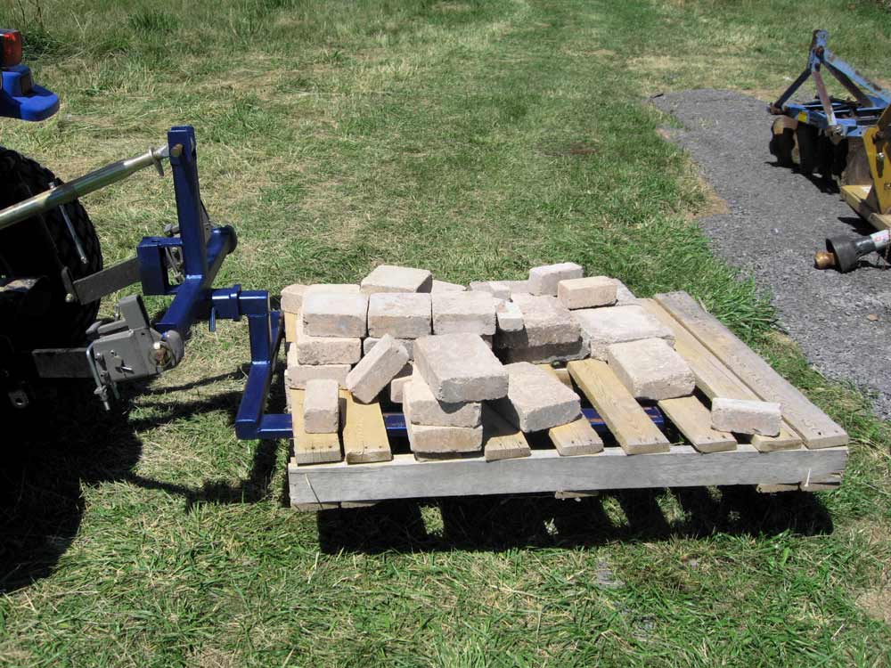

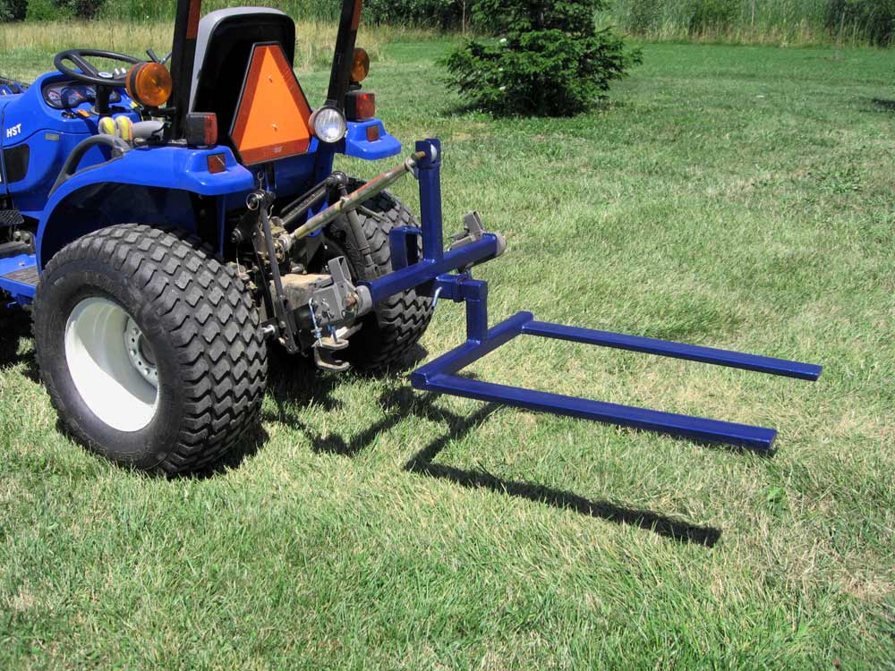

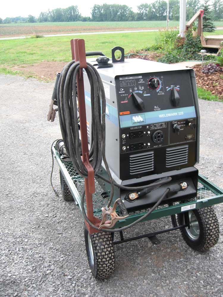

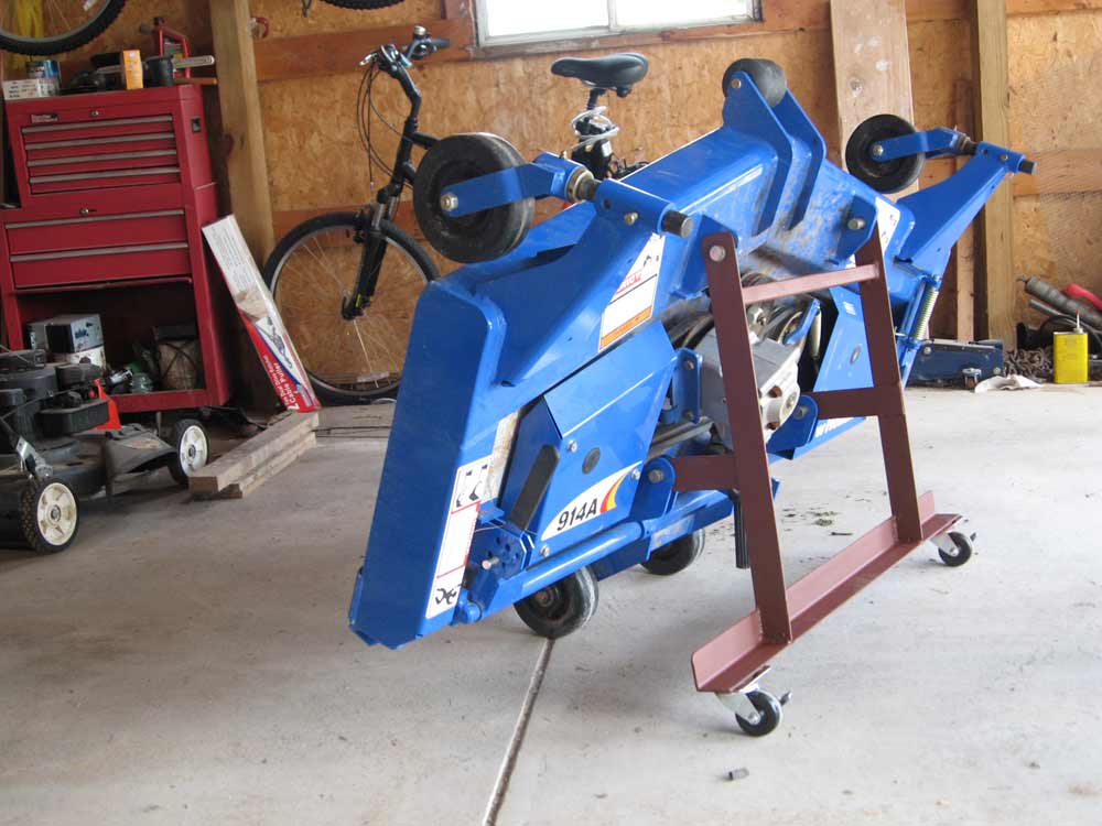

I just received my new NH TC26DA about a month ago and just purchased a Lincoln 10,000 last week. I have been so busy in the last week it is unreal. I have moved over 10 yards of dirt, moved 20 ton of gravel, built a pallet lift for my 3pt, modified a wagon for my welder and cables, built a rolling stand for my belly mower, and just welded my hooks on my bucket today.
I figured it was time to thank everyone for giving me some ideas and keep them coming. I have many more plans of things to do with my tractor and welder. A welding table is big on my list but it has to fit in my garage along with everything else. Thanks again.

All good looking stuff. I do wonder how much weight you can put on before the nice pallet thingy bends. Some bar stock in the vertical plane close to the joint between the arms and the rest would strengthen the pallet thingy a bunch.
Pat
   / New Tractor, New Welder, Projects Galore
I already loaded a pallet up with 18 -10" concrete blocks and it had no problems. I figured I had about 300 lbs on it and then I got on it too so it held about 500. It is 1/4" tube steel and if it bends it will give me something else to build.
   / New Tractor, New Welder, Projects Galore #4
Hey, If it does what you want that is what counts. Couldn't tell it was 1/4 wall in the pix. I have used some 2x8 and 3x8 square with 1/4 wall and that stuff is mighty stiff in short lengths.

Oh by the way, I didn't specifically comment about the welder hauling cart but I do like it, especially the realistically sized tires. Too often folks try to get by with tires that are too small in diameter (insufficient clearance) or too narrow (insufficient flotation and they sink in if the dirt is soft.)
