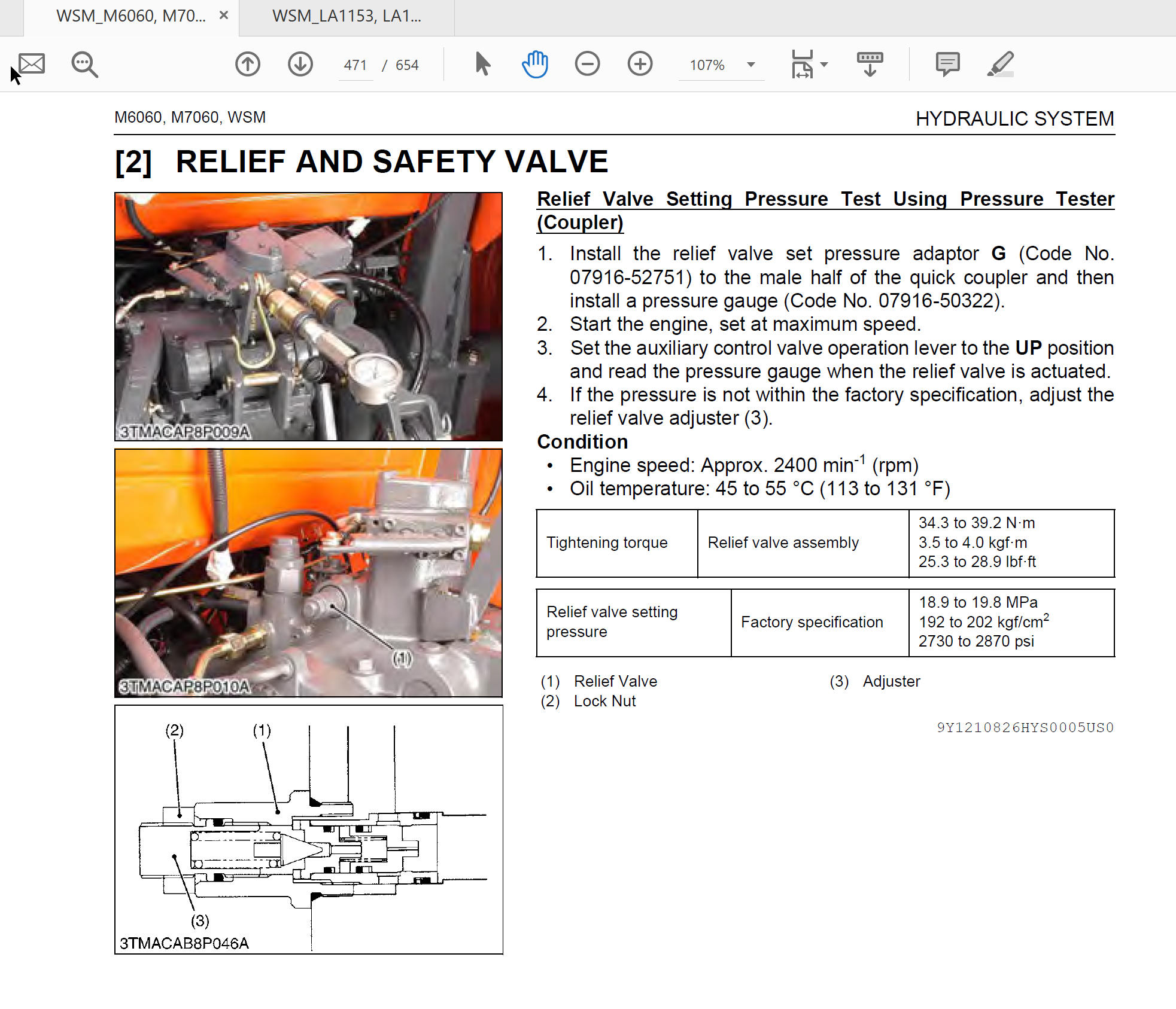

During today's walk through we test the hyd pressure at 2100rpm at third function connect on the FEL, and it read just hair under 3000 psi, factory spec says 2770 psi, now the rear hyd valves were all about 300psi lower? Why?

I think the loader valve and SCV bank run independently of each other, and have their own reliefs. What are you planning to do with the rear remotes that takes more than 2700PSI? Most implements either need a simple cylinder to run or a motor that cares about flow first, PSI second. A lot of them are only rated to 2400PSI anyway.

Being an open center system I believe the oil gets to the loader at the end of its trip through the system. As the pressure cannot be higher than the lowest relief in the system, I’d be interested to know what the peak loader pressure is when a remote is at relief. I am not sure of your hydraulic schematic but if it’s like our JD loader tractor, flow goes to the loader control from a power beyond port at the main valve stack. When the casting in that valve block got a small crack, the loader would hardly lift a bale. The 7060 has an even simpler system. The book spec on the loader pressure should have a tolerance. If the nominal is 2770 you should find a + or -. Having a higher pressure will give you better performance but at reduced component life and possible part failure. Still if the relief is at 2770 and you never run it to relief no problem.

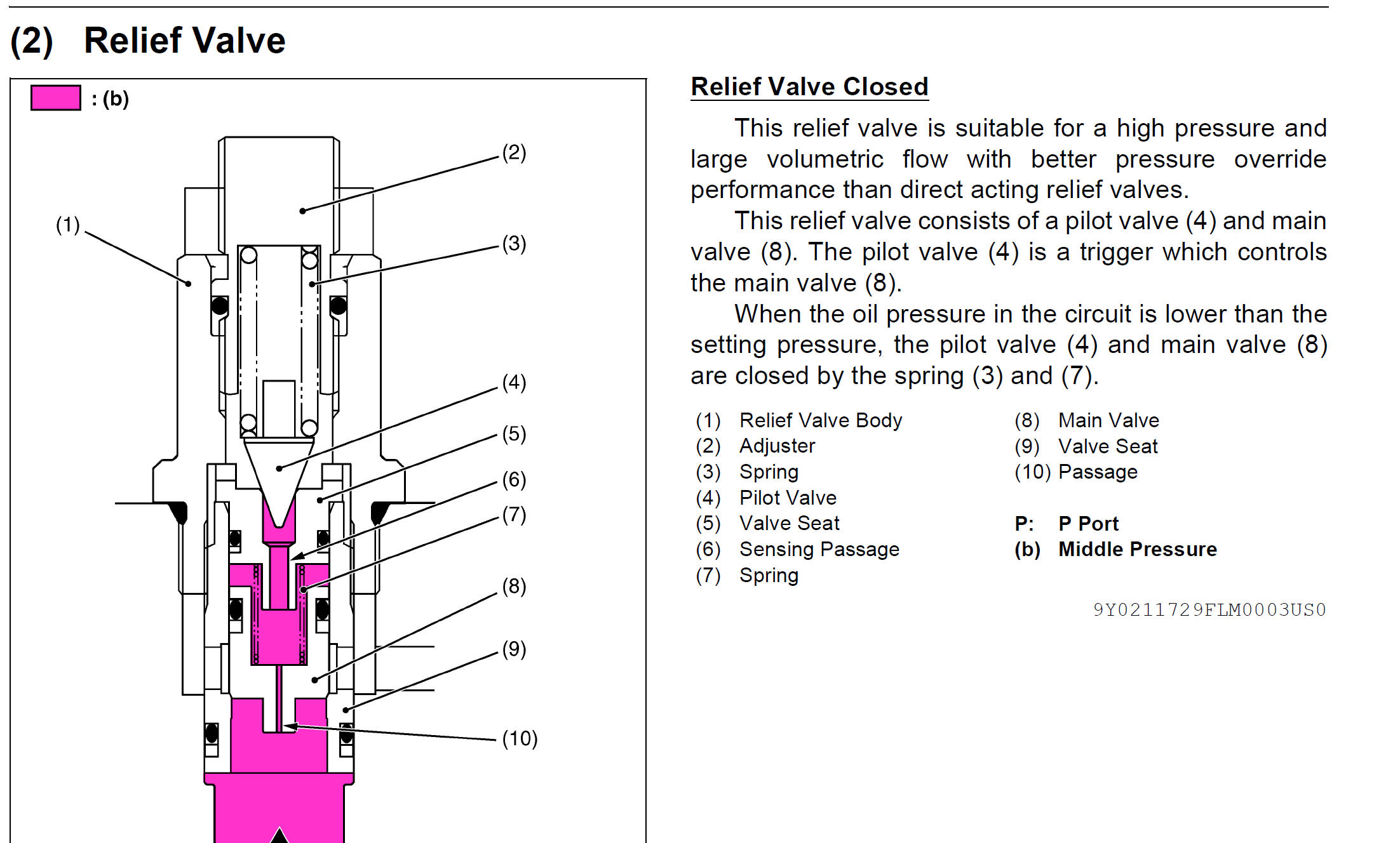

AUXVALEPSI.jpgRELIEFVALVE.jpgWhen all else READ WSM, found what I was looking for, each rear auxiliary valve has its own adjustable relief valve

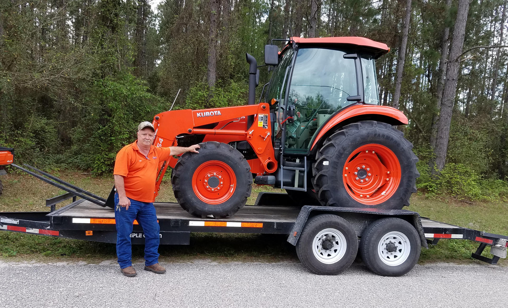

Arrived today, don't really like the seat will add spacers as others have done, shuttle shift seems to surge after engagement, like the computer is opening the throttle to quickly, anybody else had this issue.
84" bucket two week, fitrite T&T 4 weeks, EA 66" wicked grapple 6 weeks, EA toothbar after bucket gets here to measure ID"...
