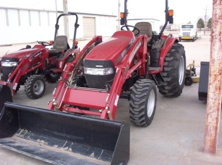

I am surprised no one had a comment about the price I paid for the tractor. Was hoping that you all thought that I got a good deal. I was told by the dealer that if I had to order the machine, it would have cost around $27,000!
Again thanks everyone!
$27,000? Well...don't let that dealer balance your checkbook.:eek: :rolleyes:
I think you got a very good deal, but you didn't "steal" it. You got about $2500 worth of options and a 2-year old tractor with full warranty. You have to consider what that tractor sold for about 2 years ago rather than the ordering price of a new DX40. I'd expect to pay about $24,000 for a new DX40 with LX116 loader. Your options would add about $2200, so you'd be at about $26,200 on a brand new tractor.
So, your dealer didn't fib, but he pushed the price up a little. You can be very comfortable that you got a very good deal, just be aware that your tractor may have condensation in bad places from sitting out in the open for two years. I'd be really attentive to the fuel tank and the hydraulic reservoir. I think I'd change the fuel filter pretty soon and check the hydraulic fluid after using the tractor to make sure it's not milky in color.
