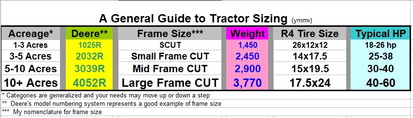

Just to get my bearings, I would go to a John Deer Dealer and test drive each of their different Frame Size Tractor series. The reason I mention John Deere is that their series numbers fall into neat categories:
  • 1xxx = Subcompact - probably a bit small for your needs (like Kubota BX series) ~ 4 foot Implements
  • 2xxx = Small Frame Compact - smallest size I would consider for your needs - easy to haul (like Kubota B Series) ~ 4 or 5 foot Implements
  • 3xxx = Medium Frame Compact - maybe the Goldilocks size (Like many Kubota L series) 5 foot Implements
  • 4xxx - Large Frame Compact - more traction, usable power, etc. (Like largest Kubota Grand L and smallest M series) 6 foot implements
Try them out, see how they "feel" and imagine them on your property. I'm guessing the small or medium frame tractors are the sweet spot for you. Don't swoon over horsepower. It is usually matched well to the tractor size, and anything from 25hp to 45 hp will work for you, a 33hp medium frame would be my choice.

AIRBISCUIT: Nice graphic.
