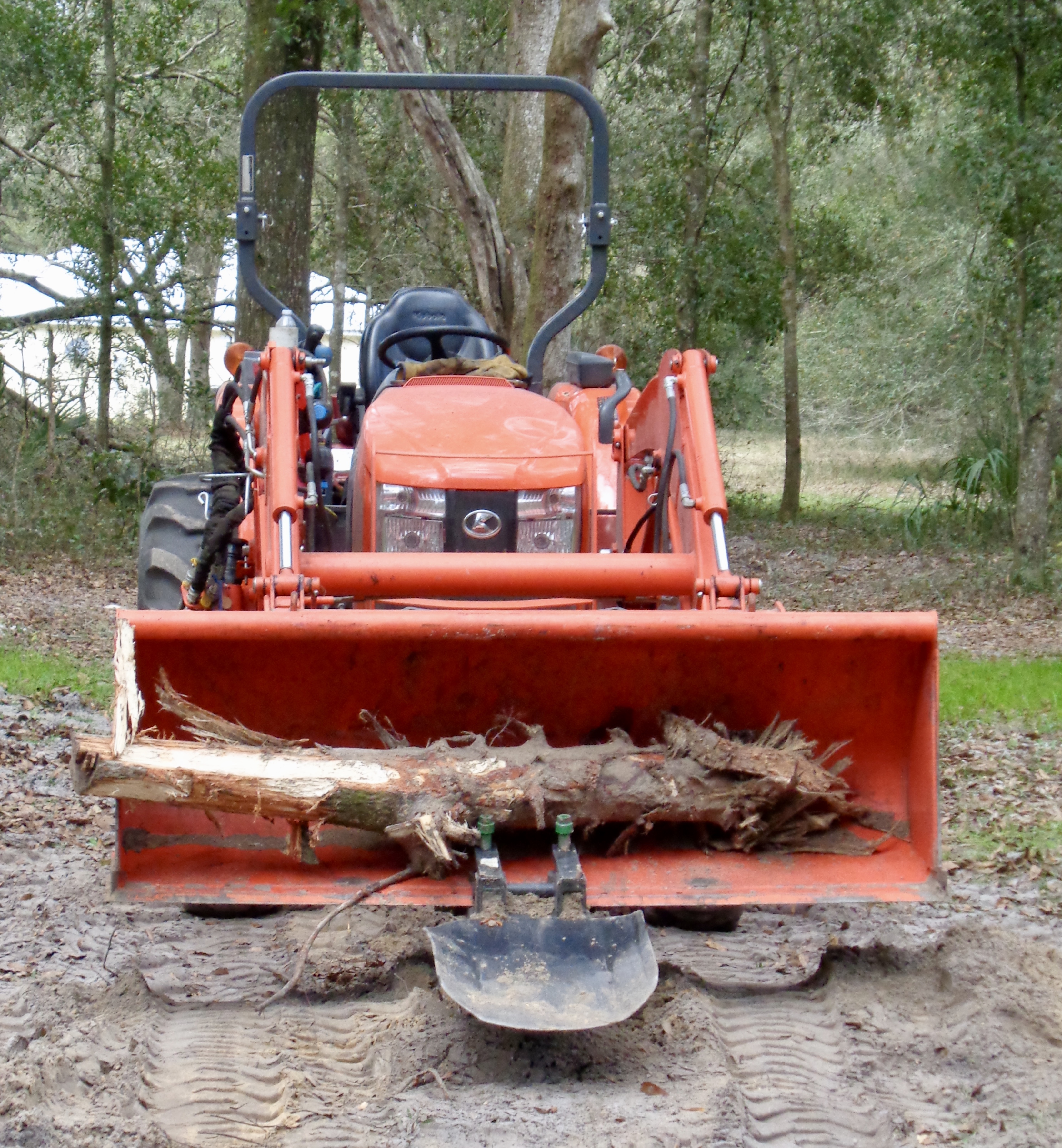

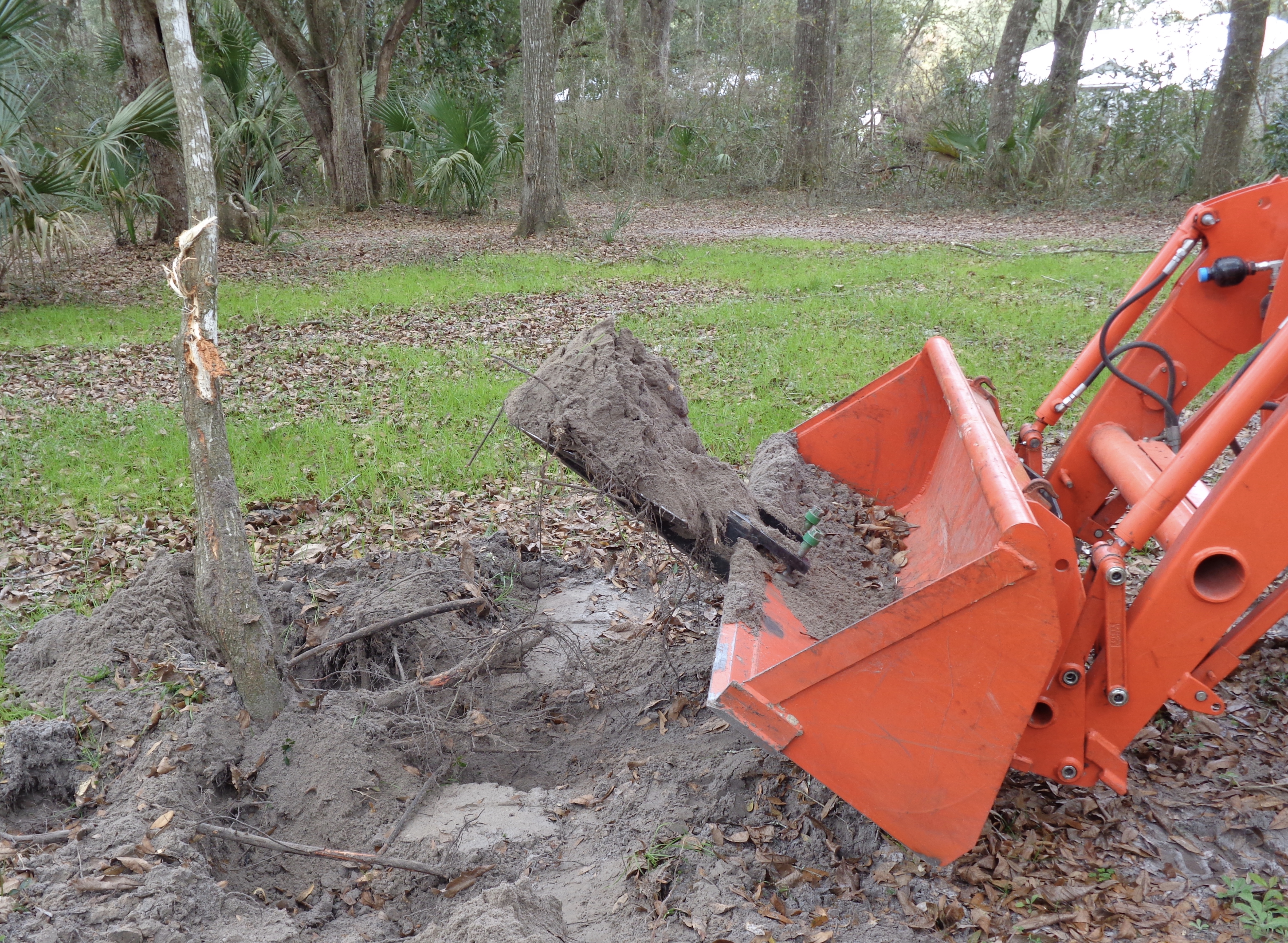

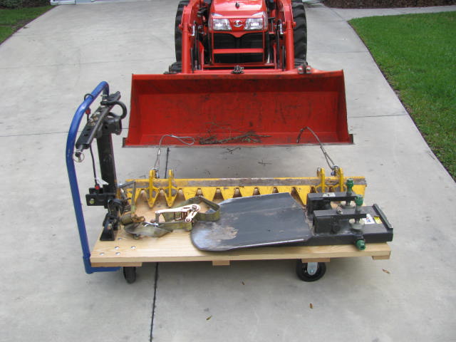

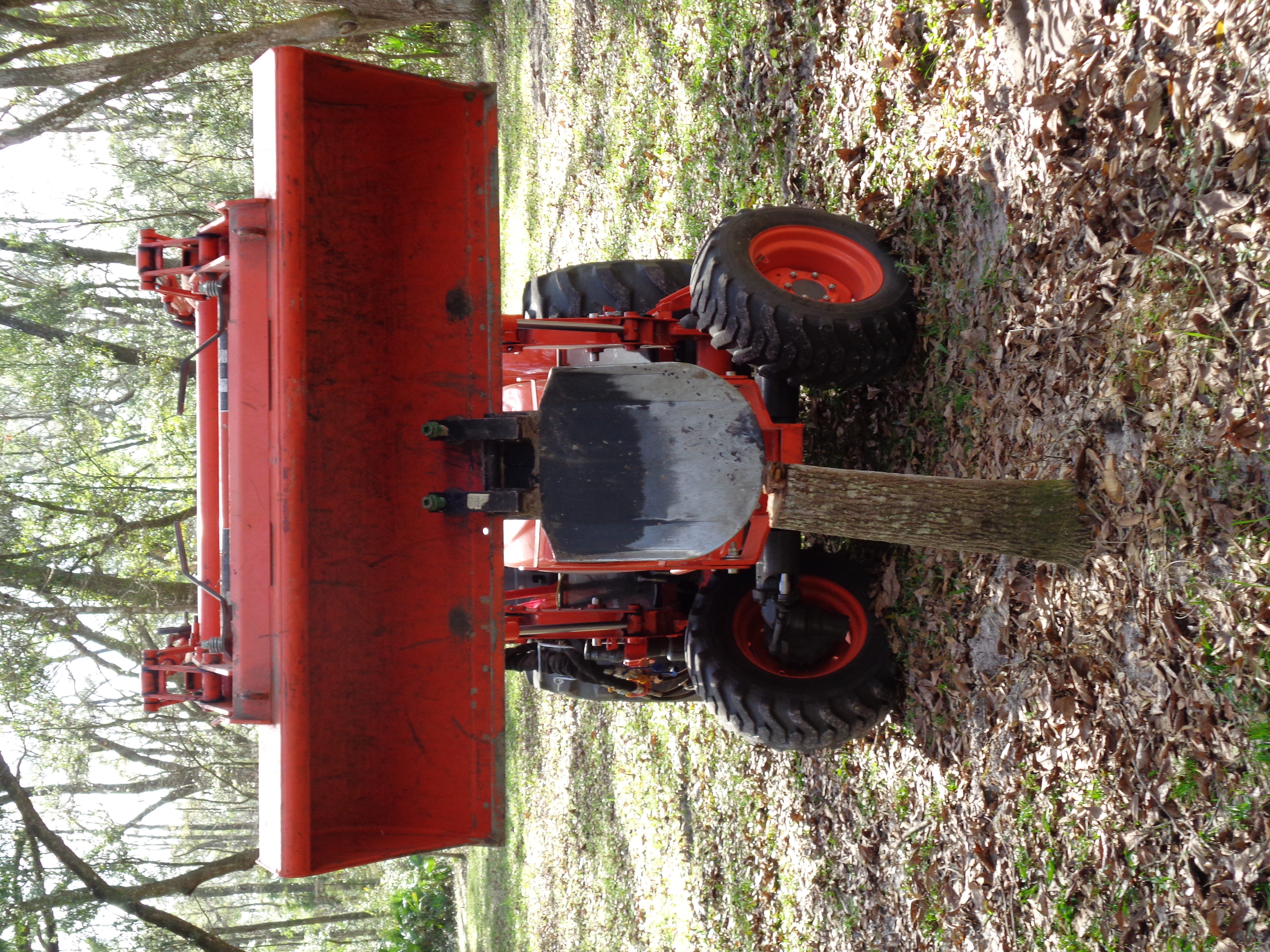

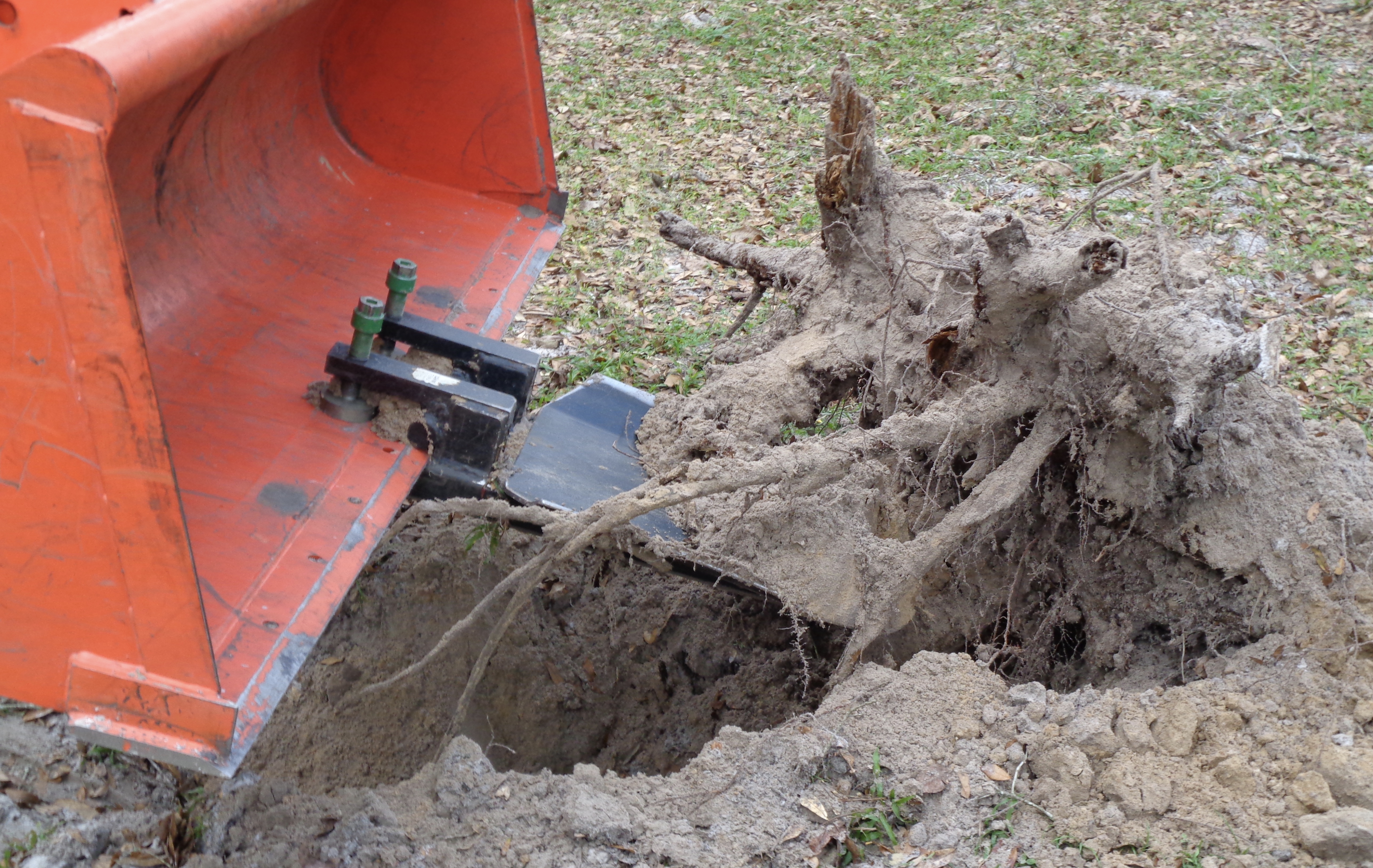

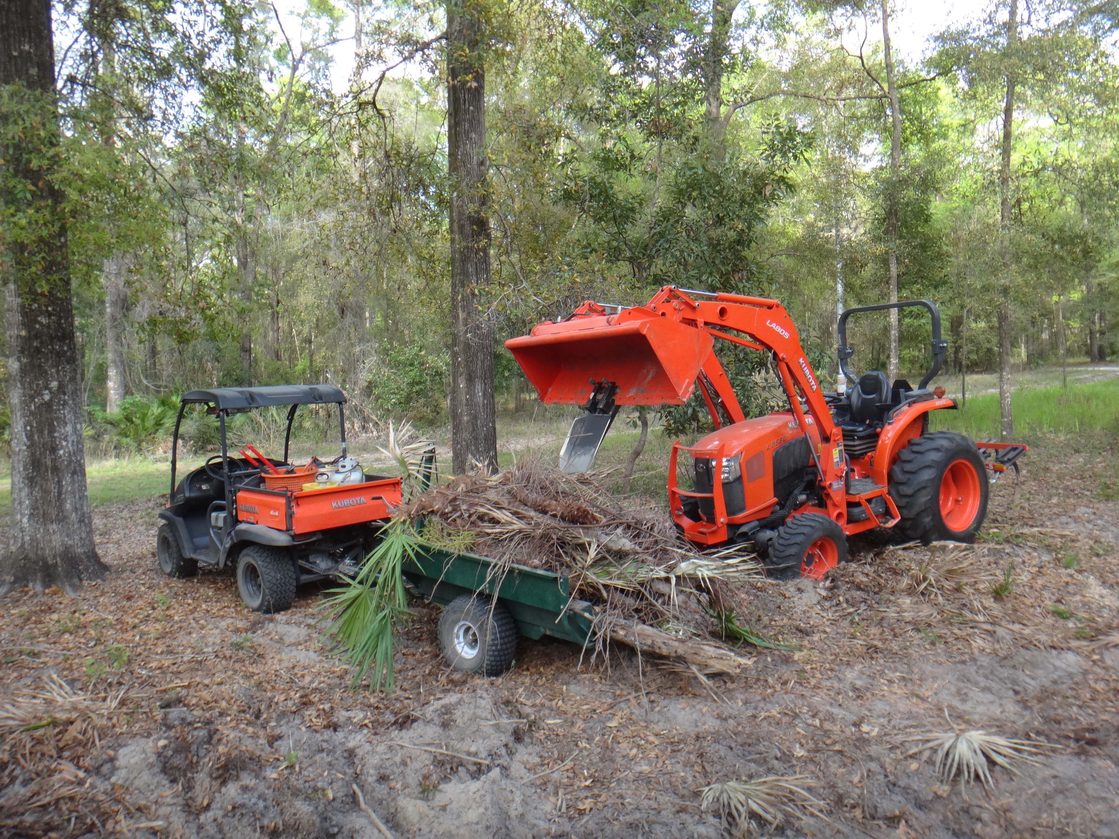

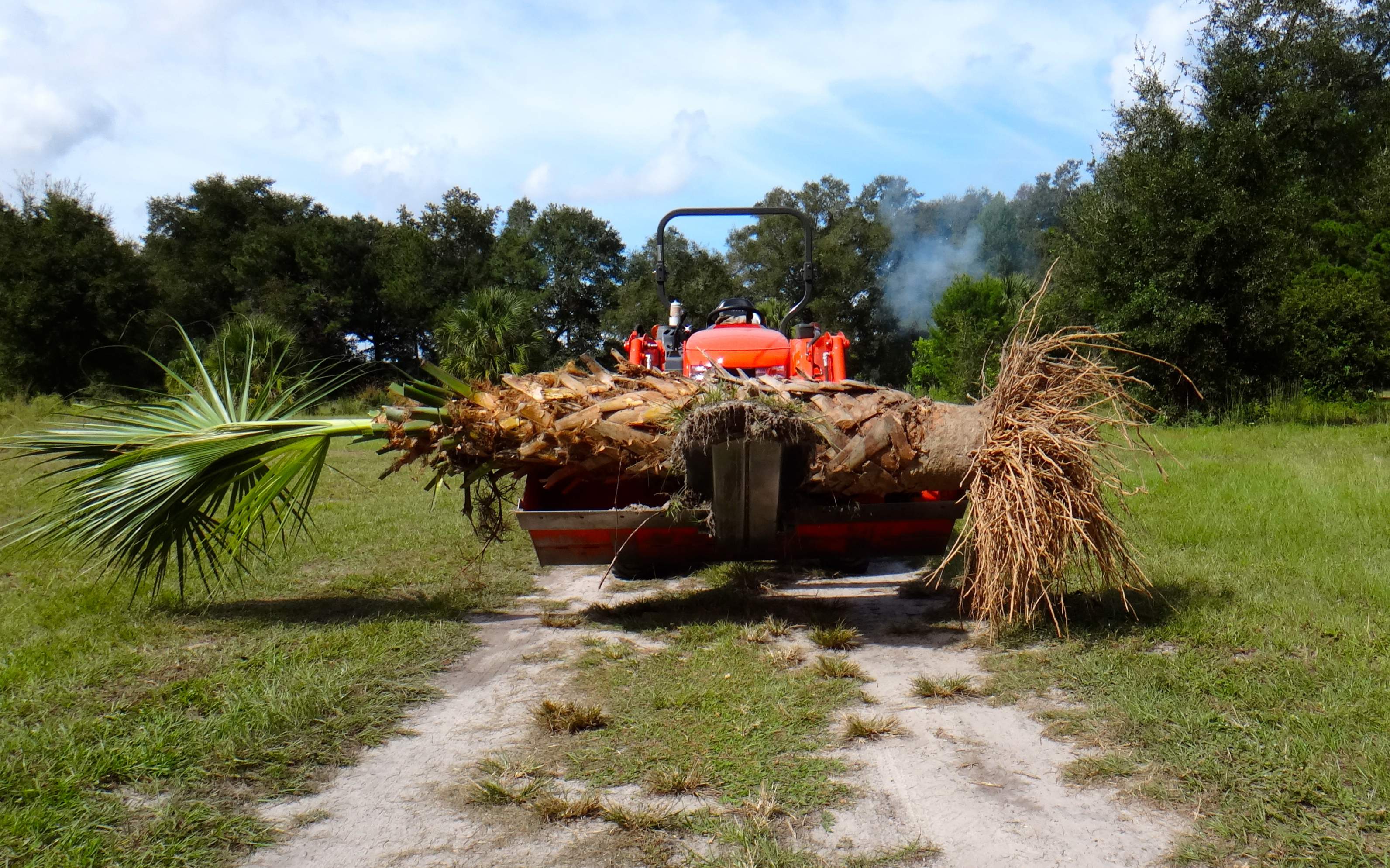

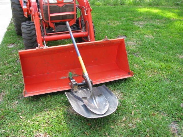

I am a bit skeptical of backhoes on light/small tractors. Will a <$400 BUCKET SPACE accomplish some or most of the tasks you foresee for a Backhoe? You would want a slightly shorter Bucket Spade than shown in my photos. Would digging to 32" depth suffice?
A Bucket Spade is NOT as capable as a Backhoe but it is a good tool and you can operate a Bucket Spade on the FEL bucket with a complementary implement on the Three Point Hitch at the same time. The tractor is mobile all the time. You can store an idled Bucket Spade in any odd corner of the garage.

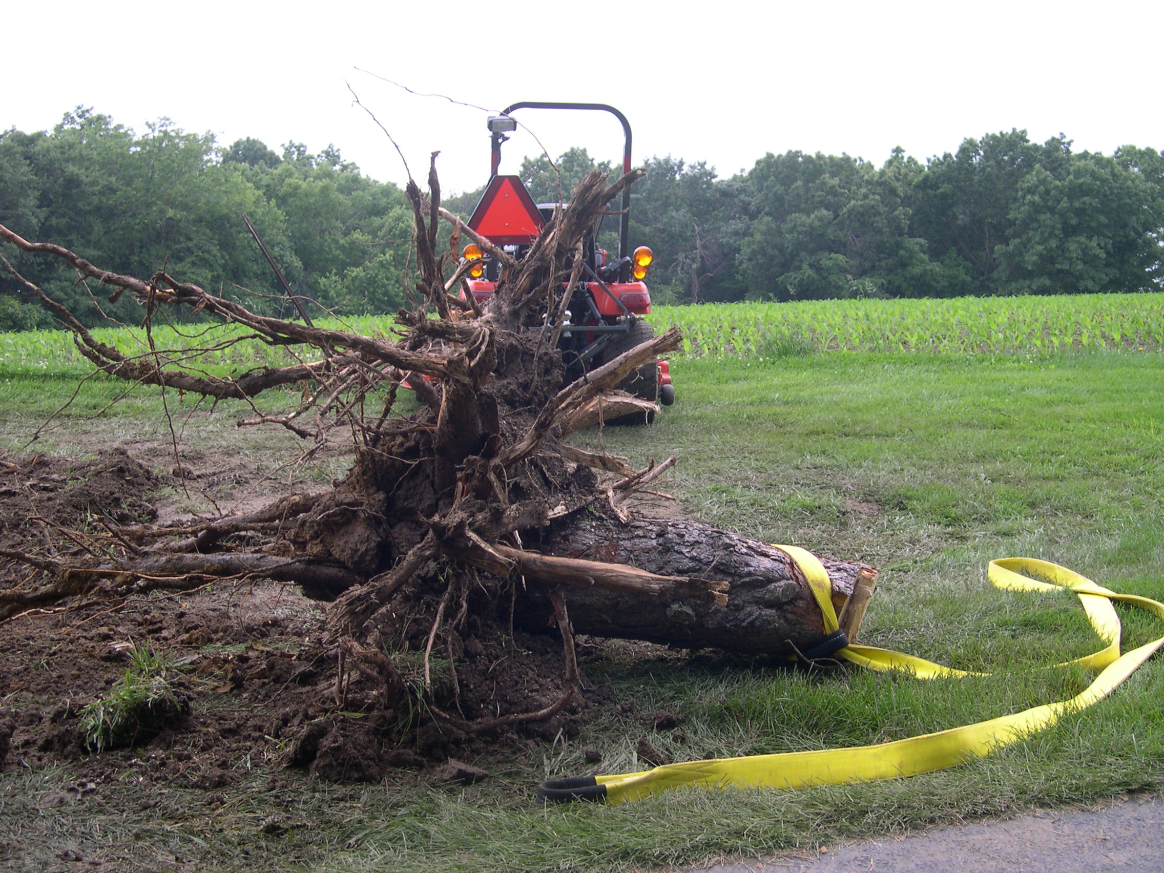

Are you planning on digging out stumps with your tractor? If so you will probably spend a lot of time doing it. You might look at a 2 series JD also, and 2025R or a 2032R. I had a Kubota BX for about 10 years and the small bucket size did frustrate me at times. Kubota and JD almost always cost more. Worth it? I think so.
I attached a pic of a stump I dug out with the end loader of my BX. Took maybe 3 hours and I had a huge hole and I had to pull it out with my pick up.
