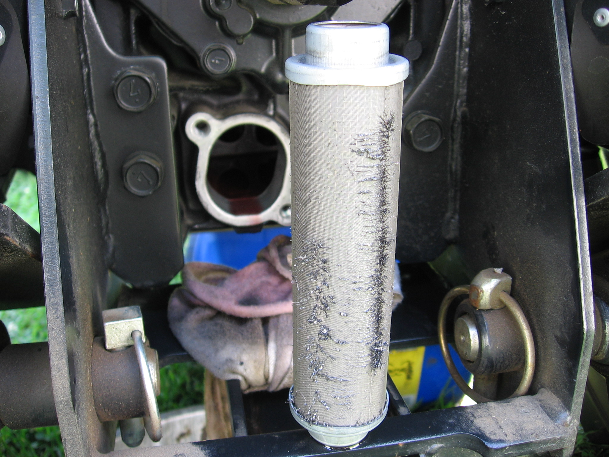

I know some do an oil change at 10 hours; how about hydraulic fluid? Based on the metal in my brother's 2320 when we changed his at 100h, I'm wondering if doing a swap out at 10 might not be a bad idea.
T,are you talking about this? This is after 48 hours and is perfectly normal.

Greg,
Can you wash that element, or did you replace it??

Thanks for all the input. Sounds like what I've been doing has been OK.
Greg- That's what I'm referring to, although his had nowhere near that much metal...
