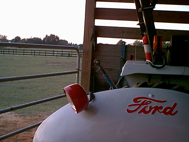

Here is my latest addition to the old 8n's limited 6v electrical system, a rear work light. Now if I just could find a blinker element for a 6v electrical system, I could add a 3way switch to make it an off / on / blinker, for road safety..

As I recall, didn't some of the Ferds have a regular automotive-type red tail lamp on one side? I think those were set on a bracket not direct to the fender? THANK GOODNESS you have that work lamp now and can go 24/7 during the busy time of year when you are workin' ground! No more late plantings for you, no sireeee!

You should be able to get a 6v flasher at NAPA. My old CJ2A still had a 6v electrical system and I was able to buy some parts for it from NAPA.

Yep.. napabarand # 268 hazerd module.... 2 prong... power in, and out the other prong to the two flasher lights ( via a 1 to 2 spade terminal adapter. ) Unit will run from 18-36 watts worth of flasher... and since my single rear work light is a 35 watt unit.. I'm in business.
