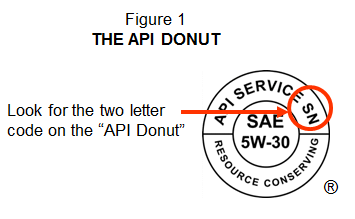

I guess that's my question - SF & SG seem to be out of date designations, so I don't know exactly what they are, and how newer designations might work. Do I really need "non-detergent"? I'm ok with using what the manual says, if I can find it. What is an acceptable alternative? ...Or call Bush hog...
   / New tow me Bush Hog 762h Back Hoe - Correct Hydro Fluid, other stuff? #4
You probably don't know what is in there now, and if the level is full, I would just go ahead and use it. Drain a little and look at it, smell it, notice the color. If it has a milky color, replace it with a newer grade of motor oil.
The code for passenger cars consists of two letters beginning with "S." The "S" is followed by a letter that advances up the alphabet from "SA" to "SB, to "SC" etc., starting in the 1920s (skipping "I' and "K"). The current specification is API "SN", introduced in October 2010 for 2011 and newer vehicles (although they can be used in older vehicles as well). The second letter in the code is critical to read before buying. This is because it indicates the vehicle model year the oil was formulated to service.
