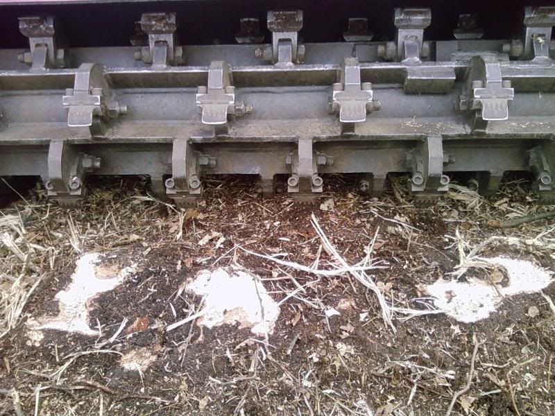

Had a look , a similar idea i see . They all seem to have the thinking caps on now . They have found it is better to slice chunks out of a tree rather than bash it with a hammer . I think there is still some room for improvement as in my mind , when a sharp tooth of that design takes a bite , centrifigal motion would keep the chip in the curl of the tooth . I would think it would still be there the next time that tooth came into contact with the tree and interfere with the next bite . They need a taper on the tooth shank to discard the chip too the side as soon as it is cut ready for the next bite .

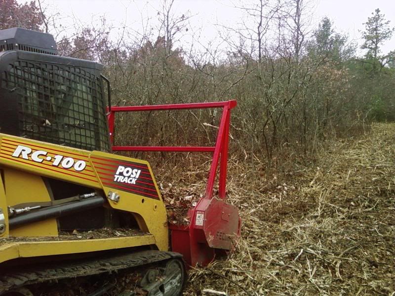

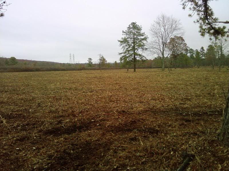

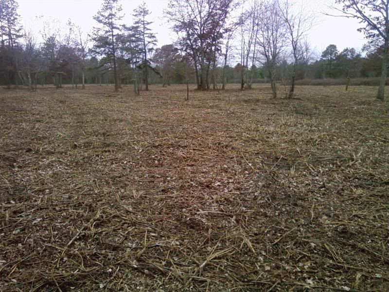

I've tried them
Can't say enough about how they cut and leave material. Within 5 minutes I was wishing I had a real cutting head (Denis Cimaf...)
The new teeth are geat in small material but really shine as the wood gets bigger. I was knocking down 16 inch pines like they were 8 inches...very impressive.
Negatives, since Fecon does not have a depth limiting system the tooth can take bite that may be too big but the biggest problem was in the smaller stuff where it would grab a few 1 inch in diameter sapling and just spin them around in the head. As in, the cutting tooth would pass the horizontal piece of wood and pick it up and suck it in. I would have to either wait 30 seconds to a minute or shut her down and back up with the head touching the ground to un roll the saplings. I am sure this would not happen with the DC heads. Also I went through a set of teeth in about 60-65 hours ($750) the first 60 hours were in rock free cutting (below) but destroyed what was left of them real quick when I got in some rocks...I will need to limit where I use them and decide if it is worth changing all the teeth back and forth as I need to.

QD , they are great pictures . Those teeth do an awsome job on light scrub , but i can see your point about the teeth being able to take too big a bite . Those tooth holders are too long without some form of depth limiting like the DC heads . Large horizontal material would wrap up or suddenly stall the rotor . How long did that area take you to do and what would the cost be to the land owner , it looks like a park land , i bet they were happy with the result .
