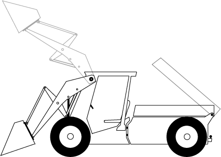

Since I have a Cold this weekend, I decided to spend a little time and spec out the tractors I intend to build when I get my new welder (/forums/images/graemlins/smile.gif yeah, right). Here are the specifications (see the attachments for drawings):
TomCat T1
Engine: Briggs and Stratton Vanguard 26.5 HP Diesel (made by Daihatsu)
Hydraulic Pump: 8 GPM
Lift Capacity: 1000 lbs to maximum dump height of 84”
Drive: Full time Hydrostatic Four Wheel Drive
Width with Bucket: 48”
Ground Speed: 8 MPH
Steering: Articulated
Bed Capacity: 1500 lbs, full dumping
Attach Mechanism: Available with Power Trac or Bobcat compatible attach mechanisms
Accessories:
- Zena Welder http://www.zena.net
- Tool Box for Bed
- Cab Enclosure
- Backhoe with 90 deg. L and 50 deg. R Boom Swing

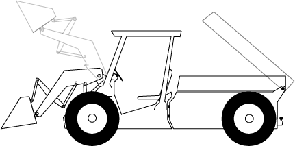

TomCat T2
TomCat T2
Engine: Kubota 56 HP Diesel
Hydraulic Pump: 16.7 GPM
Lift Capacity: 2000 lbs to maximum dump height of 121”
Ground Speed: 12 MPH
Width with Bucket: 72”
Bed Capacity: 2500 lbs, full dumping
Accessories:
- Tool Box for Bed
- Cab Enclosure with Heat and Air Conditioning
- Variable Hydraulic Flow Control to Attachments (allow use of PT-400 Attachments)

Check out a Company called Holder - they have something similar to what you are suggesting - i think they are very expensive
   / New TomCat Tractors, T1 #6
I like the design, but no dimensions. I personally would use a more powerful engine. A larger Duetz 35hp, would be great.
We could then use an auxiliary mower "wing" powered by the engine. It would also climb hills better under load. Robert /forums/images/graemlins/grin.gif /forums/images/graemlins/grin.gif /forums/images/graemlins/blush.gif
   / New TomCat Tractors, T1 #7
$3500?
I'll take one...sign me up for a pre-order! Where'd that number come from, just out of curiosity? Isn't the B&S diesel engine about $3500 itself?

Loading the dump bed?
Hey Marrt:
Just a thought here...the dump bed is a great idea, but is there any magic you can think of that would let you load the dump bed? The problem (if you could really call it a "problem", which I'm not sure you can) is that the loader is on one end, but the dump bed is on the other. Would be really nice to figure a way to load the dump bed with the loader while they're both on the same machine.
Or maybe the answer is to just buy two of them, eh?
Let me know when you've got a prototype ready!
Dave
   / New TomCat Tractors, T1 #9
Re: Loading the dump bed?
<font color="red"> is there any magic you can think of that would let you load the dump bed?</font>
Piece a cake, and Marrt no doubt already has it in his detail specs. The dump bed is a rolloff container, with a hydraulic hook to pick up & drop. You can drop it, fill it with the bucket, then pick it back up to transport and dump. Of course there will be any number of different rolloffs, as well: tanks, implement pallets, generators, compressors, big screen TVs, etc.
