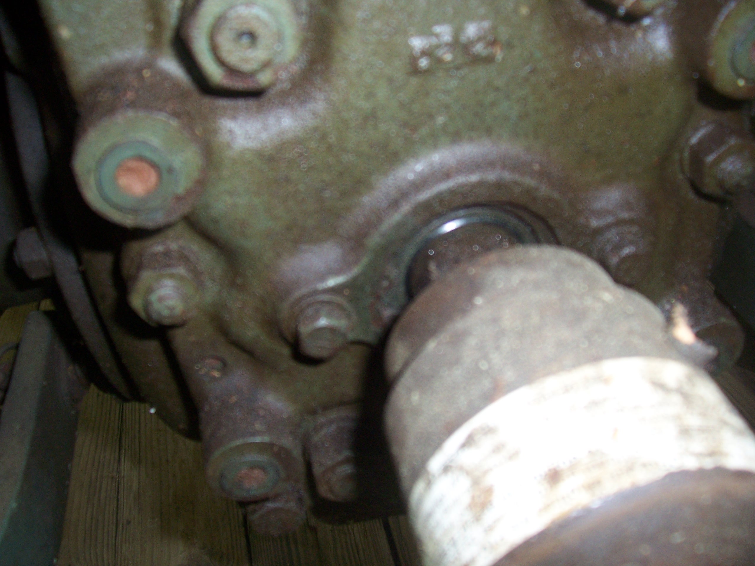

Put the pto in gear and try to spin the shaft by hand forward. If you can't then you need a PTO overun clutch. It will help alot. The intertia from the spinning mower is continuing to spin the pto and rear end. Whats happening is your having to wait until it slows down or stops before you can easily shift gears. The adapter to the shaft that will spin freely forward by the mower or by hand with it.
The Tractors pto shaft will still engage it to spin the mower. Hope that makes sence. Here is somewhat of a pic. of what to look for it has a splined shaft just like the tractor that you can't see and older clutch at that. Best I can d right now. Just search it and your find pics. of the new style and old like mine.

The Free play in the clutch or even if the clutch is new won't stop the shifting problem. The Gears are spinning or still moving. You can't stop that until the Mower or attachment stops spinning. That's why you need a Overrun clutch. With the clutch working properly as you stated without the PTO engaged I don't think I would mess with it. If it ain't broke then don't try to fix it. Plus These tractors are so old and worn Your not going to adj. the linkage to new factory standards. My YM2000 only has 1/8 free play in the pedal. Been like that for 8yrs. and 600hrs. Don't have the first issue with it for a good example. Just IMHO.
