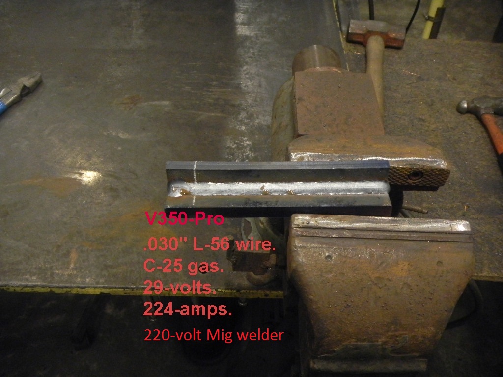

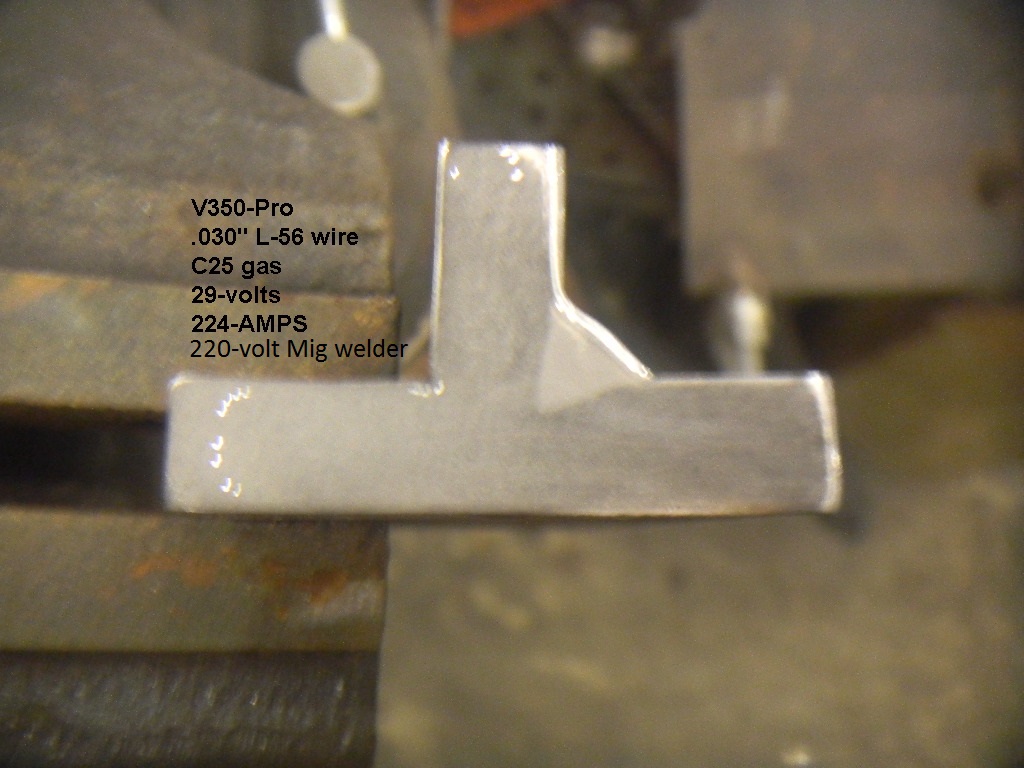

With Mig welding you want to run as hot as you can handle it. Also, if you are right handed. Hold the Mig gun in your right hand. Start on the right side, and travel to your left. That is called pushing.

By shielded wire, do you mean self shielded flux core? If yes, you do drag it. If you are right handed. Hold the Mig gun in your right hand, start on your left side, and weld towards your right. Drag it.

Check out Welding Tips and Tricks - TIG, MIG, Stick and a pantload of other info. Lots of great videos showing what a good weld looks and sounds like when it's being made. And what to do with wire feed speed, travel speed, and voltage to correct problems.
On my Lincoln, the parameters under the wire feeder door are pretty good starting points.
But in general, if the wire is balling up before it drops into the puddle, the wire feed speed is too low. WFS also controls depth of penetration, as the machine will try to pump out more current to burn off higher wire feed speeds. If you feel the wire bottoming out in the pool, it needs more voltage. Too much voltage, though, and you're back to the balling up problem. Watch the videos, then go out and run beads on scrap plates and play with the settings to see what they do. Compare how your weld puddle looks and sounds to the videos, and keep twisting the knobs until they match. But only adjust one knob at a time to observe the cause and effect...
