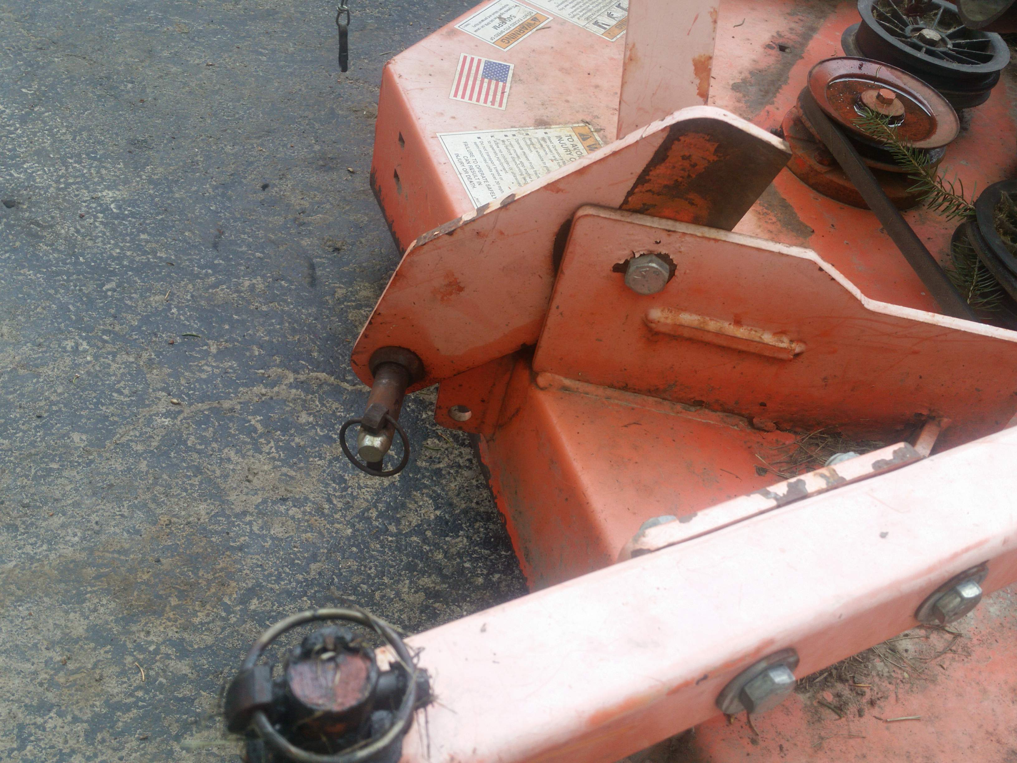

2. I've got an RD7200 mower. Currently the top and side links look like this:
The manual shows an optional quick hitch kit... Can someone break this one down for me? It's obvious they are extending the top link out but are they also taking away the floating function?

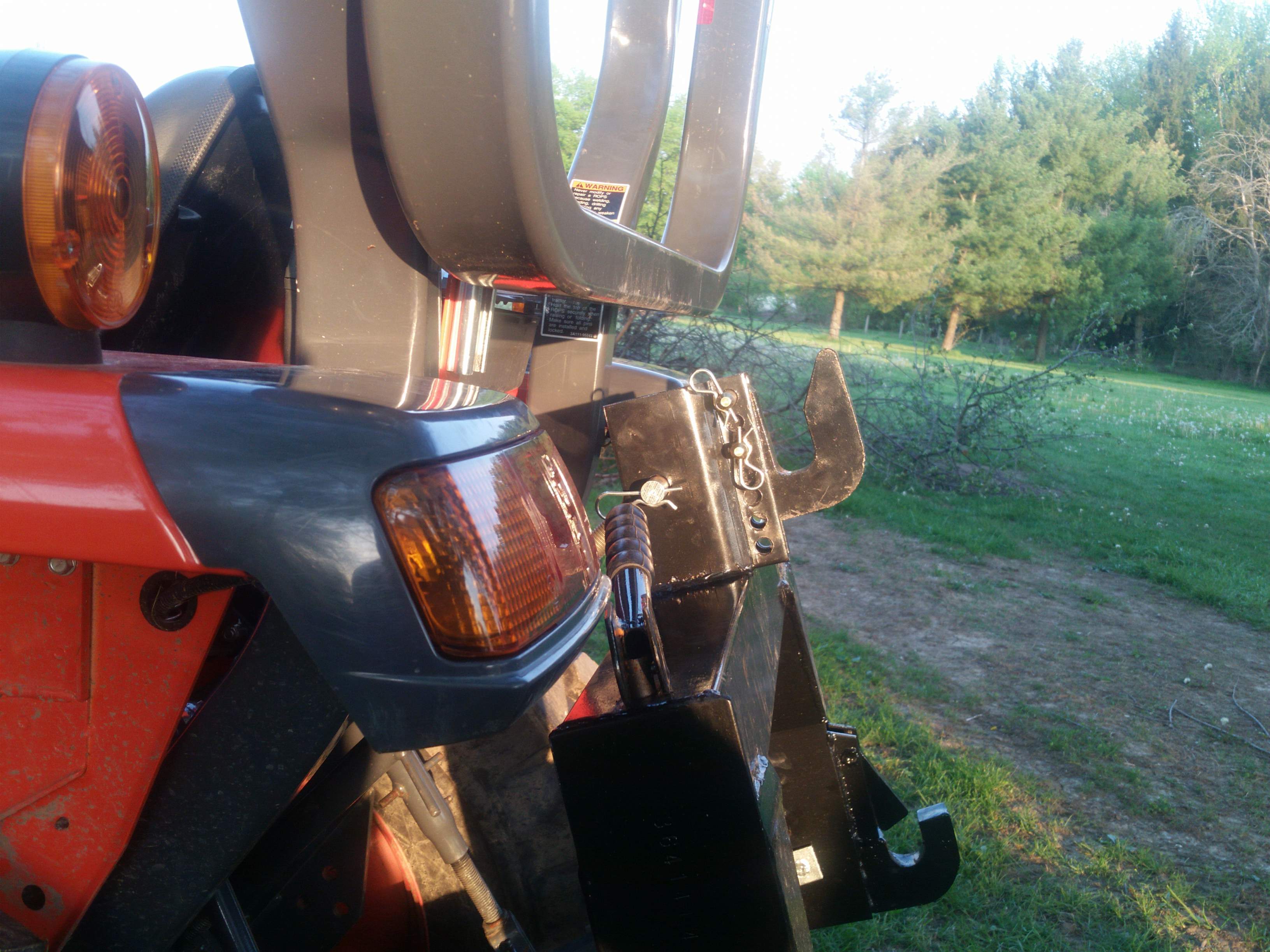

3. Does anyone else have a clearance issue with the QA when raising the 3pt? Obviously careful use and a TnT would fix the issue but I'm still thinking some trimming of the lights and grinding on the QA may be in order.

Regarding your QH......
In your picture, the top link is way too short. For the most part, the QH will be vertical through the entire range of motion. I think that'll take care of your interference.

It's my opinion (opinion only!) that you could run your mower as-is. Just hook that flexi-link on the top hook. Maybe it won't want to stay in though, I dunno.
Good catch, I forgot to comment on that. Way way too short. I wonder if it's not the stock top link, as I don't think mine would even go that short (maybe it's that I never tried).
Top link has 3 positions on the tractor, this is in the middle position. I did not adjust the top link when I dropped the mower deck and hooked up the QH... It is nearly vertical in the down position.
[/QUOTE]
I hooked to it 'as is' drug it around the yard a bit and ya... chaos ensued. Top link flips up and down and tries to jump out of the top link hook.
no reason it wouldn't be stock... tractor is practically new. just turned 60 hrs.
coming from the automotive world, I know its an unequal length setup so there is no way to get rid of the angle change... just a matter of making sure nothing makes contact.

Maybe a zip-tie to hold the top link in the hook? I dunno. Probably anything but the kit is a kludge. The kit seems to keep the "frame" a fixed distance for the QH and moves the "flex" back. It's an odd setup, but at least they have one.
For the 3-point, that's interesting. Mine does not vary nearly that much. I'd at least adjust it for vertical at mid-height (vertical at ground level isn't especially useful). Mine used to be in the middle hole too, but I read the lower hole will give you the most implement lift (and least weight capacity), so I moved mine down to the lower hole.
