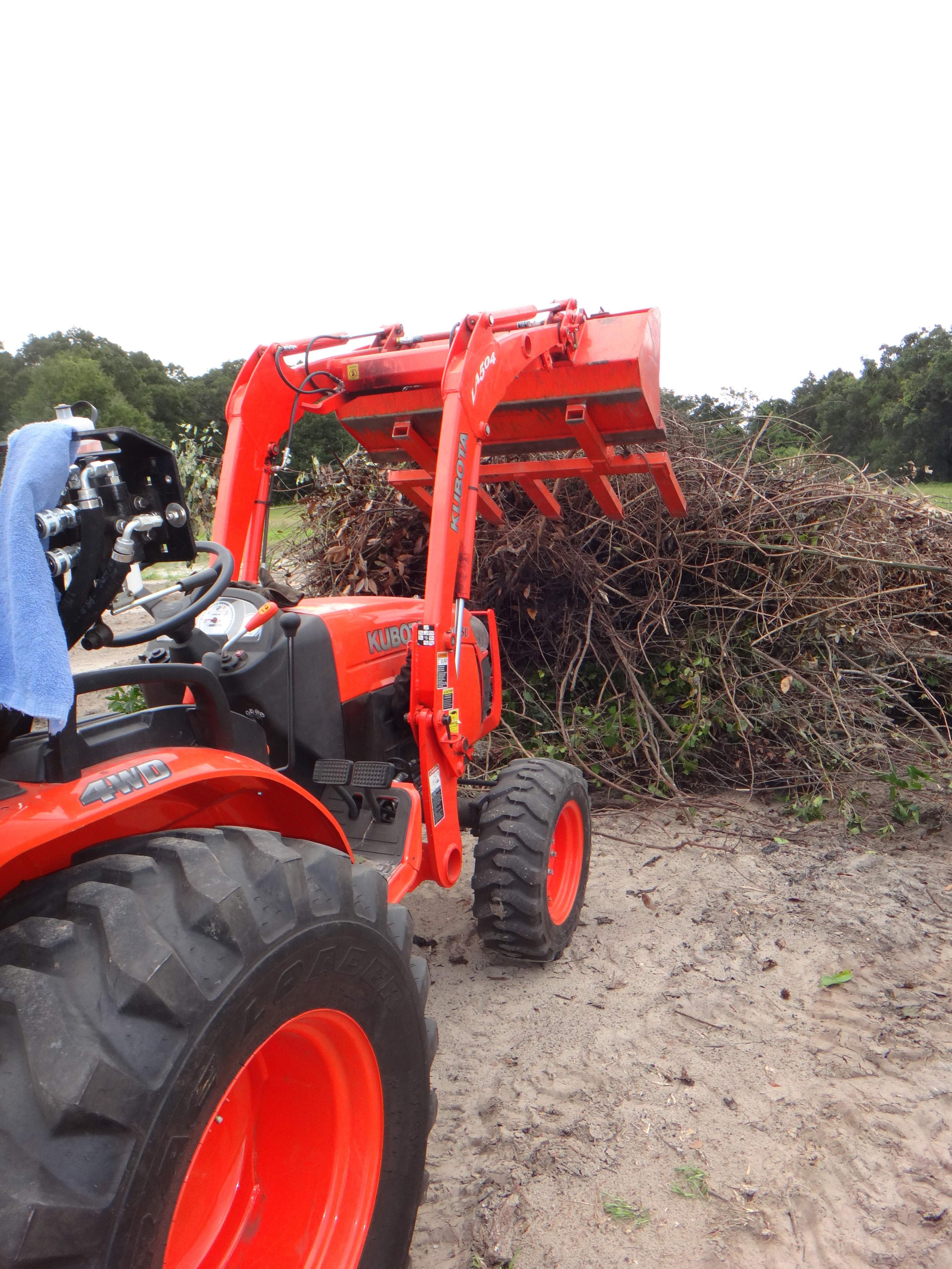

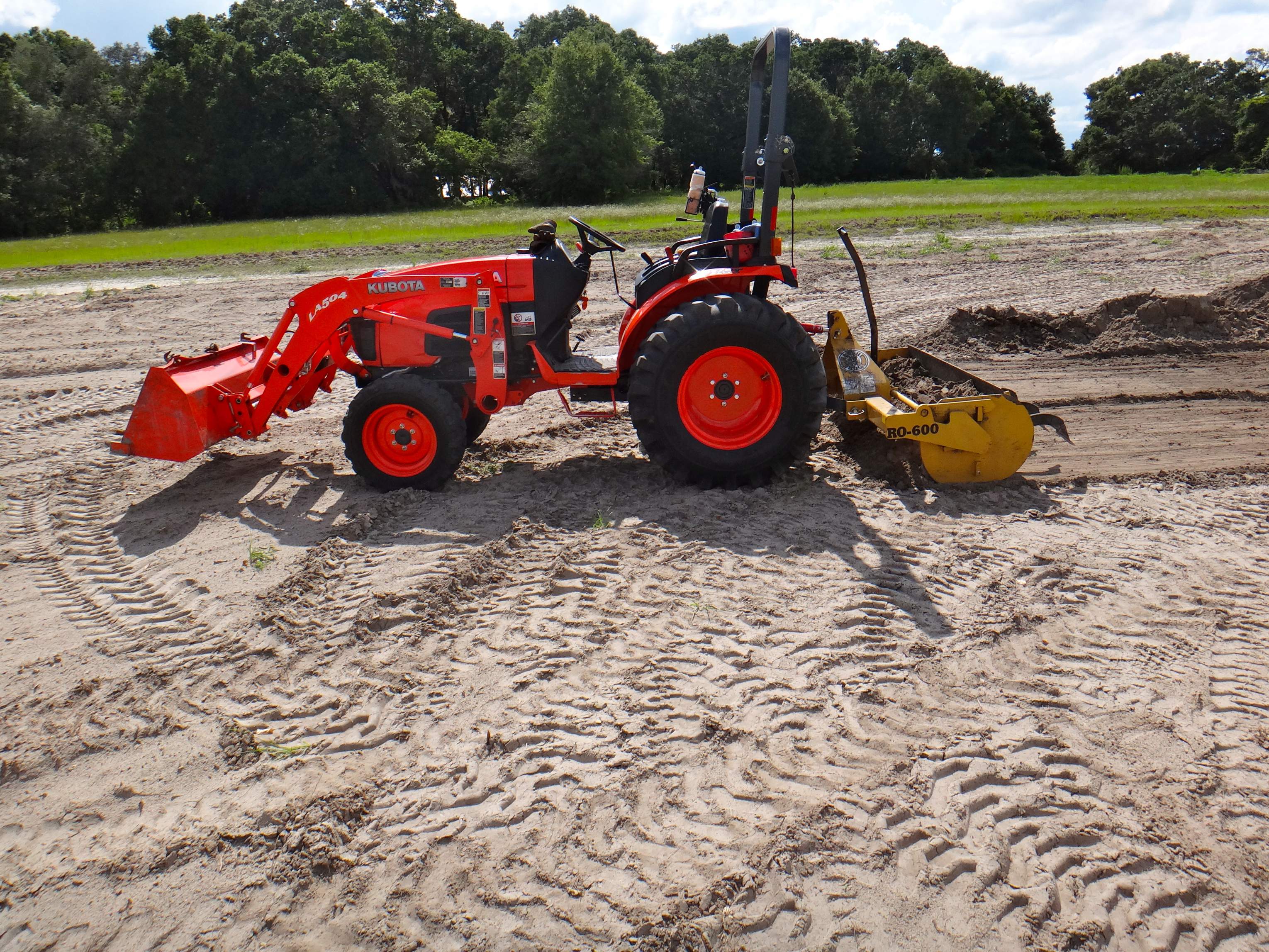

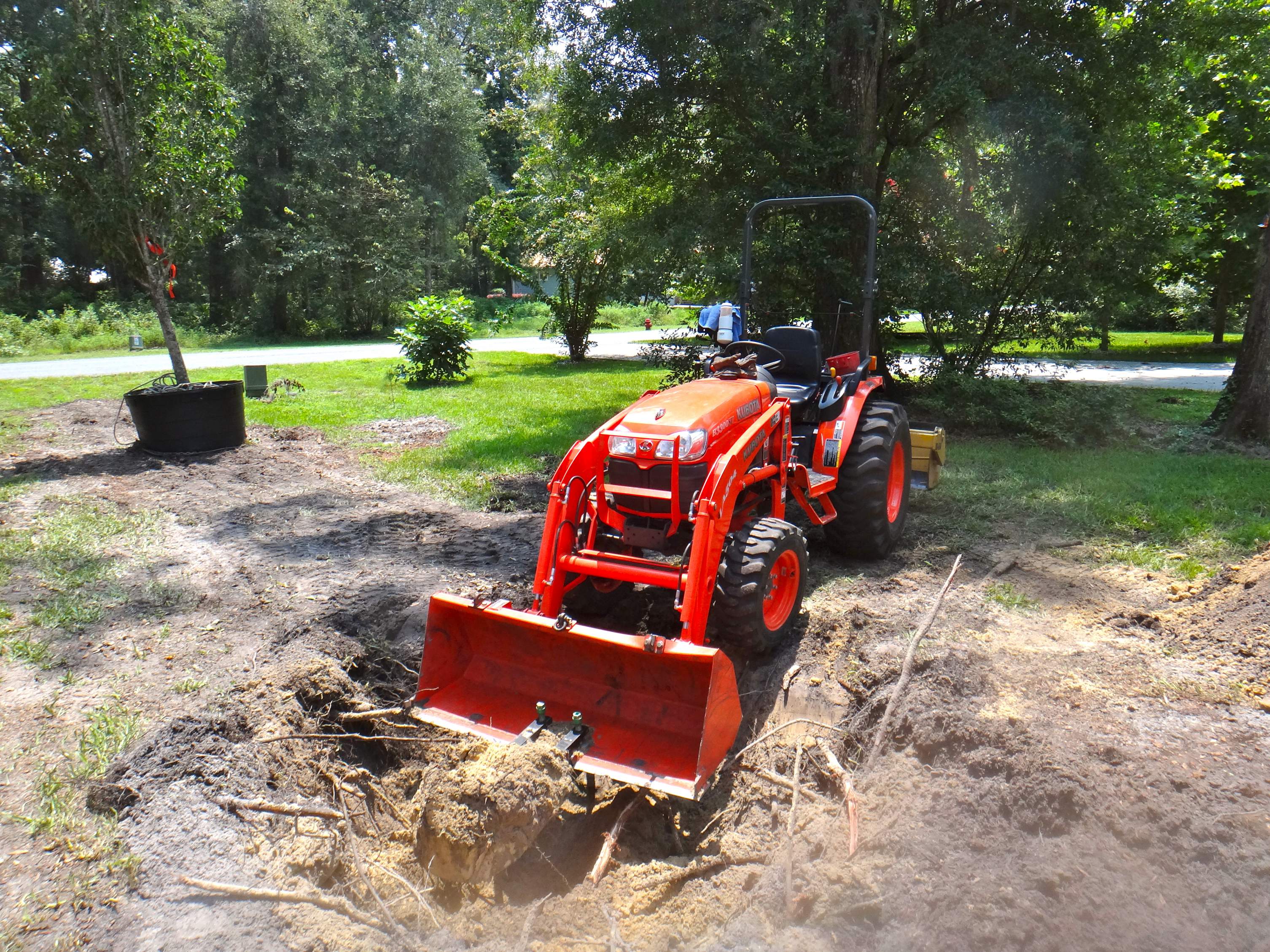

I have a little larger/heavier Kubota B3300SU tractor/loader PACKAGE. The package includes everything Kubota thinks you need: FEL, 4-WD, HST etc. If you price the package versus features as individual options you will realize it is a Good Package. About all you need to decide on is tires; R1/Ags, or R4/Industrial Tires.
With B3300SU 33-hp + 4-WD power you can pull five foot wide implements, which speeds up the work.
Mid-PTO is optional but most people operating tractors commercially prefer not to have a mid-PTO collecting junk underneath.

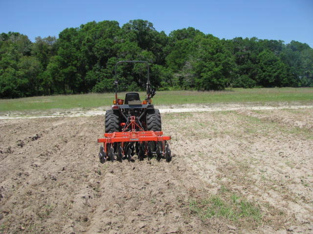

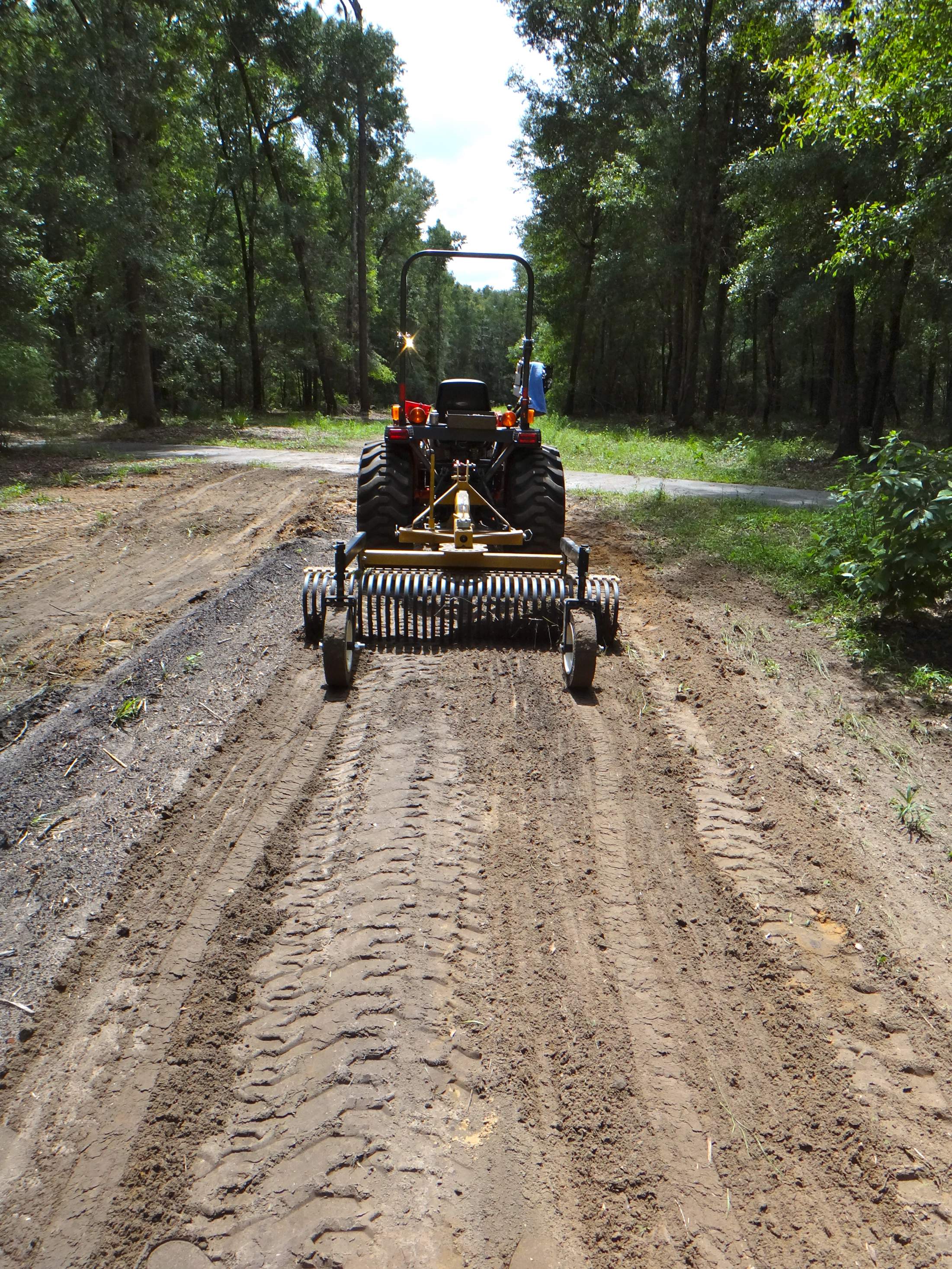

Nothing wrong with a PTO tiller. However, consider a Disc Harrow and a Cultipacker together, perhaps in place of a PTO tiller. Probably will do your seed prep faster and give you improved seed germination and less erosion. The pair probably cost less than a PTO tiller alone.
Just my kink.
In closing: There is nothing wrong with a used tractor. Just take time to find one appropriate to your tasks.

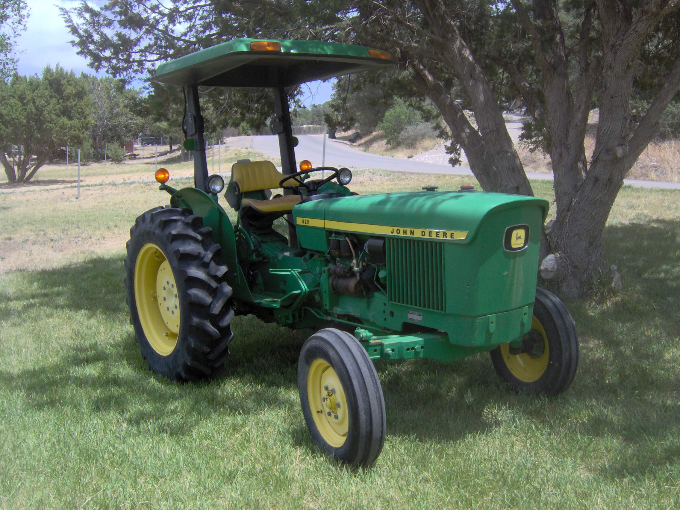

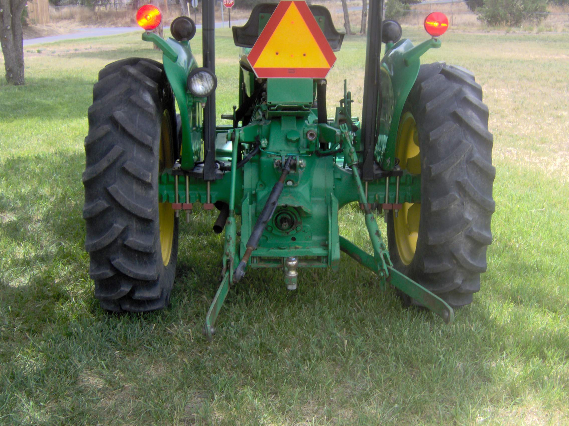

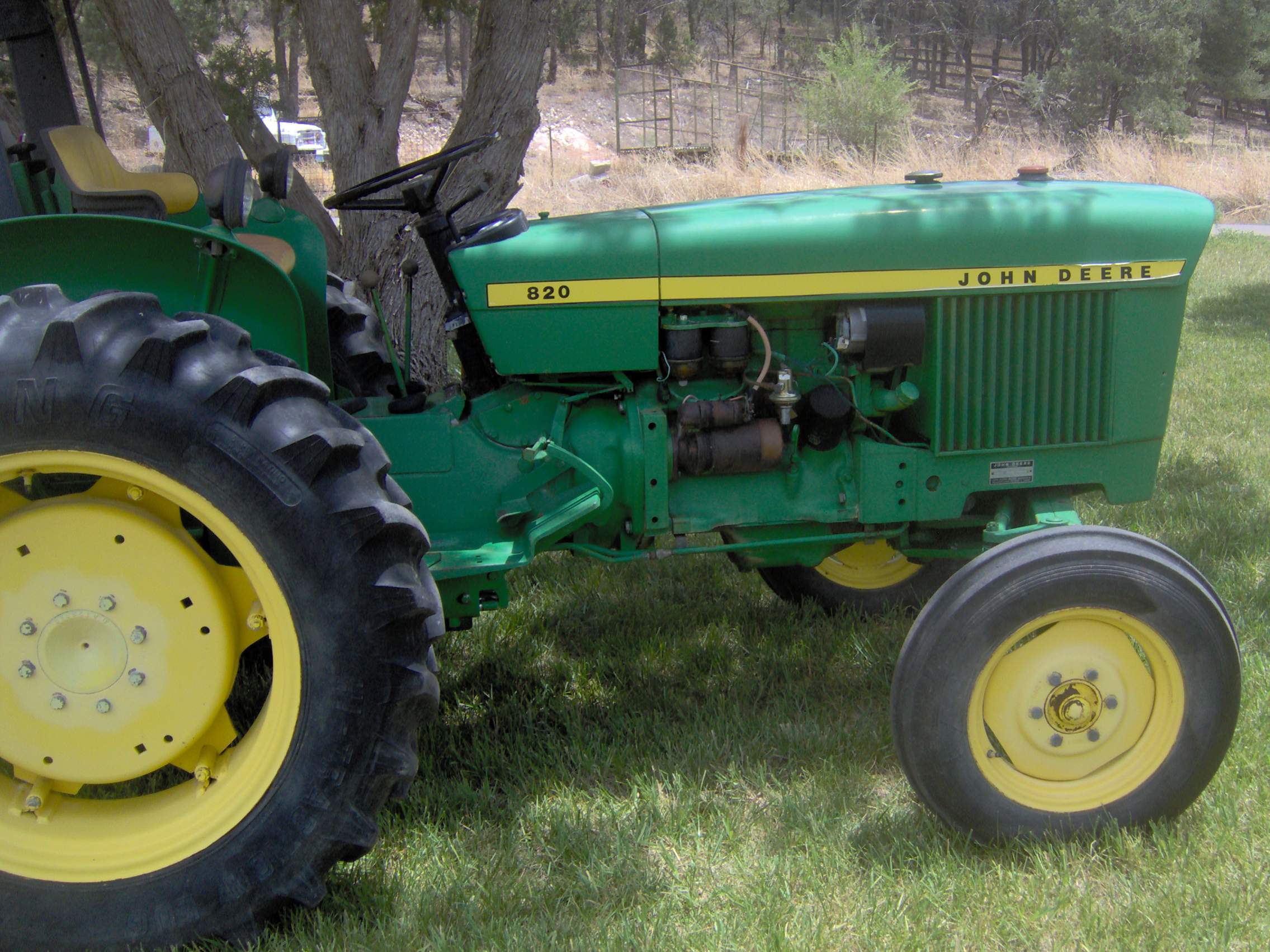

If I were gardening four acres or thereabouts I would look for a larger used tractor similar to the Deere 820 I recently sold. More ground clearance, adjustable wheel spacing, capable of handling a 5' tiller and various other implements and bedders. I sold this tractor for $5900 a month or so ago so the investment would be very low and would allow you to buy other equipment you might need. I would not buy a subcompact tractor if tilling and gardening four acres.
