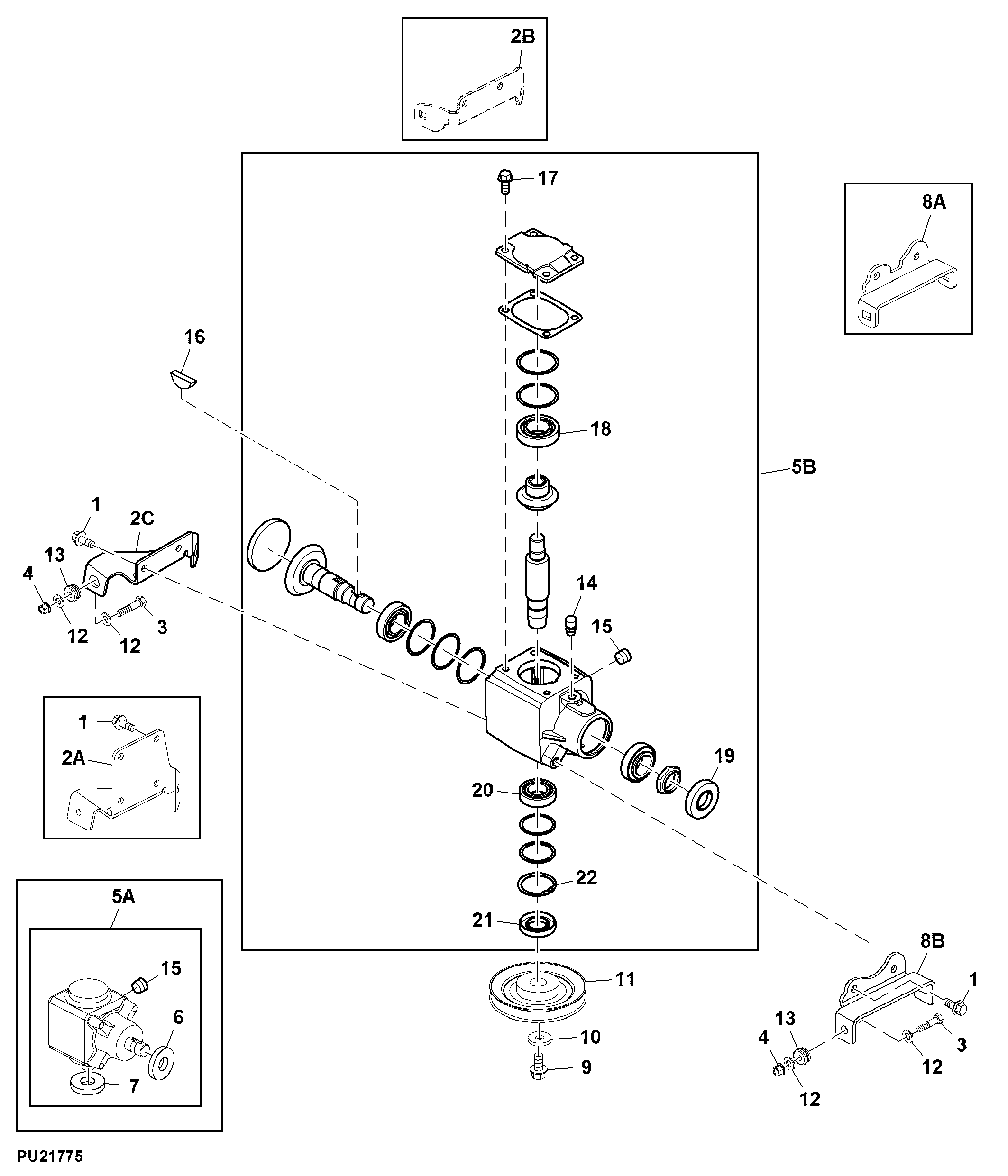

Do you have pics of the deck gearbox and where to put the fluid?
   / New to me x475 #9
In the drawing it's key 15. It's an allen socket plug. Mine was stripped (former owner??), I had to drill and use an easy out.
Easiest to remove the gear box from the deck. Remove the plug, dump the oil and refill to the bottom of the threads.
