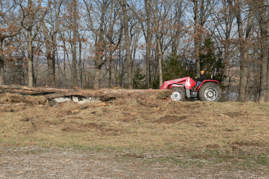

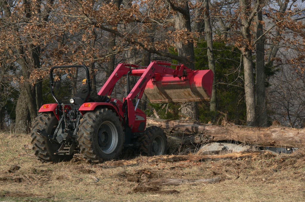

A few more pictures:
First picture is Jon ( oldest son ) doing some clean-up work.
Second picture is a tree that fell into the bean field. Jon moved it out of the field. Yes it is a BIG tree.

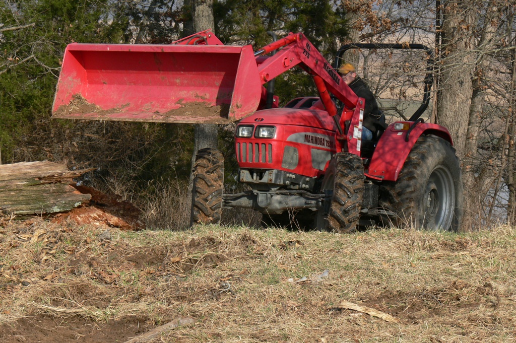

Third picture shows some minor damage to the grill the tractor already had when I bought it. I have a grill guard on order.
