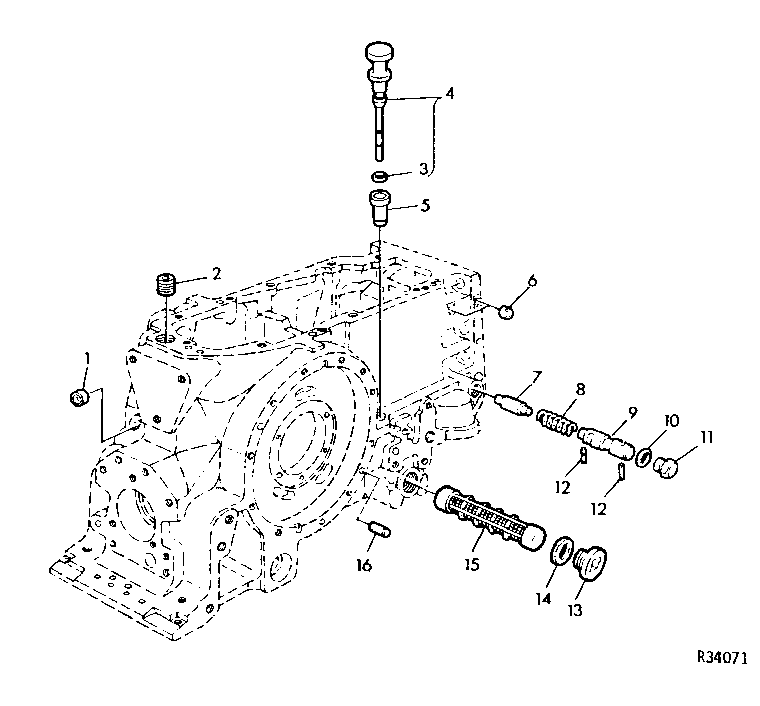

Here's the location of sump screen Z5 referred to. I'd also advise to check filter relief valve(also in parts photo) to be sure it's not stuck partually open
