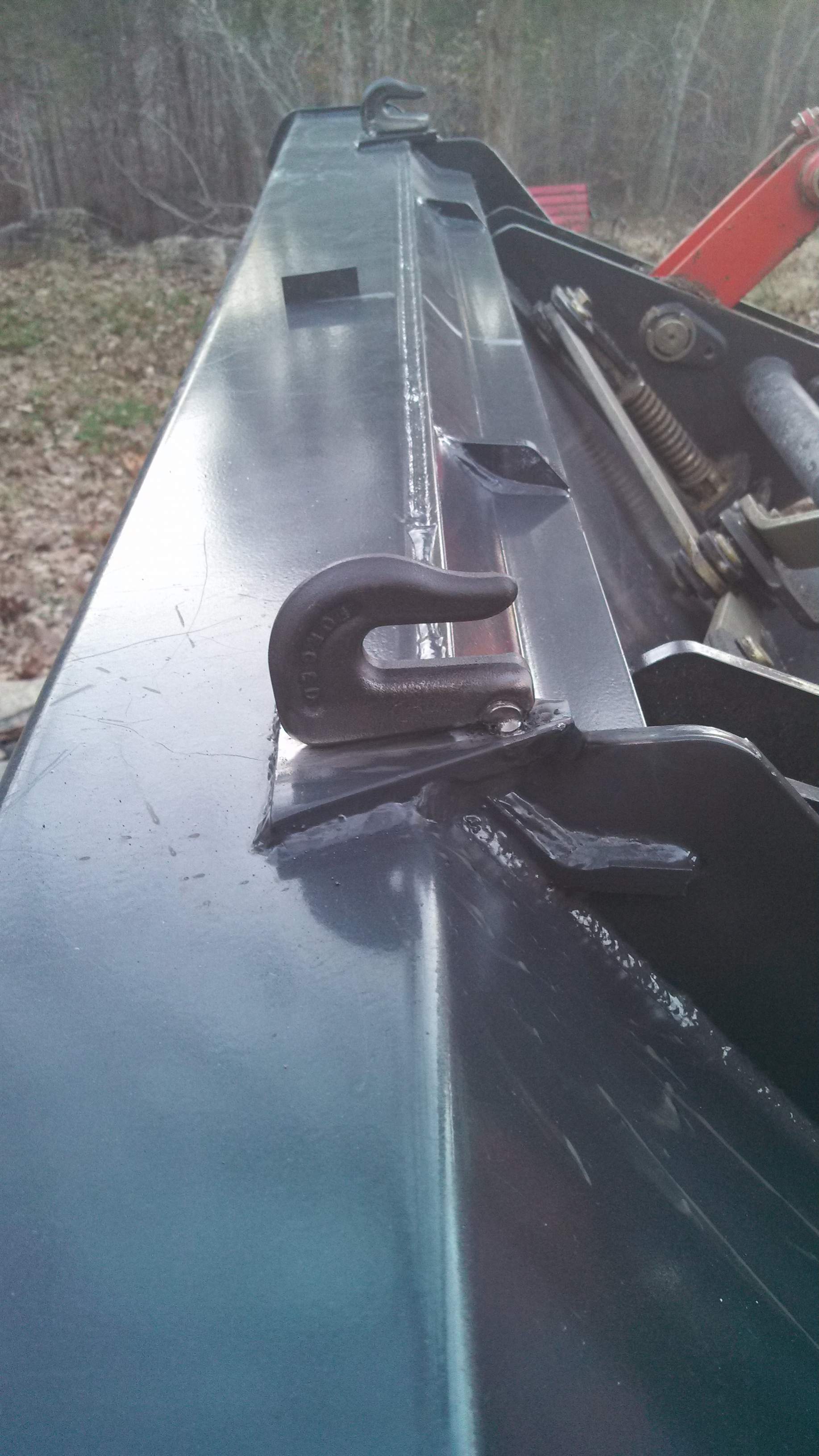

Looks great Dave. You might want to weld you two 5/16 chain hooks on to that bucket. Mighty useful for lots of activities. There are two great spots already reinforced on the bucket for this purpose. Just clean off the paint and stick them on. I used 7018 at 125 amps DC

I have a Miller MIG unit and I think that would be a great usage for it.
Now to just find one that has decent metal. Any suggestions?
I found mine at a farm supply store. 5/16 forged, made just for weld on. About $5 each.
