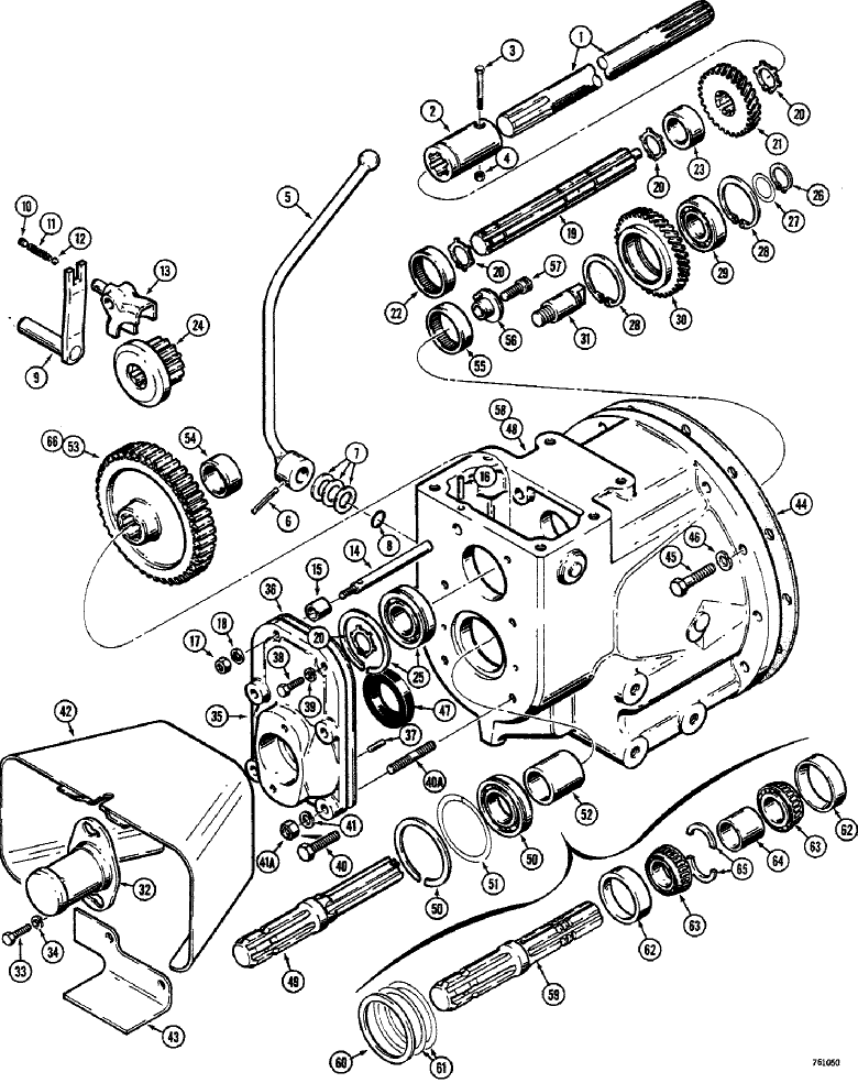

7) PTO engagement lever should be behind you and on your left if you're sitting in the seat. It sticks up from a shaft that goes into the left side of the PTO housing.
See attached diagram:

Sorry!
I forgot to attach the diagram!

Mark - thanks a ton for your help, looks like I was pretty close.
Actually, I check the parts diagram and the pull out switch I mentioned (2) appears to be for the hazards.
