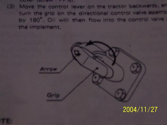

my first post of many i hope, well my problem, i have just purchased a used b7100d i guess about a 1981-85 model manual transmission 4wd, i drained all hydrollic oil from machine which dident much look like oil was a lot of water and the oil was all milky, now i am not sure which position the selector valve under the front seat should be in as there are no markings to state the position it is currently in hope this makes sense so far, now the b7100d i have had a loader and a backhoe on it i have taken the backhoe off for now, i can not get the loader to move either up or down. this machine was not operating when i purchased it, had not been run for a least 2years, put fuel in it checked oil and water, changed battery and after bleeding started with a little smoke at first but fine now, so if anyone can give me some help with the loader i would be very thankful, hope i havent rambled on too much,

Did the FEL work before removing the BH? If so I would look at your BH hydraulic connectors and see if they need to be tied together to restore hdraulic power to the FEL. Where do your hydraulics feed from? Do they take their fluid from the valve under the seat or the hydraulic block thats located about a foot behind the pump?

I have a b6100. Parts a very simialr. Seeing as how we both have gear models. I've taken some pictures of the manual because its hard to explain. Here is a picture of the selector valve in the off position. Little fuzzy but u an still see how the valve is.
   / NEW TO ME B7100D hydrollic problem #5
Here is a pic with the valve open. If u dont have any arrows on the valve then u have to try trial an erro realy because the open and closed position are 180 degrees from each other. Hope this helps

The valve under the seat will run auxillary hydraulics but will render the 3ph inoperable. Basically it diverts the pressure from the 3ph to an scv or other hydraulic device.

Loader hydraulic block on B7100. It's on the right hand side just above and a little afead of your foot.
