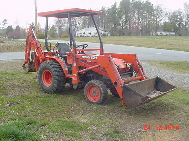

I finally made the plunge and purchased a used B21 TLB with 780 hrs for $15,000, so far I am very pleased. I have put about 4 hours on it playing with stumps and digging ditches, I have figured everything out from the labels (owner's manual is on order) and the only question is the what does the round knob directly under the seat that says open / close on it do?

Congrats on the new tractor. /forums/images/graemlins/cool.gif
The knob is probably for controlling how fast the 3PH will lower. Since you have the BH on, it will not make any changes to tractor operations.

Thanks for the quick reply, I was guessing that it had something to do with the rear hydraulics.
Any idea how many gallons of UDT hydraulic fluid I will need to do a complete change out on the B21?
   / New (to me) B21 TLB #4
Andy, congratulations on the new tractor. Mine now has 1200+ hours without a problem. From my experience loading the rear tires will add greatly to stability and traction. Also a tooth bar for the loader really helps with digging.
The hydraulic system uses 7.26 gals of fluid.

Thanks for the response, so far I have been very pleased with the B21. I wanted something a little bigger but I came across this B21 in pretty good shape, the only thing I can find wrong with it after 5 hours of use is a small drip in one of the cylinders that swings the backhoe from side to side.
A tooth bar is on my wish list along with trying to find a ~8" bucket for trenching work.
   / New (to me) B21 TLB #6
Andy, if my memory serves me right a 12” backhoe bucket is the smallest that Kubota offered on the B21. There may be some after market manufacture that makes something smaller. Keep in mind that buckets that small can have trouble dumping if you have the same kind of sticky clay we do here in Georgia. As a reference I believe the 12” bucket from Kubota was something like $400.

I was going to do some measuring and see what the width of the boom was where the bucket attaches since this will be the limiting factor on bucket size. I need to dig several hundred feet of trenches for gutter drain lines and I can do it with the 16" bucket, I will just be moving twice the amount of dirt.
   / New (to me) B21 TLB #8
The buckets for the B21 and other small <font color="orange"> Kubota </font> BH's (B4672-90 and probably BH75) are interchangeable. The smallest is a 10". As stated these bucket will not release clay very well.
