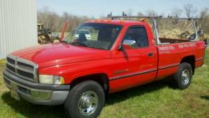

I finally bought myself a "new" work truck. I decided I wasn't going to find what I really wanted within my immediate budget, so I just got a 97 Dodge 2500 V10 2WD regular cab for $2450. In that year the 2500 was basically the 1-ton SRW so the tow rating is something silly, diamondpilot says somewhere around 13K depending on the gears. It needs a TBC and maybe a tougher hitch receiver since the label is long gone from the factory one.
It doesn't like to idle until you stomp on the gas once, and it misses a bit, so I am guessing the fuel injectors need to be cleaned or replaced. Feels like one brake caliper sticks a little also. Drives straight and shifts well though, so I think a little investment in maintenance will fix it right up. I dropped it off at my friend's shop and am hoping to start using it in a couple weeks.

Stuck Idle Air control valve or EGR valve will cause the rough idle. If it has been sitting, I would go for the air valve first.
   / new to me 97 Dodge 2500 V10
I was hoping it would not be a vacuum issue since I don't really understand how that stuff works, but I guess a new PCV would be cheaper than fuel injectors. Probably the shop guys will figure it out before I get a chance anyway. :)
