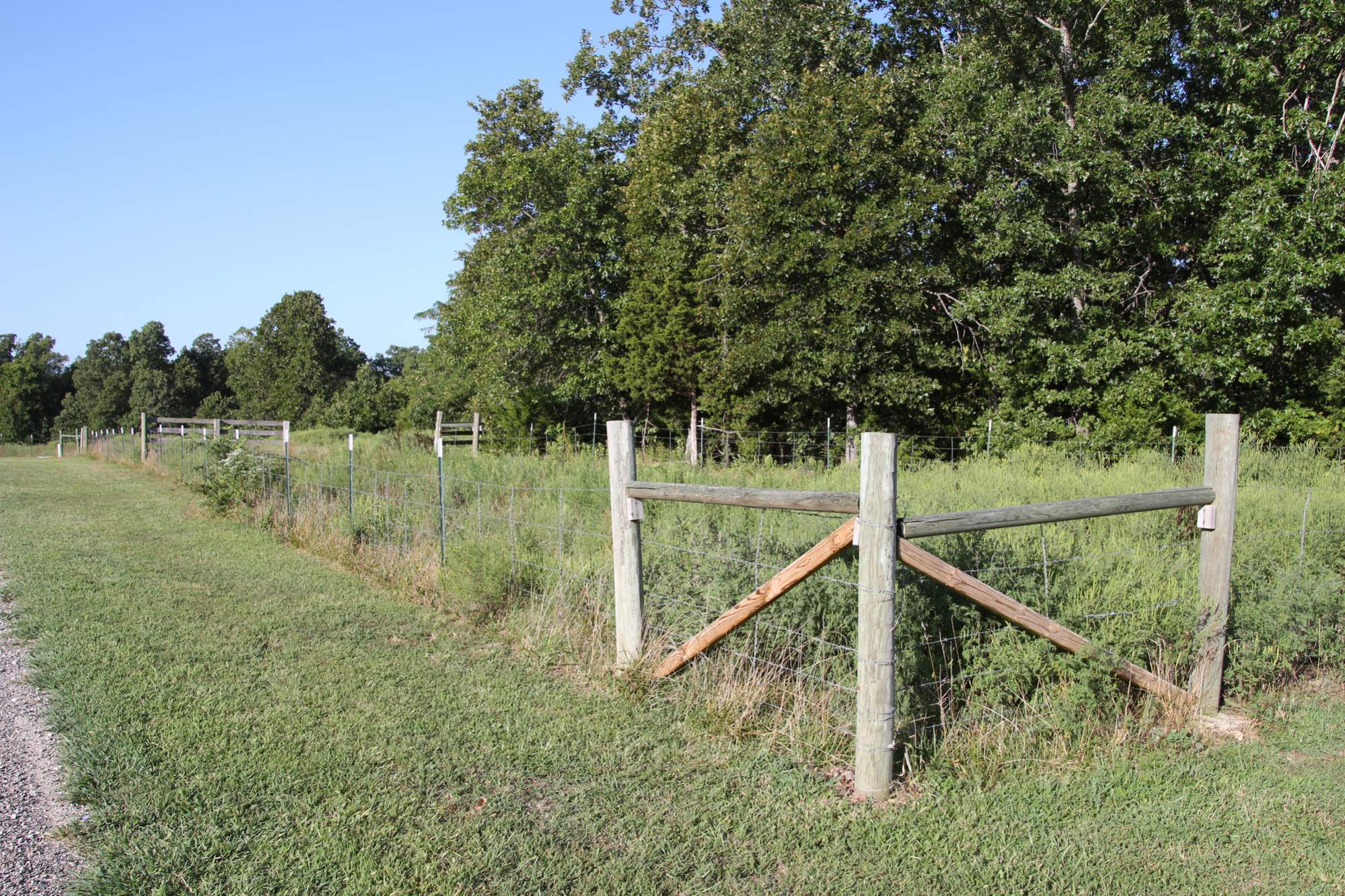

I recently purchased a Massey-Ferguson 1030 MFWD with about 3400 hours from a local seller. He bought it at a farm auction from an old man (probably the original owner) to do some loader and blade work and then got done with the job and decided to sell it as well as the Woods 165 loader and the 6 foot box blade he had attached to it. I recently moved and have about an acre of lawn/ditch and an acre of fenced-in former horse paddock that we want to turn into a garden and orchard, as well as 10 acres of woods that we'll clear off some of. An about 30 hp compact with a loader and box blade would be about perfect. This is where the tractor will work:

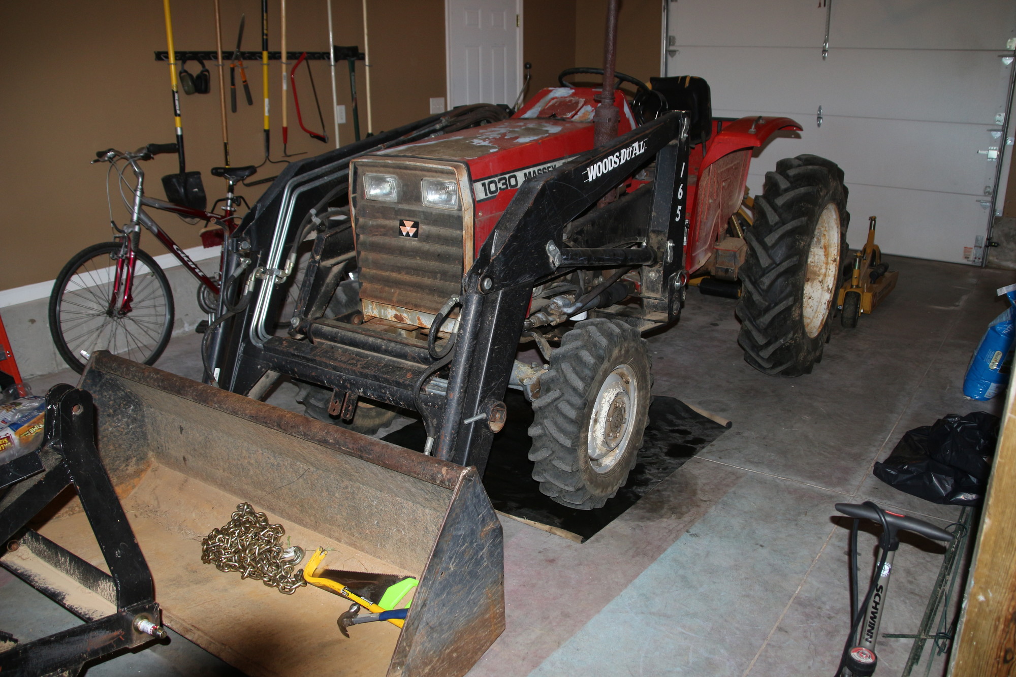

Apart from needing to get the PTO clutch worked on, the tractor runs well. I have used it to mow with the 72" rear finish mower once (discovering the PTO clutch issue) as well as pull out some old wooden fenceposts. The creeper gears in the tractor are very handy for loader work and the tractor is pretty handy. Here are some pictures I snapped inside my garage with the mower attached. The tools and chain in the bucket are from my fencepost removal.
